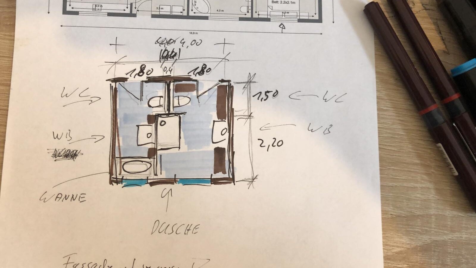

some of you may have followed the planning thread. Since we don’t want the guest toilet to be a walkthrough to the utility room, nor place an unused circulation space between the utility room and the guest toilet, we will access the utility room in the traditional way through the kitchen or net floor area.
This provides a bit more space for the bathroom layout, but it’s not entirely clear how it can be best used. We initially planned the guest toilet rather simply and minimally as an internal bathroom. Now we are considering using the space to plan the guest toilet as a separate children’s bathroom.
The rough dimensions of the children’s bathroom would be 1.70 m (5 feet 7 inches) wide—as it is currently in our apartment—and the master bathroom would be 2.20 m (7 feet 3 inches) wide (you can compare this room width to Horbach’s sample bathroom Samoa). Both rooms would be 3.70 m (12 feet 2 inches) long.
The children’s bathroom will have a space-saving bathtub installed “slightly angled,” while the master bathroom will feature only a walk-in shower.
Would this concept be feasible?

please explain to me – in what way the standard layout of the B131 is better suited here.Who says the B131 from T&C is great? Better suited? I would never build it. I never favored or used it as a reference layout. You’re the one who brought it up. Okay, to answer your question: the utility room in the 131 is easily accessible from all areas.I just want to add something regarding your initial question. Keep the two bathrooms as shown in the first overall plan of your latest post. Under no circumstances put the laundry in the guest toilet. I empty the three laundry baskets from the upper floor, for example on the floor, and then sort the laundry into the laundry tubs. I don’t know how others do it, but this is the method all my acquaintances use. You need space for this, and there will naturally be some items lying around that guests definitely don’t want to see or should not see.
The children will most likely shower in the bathtub as well. So make sure to choose a tub with a sufficiently flat standing area. There are special models designed for this purpose.

To return from the off-topic discussion to bathroom planning: Dryer and washing machine will go back into the utility room. The children's bathroom/guest WC will remain a bathroom with a bathtub. The master bathroom will have only a shower. Clear dimensions are 4 x 3.70 meters (13.1 x 12.1 feet), door approximately 86 cm (34 inches), toilet island arranged asymmetrically.
