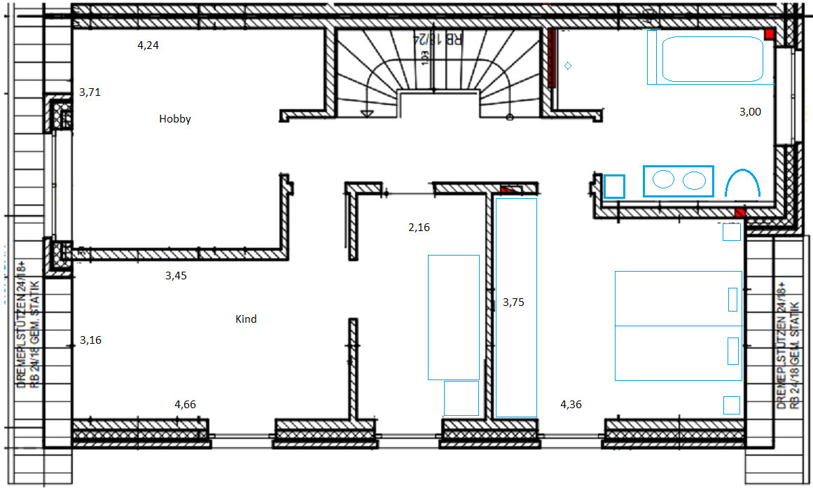

Hmm, I’ll share our floor plan with you (which was never discussed here before).
We have the same plot shape with a semi-detached house on it, same orientation – but everything is slightly bigger.
Our house dimensions are 12.25 x 7.25 meters (40.2 x 23.8 feet) – so the width is similar, but in length we have about 1.5 meters (5 feet) more. Hmm. We also converted the attic, which gives us one more room (for man stuff and guests) and a space for heating and ventilation, which frees up room downstairs in the utility area, since only the main connections are there now.
I’ve added some measurements and roughly placed some furniture...
How much headroom do you have under the roof?
Grundrissplan eines Wohnhauses: Terrasse, Küche, Wäsche/Abstell, Garage, Treppenaufgang.
Grundriss eines Hauses: Hobby- und Kinderzimmer, Wohn-/Küchenbereich, Treppe, Bad
