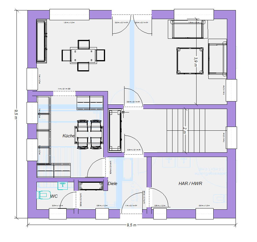

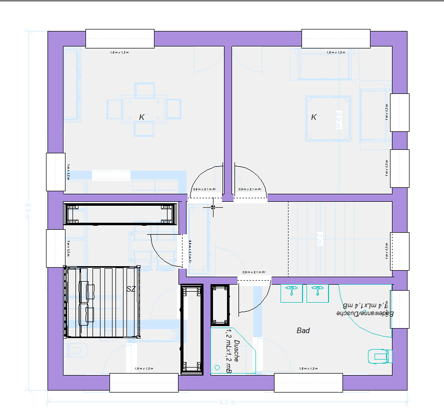

Plot size = 600 m² (6458 sq ft)
Number of floors = 2
Roof type = Gable
2 children’s bedrooms
1 office
1 walk-in closet
1 bedroom
Guest toilet and bathroom
Open-plan kitchen and living area
1 utility room
Double garage with storage area
Found on the internet
Why is the design like it is now?
Plan currently fits best
Utility room and office swapped due to door leading to garage
Dislike the large hallway on the first floor
The footprint of 9.5 x 9.5 m (31 x 31 ft) should be maintained
Layout should be as simple and cost-effective as possible
No unnecessary features
More elegant solutions with less hallway space loss?

Brr. How creepy. Your children will probably have nightmares from that long, narrow entrance hallway.
There are no dimensions given except for the 9.5 x 9.5 mentioned in the text.
Still, I’ll boldly ask where all the jackets, winter coats, shoes, and bags of a family of four are supposed to be stored when coming home? And please don’t say in the utility room, because that room is already overflowing with laundry piles and all the building services equipment.
Aside from that, it’s quite pointless to even try to improve the missing wardrobe box if that doesn't solve the problem. In my opinion, the staircase on the ground floor should be on the right side of the hallway. Whether you mirror it upstairs or the dog howls would need to be seen. But as it is now, it just gives me a headache.

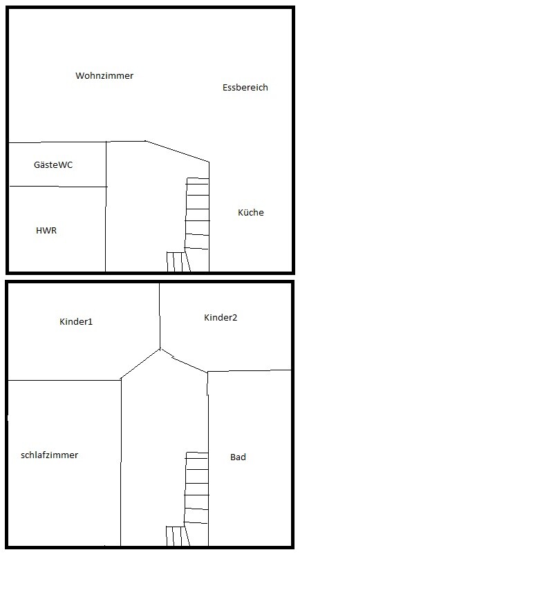

I recently saw a floor plan measuring 950x950 that I quite liked. It feels a bit old-fashioned. It looked something like this (with some artistic license on my part):
However, there is no office included, and the walk-in closet was sacrificed in favor of the children’s rooms. Ultimately, it doesn’t matter whether you call it an office or a cloakroom. You need that space, and if you don’t plan for it, your office will inevitably become that space.

vanny270526 Nov 2019 11:07Nice layout @kaho674. You could remove the wall between the kitchen and the living-dining area. I would rotate the roof by 90 degrees and extend the stairs up to the attic, creating a small office space there. The attic could be finished as a DIY project to help reduce the budget. Additional storage space could be created under the stairs on the ground floor.
