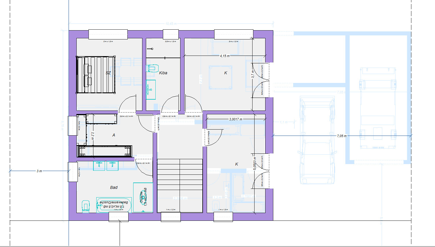

mini_g! schrieb:
There would be enough space to rotate the bed. Regarding the bedroom: You say ok...
Advantages of making the change:
- You won’t have the hot southern sun in the room, but pleasant morning sun from the east.
- When you enter, you’ll be facing the bed, not looking past it. That is the perfect view for a bedroom!
- You don’t just sleep ok, you sleep really well!
Regarding the bedroom and east instead of south-facing windows, as well as the bed arrangement, I explicitly agree again with Yvonne.

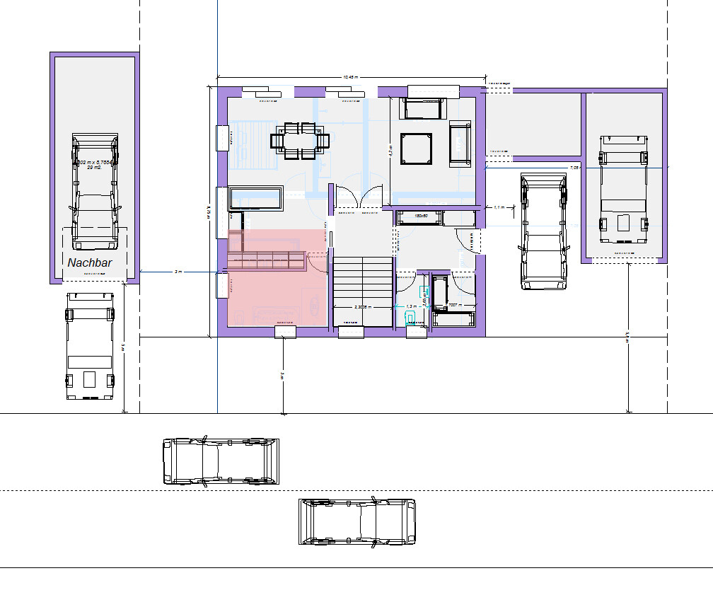

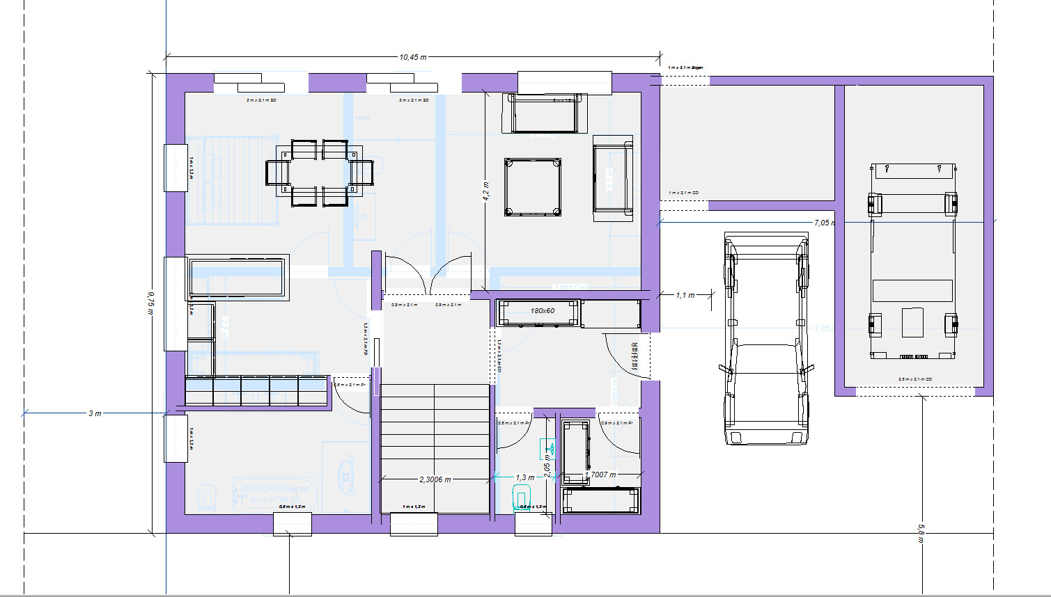

As for the living room... I prefer the L-shaped layouts over the elongated versions. This usually allows for a true retreat area within the living space. The way you planned the L-shape, the room can indeed be properly separated.
If you also want to use the utility room as a mudroom or similar, I find the utility room door as shown in the original plan very practical. It would allow for a very clever kitchen design. And as mentioned, I would definitely try to relocate the wastewater stack from the upper floor to the utility room area.
I would slightly adjust the house dimensions to 1045 x 975 to make the staircase area and the living room depth a bit more appealing. Also, when it comes to the space next to the car in front of the main entrance, every centimeter counts (in my opinion, this is a compromise I would only accept if usually just one car is parked on the property).
Regarding this house size, I am ambivalent about planning a separate bathroom for children. On one hand, it is located above the living room anyway, so the drainage system would need to be carefully planned. On the other hand, with this layout, there is no shower downstairs.
I feel that the size of the plot is overestimated in the discussion about the L-shaped living space, or that some simply lack the overall perspective. The supposedly quiet and cozy location in the rear part of the L loses much of its appeal in my view when you add an overhead view including the expected bordering development of the neighboring property. I took my sketch and highlighted the living room area in pink:
If you also consider the planned corner windows mentioned in #1, it becomes even more absurd. The garden location does not appear as attractive, does it?
I am a self-confessed kitchen enthusiast and unfortunately, I really don’t like U-shaped kitchens in this layout. Also, the utility room is harder to use as an extended kitchen, as the original poster described. I prefer true kitchen islands, which are not easily possible here.
Ultimately, it really depends on personal preferences... when and how the living space is actually used for different purposes.

hampshire24 Nov 2019 14:12I really like the L-shape. Its position facing the street has a bit of a Dutch or English lifestyle feel – this is quite common and appreciated there. The interaction with the bright basement space below creates a nice contrast.
The space next to the car in the carport becomes larger if you park so that only the driver’s side doors open towards the house.
Very well designed and apparently the result of good collaboration with the architect. I wish you as smooth and enjoyable a construction phase as we had!

@kaho674 Thanks for your effort! I think it’s good to take a step back regarding the exterior dimensions and the layout.
We still need to gather feedback today and discuss whether this is a viable solution.
And let’s not kid ourselves, this is a new development area, and in my opinion, those are hand towels, not bath towels. But unfortunately, there’s nothing else available here :-(.
Thanks! mini
