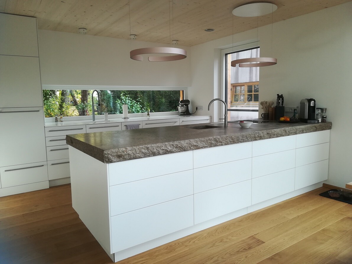

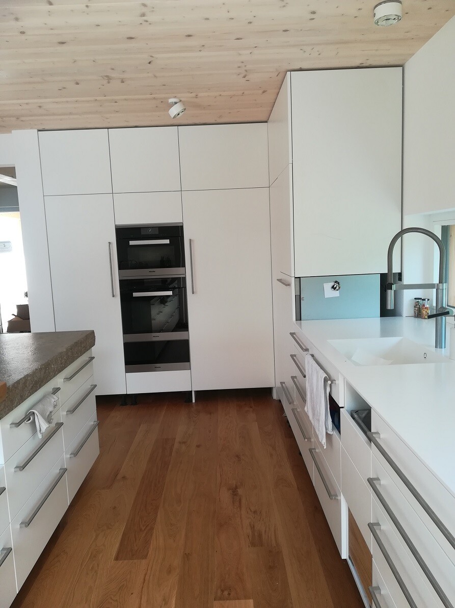

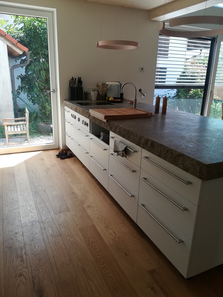

About windows again: we also struggled a lot with whether we wanted a window on the peninsula. From a lighting perspective, we would have liked that, especially since the window would have been on the left — which is ideal for right-handers to get the best light. However, it looked so awkward from the outside, having a window next to the patio door, that we decided against it. Otherwise, our windows are like this: patio door between the kitchen rows and a large sliding window next to the dining area. And experience shows: it’s still bright enough. So I would leave out the window on the peninsula. That way you get a nice space to hang, for example, a magnetic board for all important family notes, shopping lists, kids’ schedules, etc.
I’ll attach some pictures of our kitchen (which is still not completely finished) — the photos are a bit older, but you can see that despite the missing window, the island gets enough light — so you can see that a window on the island is really not necessary (and it definitely benefits the south-facing facade). Also, to get a rough idea of how wide a walkway between kitchen units of over 120cm (we estimate about 125 to 127cm (49 to 50 inches)) is.
Under NO CIRCUMSTANCES plan a sliding door between the kitchen units, but a regular patio door (if it’s more than 120 or 130 cm (47 or 51 inches), then better part fixed glass — since you’ll be standing there anyway — and a classic patio door). With a sliding door placed as shown here, you only get half the width as a passage. That would be too narrow for me. We have a patio door with 120cm (47 inches) and I can easily get through it even while carrying a wide tray.
