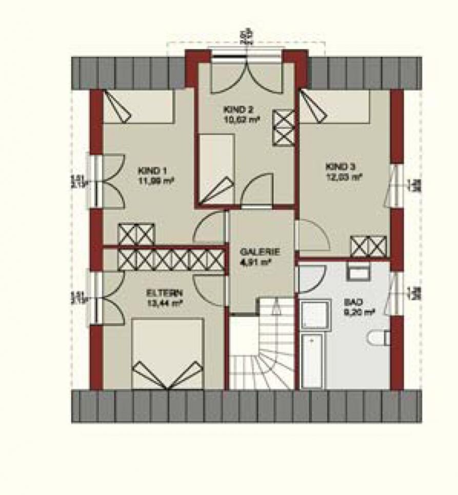

Finally, one important question remains for me. If possible, we want to plan for four bedrooms on the upper floor. So five rooms total in the house. Would this be realistically possible with the house size (130 m² according to DIN 277) and the trapezoidal dormer?
It is possible; somehow. I have attached an upper floor plan with 4 rooms for you. However, 130 m² remains 130 m² and the individual children’s rooms will be small — around 10, 11, and 12 m² (110, 120, and 130 sq ft).
Floor plan of an upper floor with three children’s rooms, gallery, and bathroom

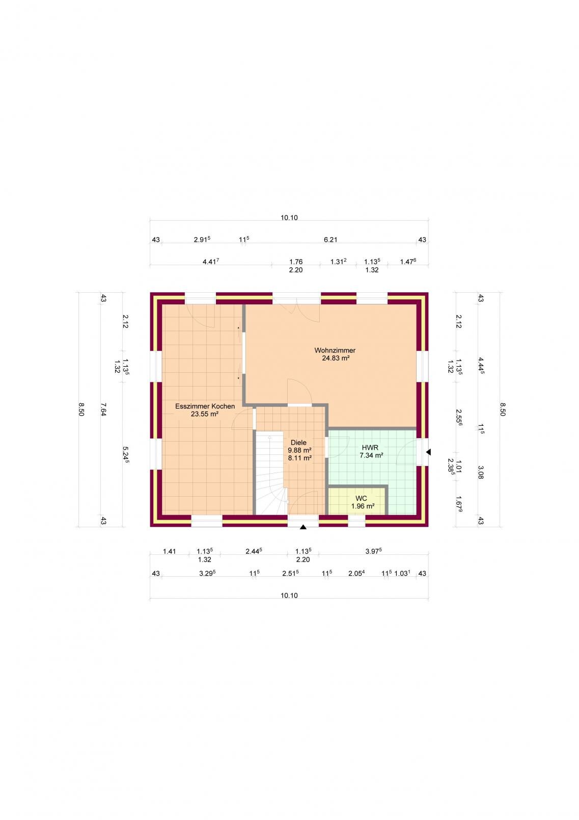

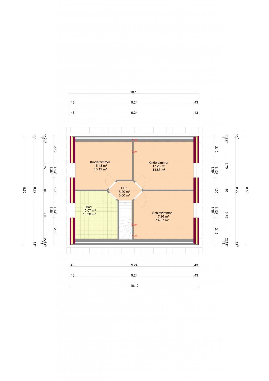

Matthias182
5 Jul 2012 20:53
I have given up on the idea of having five rooms for the size of the house. The rooms would simply be too cramped. We have now received a first draft of a floor plan (from a nationwide provider).
I would be interested in your opinion on it. What would you maybe do differently?
Thanks and best regards,
Matthias
Grundrissplan eines Hauses mit Flur, Bad, Kinderzimmern und Schlafzimmer
2D-Grundriss eines Hauses mit Wohnzimmer, Küche, Esszimmer, Diele, HWR und WC
Der Da5 Jul 2012 21:22
I find the guest toilet next to the entrance door too small, and it doesn’t even have a door 🙂 Depending on the building systems, the utility room might be too small because there is a wasted corner space.
You won’t be able to fit a cloakroom or shoe cabinet in the hallway.
Overall, there is very little wall space for shelves in the living area.
Upstairs, the floor plan is a very standard layout... so it’s okay.
Without a basement, it’s definitely going to feel tight. There isn’t much storage space with a room size upstairs of 15 sqm (161 sq ft). But it could work if you’re not the “collector” type. 🙂
