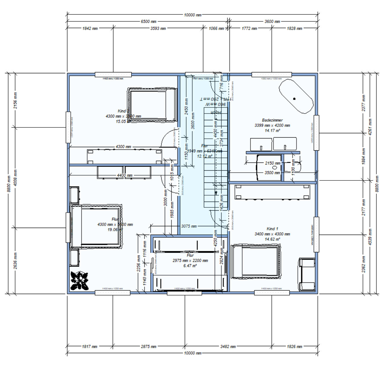

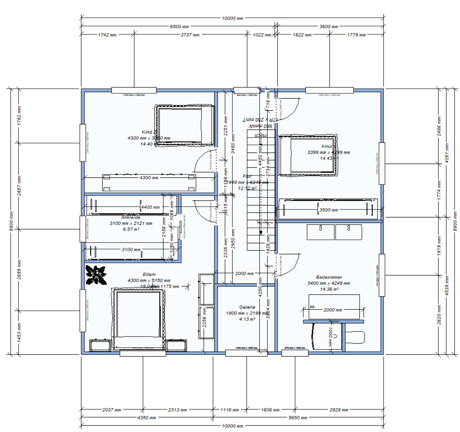

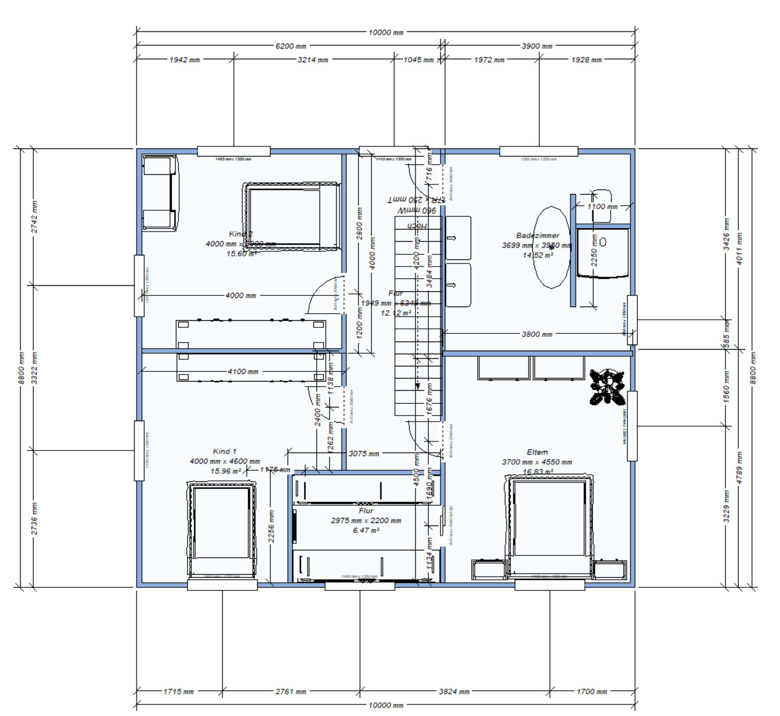

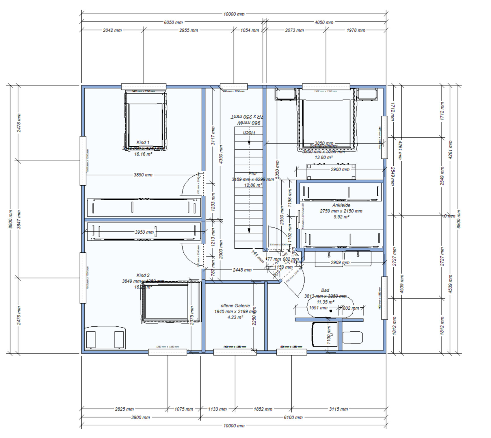

My partner and I have finally purchased a large plot of land measuring 437 sqm (4700 sq ft) in Munich-Eching, and we will soon be building our prefabricated single-family house with Streif Haus. The plan is for approximately 145 sqm (1560 sq ft) of living space with dimensions of 9.96 m x 8.71 m (32.7 ft x 28.6 ft). Increasing this is simply not possible within our budget—for example, adding 1 meter (3.3 ft) on one side would cost roughly an additional €30,000.
So far, I have created all the floor plans using a software tool. Last Friday, we had our first meeting with the architect. Unfortunately, he dismissed several of our wishes:
- The gallery/open space over the upper floor,
- The layout of rooms on the upper floor (both children’s rooms are planned to face south, while the bedroom and bathroom face north, although we would prefer the opposite),
- All terrace requests,
- The design of the bathroom (we wanted a T-shaped layout with the sink set slightly into the room, the toilet and shower behind it, and a freestanding bathtub in the room), etc.
I have attached my plans for the ground floor and upper floor. Since the plot is not rectangular but rather irregularly shaped, positioning the house alone is a challenge because we naturally want the garden and the largest windows in the living room and kitchen to face south. In the attached site plan, the house is still positioned quite centrally (12 x 9 m / 39.4 x 29.5 ft). We will move it as far as possible to the right, towards the east.
We also considered changing the type of staircase (for example, to a half-landing staircase), but according to the architect, the straight staircase belongs to the "Cityvilla" house type by STREIF. I would appreciate your opinions on this. If I change the type of staircase, the entire floor plan will be discarded and the design will have to start from scratch — which is fine, as this is a “major” adjustment.
The architect is planning the entrance not on the south side directly from Schlossberg street, but on the north side: you would approach the property via the street, the house would run sideways along the garage, and you enter after the bend on the north side. So, opposite to what is shown in the site plan. This is quite a long way around. What do you think about this?
You will find comments below with questions. Feedback on the floor plan is welcome!

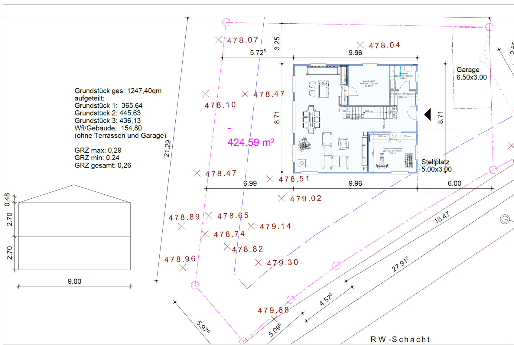

jay2jay schrieb:
My idea and sketch with one parking space/carport next to the house at the top and the other one in the southern part—is that not recommended? That would take away some space from your southeast garden and would make the street feel closer to the house. If there are other options on or near areas that are already used as driveways, I would prefer those.
kaho674 schrieb:
I wouldn’t go with 11m (36 feet), as the garden becomes really small again. It would be better to add an extension on the north or east side.I just measured again with 11m by 8m (36 by 26 feet), the house could then be about 0.65m (2 feet) further northeast, meaning it costs 35cm (14 inches) of southwest garden. But if it means getting a "better" floor plan . No idea what Streif Haus offers in their range. The "floor plans" on the website are a disaster when you need exact measurements.@katja, now a perfect floor plan on 10 by 8.5m (33 by 28 feet) with a bay window on the north side – you’re much better at that than I am!
RomeoZwo schrieb:
I just measured again with 11m x 8m (36ft x 26ft), so the house could be moved about 0.65m (2 feet) further northeast, which means losing 35cm (14 inches) on the southwest garden. If that results in the "better" floor plan. Yep, that would give even more options to experiment with. But let the OP measure first – otherwise, it's all guesswork.
RomeoZwo schrieb:
The "floor plans" on the website are a disaster if you need exact measurements. This mainly referred to the fact that the website is not user-friendly. I only found the layout of the model house through an external source!
Here is something new from me!
The architect has planned our house on the plot in what seems to be the “best” way. What do you think about it?
Since the setback distances of 3m (10 feet) must be observed, I can’t move the house further to the northeast.
The pink line next to the garage was supposed to be remeasured by the architect because the neighboring plot hasn’t been sold yet and the survey is still pending. However, of course, we are not willing to “give away” 12m² (130 square feet) to the neighbor in the southeast—especially considering the property prices in Munich. The architect didn’t know that we have already paid for the land.
From your point of view, is the parking space placed optimally? In my opinion, it’s not. I see it more on the right directly in front of the garage (if allowed) or horizontally in the southeast (bottom right corner).
Unfortunately, the local authority requires a 5m (16 feet) clearance in front of the garage. I’m not sure if this also applies to the parking space? How do you interpret the excerpt from the regulation attached?
More importantly, which main entrance should we choose? South, east, or north?

The upper floor is still causing us quite a bit of trouble because I can’t seem to find an optimal layout for the rooms.
It’s obviously important that the windows are arranged symmetrically. In the sketches, two of them include a gallery. We’ve decided to keep that—but how can we best use the extra space besides as a walk-in closet (probably without a window)? Since we have limited square meters anyway, we don’t want to “lose” these 4m² (43 sq ft), but it’s difficult to make efficient use of it. Do you have any ideas?
I only see the option of a walk-in closet—optionally with a window on one side—and then, instead of wardrobes, we could use dressers to allow light from the windows to come in. But I know we would still lack enough storage space for clothes because currently, we don’t manage with just a 3.70m (12 ft) long wardrobe.
Alternatively, the hallway could simply remain an open space (no gallery), allowing an extra window to bring in more light, and possibly some plants to beautify the area. Enlarging the kid’s room or bathroom doesn’t look very promising.
What do you think? Which option would you prefer or possibly change?
