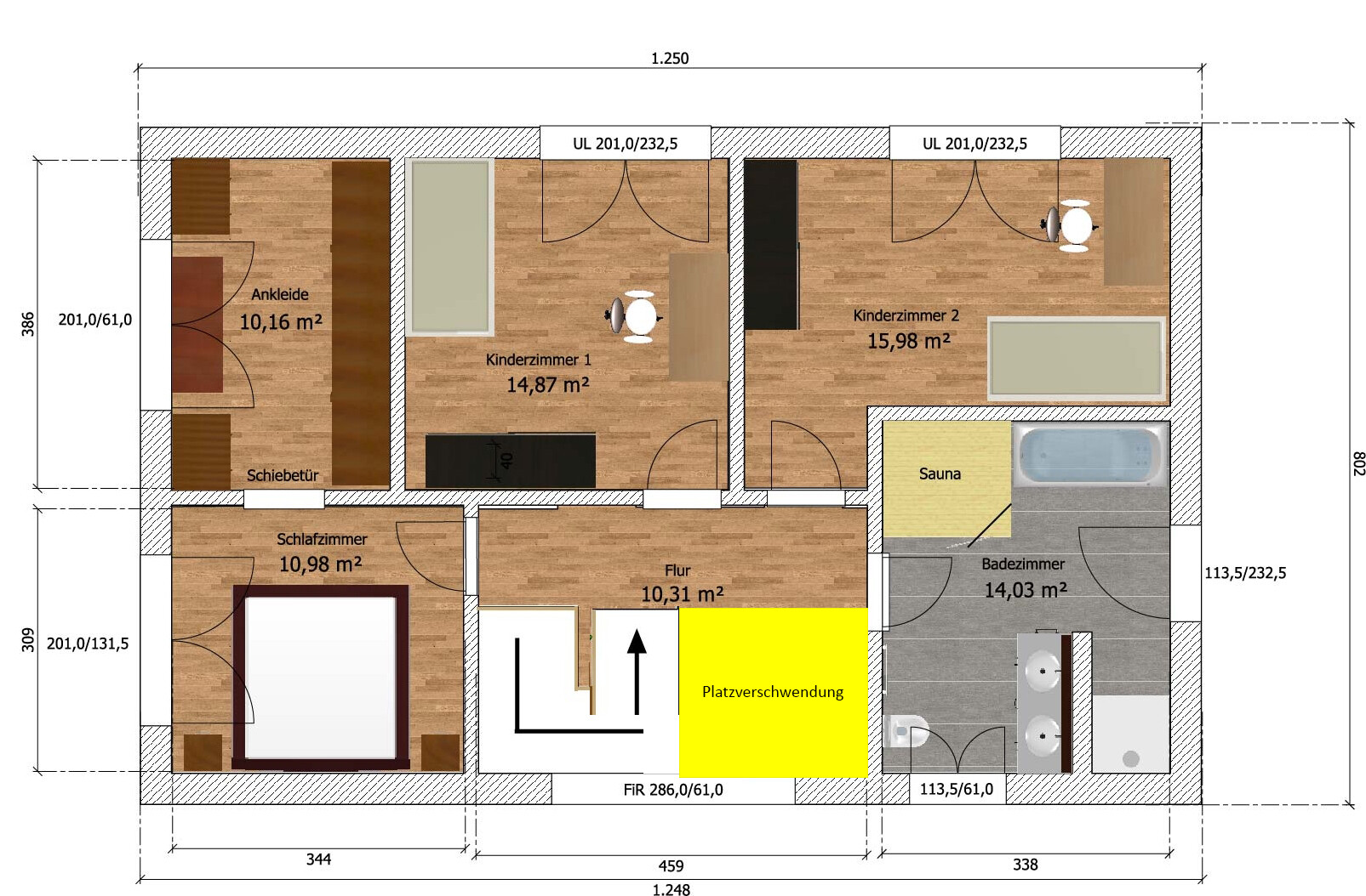

I don’t think the design is that bad. Some areas do waste a lot of space. Always keep in mind that every centimeter you build is very expensive.
For example, take a look at what happens if you change the shape of the staircase:
A huge chunk of space remains unused without even touching the rooms. The living area, with a rough build depth of 3.88m (12.7 feet) and a length of over 11m (36 feet), is one long corridor. Even Joanna from Fixer Upper would have trouble making that feel cozy. The walk-in closet feels trapped—that’s already been mentioned. Child 2 is probably dreaming of more room depth at night rather than elves and unicorns.
With this house shape and orientation, a large garden area to the east (almost exactly) on the left side is basically being left unused. Is the ridge direction set by the building permit / planning permission, or did you decide that yourselves?
kaho674 schrieb:
Take a look, for example, at what happens when you change the shape of the staircase:
[ATTACH alt="treppenform.jpg"]38719[/ATTACH]If you develop Katja’s design further, you can nicely allocate the space for the sauna within the yellow area, and the long wall of the dressing room can be extended straight to the other end of the house. This way, the children’s rooms can also be sized identically.
RomeoZwo schrieb:
If you further develop this design from Katja, I didn’t want to make things worse by adding more small tweaks, but just wanted to point out the waste.
Better to start over.
