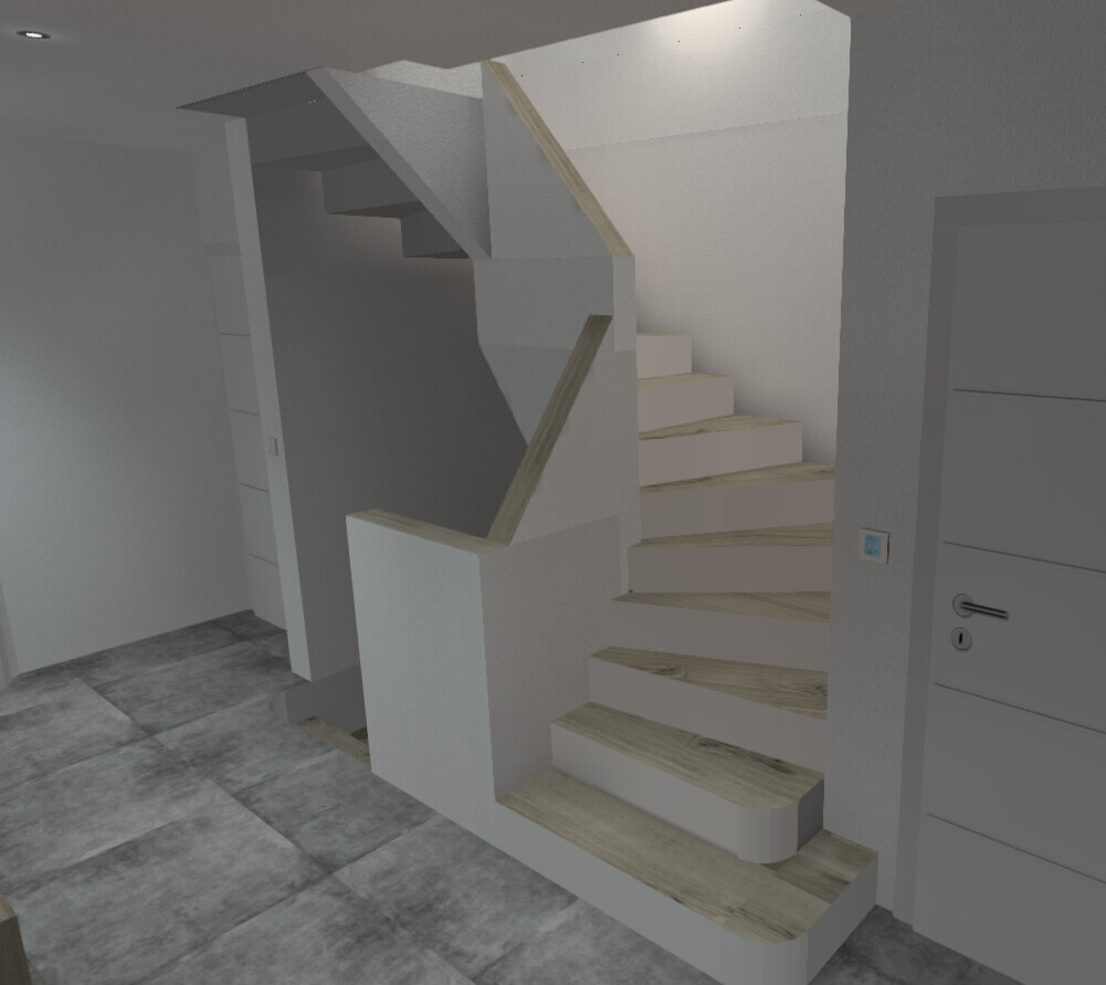

Deutz201628 Sep 2019 07:59@bon1980
Your stair railing is really great. We are also getting a double half-turn staircase with a relatively small stairwell opening, so the varying riser heights are quite a challenge. Initially, we even wanted a wooden handrail, but that would require working with such offsets. We are still in the planning phase at the moment, but I haven’t found a really good solution for that yet. In my 3D model, I assembled the railing from different blocks, which is why it looks a bit odd.
Could you possibly share one or two more pictures of a railing? That would be really helpful.
Best regards, Jürgen
