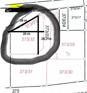

The "problem" with our plot is the slight slope and the northern “tip,” which is hardly usable in a practical way. Due to lack of alternatives, we would still choose this plot and are now exploring what is possible. A preliminary design is already available—see attachment.
The garage would be set a bit lower due to the grading. Here I see the issue whether the office might be too dark because of the skylight?
Our alternative would be the Bungalow 110 from Town & Country with an open kitchen.
For a few days we have been considering whether a single-family house would be more sensible because then the windows in the upper area would be unobstructed.
My aim is to gather some “new” ideas on how best to deal with the lowered area.
So far, the plan is to move the garages as far north as possible and build the house attached to them.

A 10% slope is quite significant, and I’m wondering how much you plan to fill in and how you intend to retain the soil to the side.

The slope from the southernmost to northernmost corner is almost exactly 2 meters (6.5 ft), so it’s not quite 10 percent. Regarding building up the land, it’s clear that we cannot raise the entire plot, hence the garages are set lower.

For a few days now, we have been considering whether a single-family house with a lowered floor level would make more sense, as this would leave the windows at the upper level unobstructed.I was just thinking about placing the office at the front, with the cloakroom and restroom next to it, followed by the utility room. But for us, for example, this wouldn’t be possible in Lower Saxony (NDS), since you are not allowed to build over pipes. How is it in your area? MN could swap the guest room and kitchen with an open-plan kitchen.
In general, I find the two hallway axes too narrow and dominant. They don’t add any livable value; they are just circulation space and, at 110sqm (1184 sq ft), use up too much area. That’s my opinion.
For two people, the layout could be designed a bit more spaciously.
