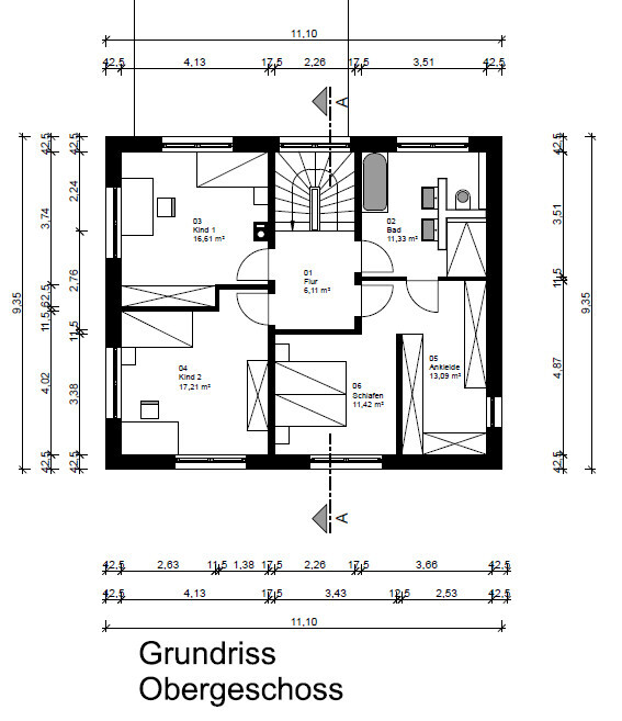

Upper floor plan:

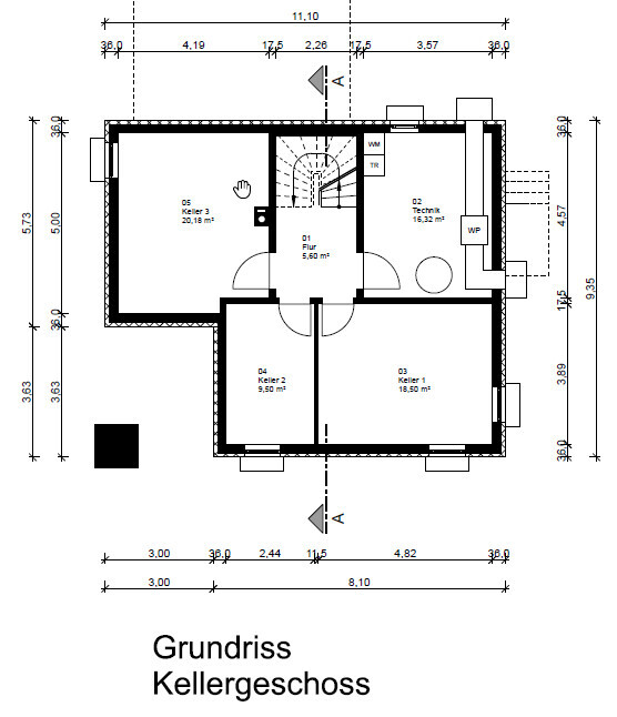

Basement:

Upper floor plan:
Basement:

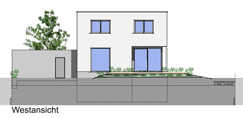

Notstrom schrieb:
I’m really wondering if we should approach this differently, meaning: Is the sequence not actually a) floor plan, b) architecture => Bauhaus, c) cube...
I think we really need to reconsider this, because in the end we only have the style in mind and a rough floor plan; for the rest, we are still "free"... Yes, this sequence is not the right one.
Plot of land, family, and budget are already three more than sufficient constraints to guide the boundless possibilities of a "blank sheet" into a planning direction. Mental scissors – even "just one," no matter which it is – Bauhaus, cube, hip roof, brickwork, each of these additional restrictions is one too many as long as you are still at the concept level. Many aspiring homeowners already pick away at these details in the rough sketch phase. But the selection of conceptual variants belongs in the preliminary design phase, followed by the permit planning in design scale, and only then, at 1:50 scale, is the design refined and styled. Those who want to avoid "Function tries Not amusing hard to follow Form" should not choose their shoes before their dress.

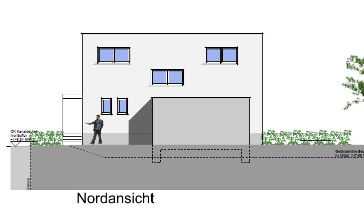

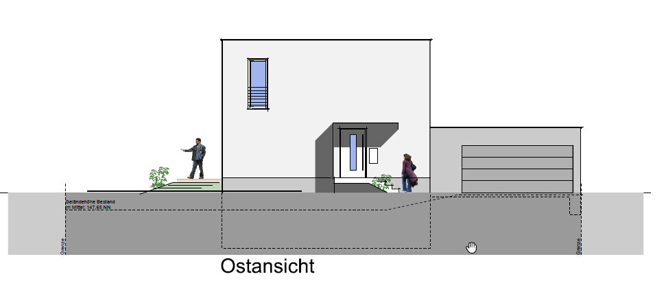

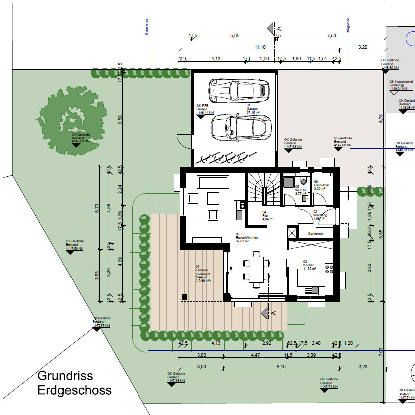

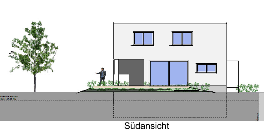

And now here is the second version – still with some open points, but I will comment on those in this post.
Further change requests from us are:
- The fireplace on the ground floor will be relocated next to the dining/living area so we can have a passage from the hallway into the living room (the wall will be adjusted slightly here…)
- The wall in the kitchen will be removed to enable an island kitchen layout
- The wrap-around terrace will be extended up to the window front of the living room to allow an exit there (sliding door!)
- South of the dining table we would replace the sliding door with a glass facade (including possibly a balcony door)
- Possibly replace the spiral staircase with a staircase with a landing. Architect’s note: this requires space
- Possibly adjust the floor area (currently about 148m² (1590 sq ft))
- Enlarge the window at the staircase in the first floor
Open points:
- Bathroom size. Finding space for a cabinet or similar is difficult due to the two entrances to the bathroom, we might need to rethink this
- Simulation of a hipped roof on the given house
- Possibly adjust one or two windows again (e.g., staircase, see north elevation; floor-to-ceiling windows in children’s rooms, see north elevation; horizontal window strip in the kitchen, see south elevation)
- We find the house front (east elevation) a bit plain, but we will come back to that later; at the moment, the floor plan is the absolute priority
Looking forward to your feedback!

Notstrom schrieb:
And now comes the second attempt From the "architect"??? – I would strongly dislike the spatial feeling here: if you turn sharply right shortly after entering the walk-in closet (almost as if stepping through a wormhole into another galaxy), you suddenly find yourself in a recess large enough to fit a double bed. Formally (the bed fits, and the path to get there does too), this qualifies perfectly as a "bedroom," but architecturally, it’s clearly the kind you would at best wish on a (dreaded) mother-in-law. What does the architect do again? – I still consider him more of a permit drafter, meaning a structural engineer who thinks of "Bauhaus" as a specialty store for bathroom mirrors and roofing battens.
By the way – I’m curious if you see any similarities here – the floor plans remind me of the (though successful) design of the house by @Zaba12 https://www.hausbau-forum.de/threads/Grundriss-für-11m-x-8-25m-ok.24781/
