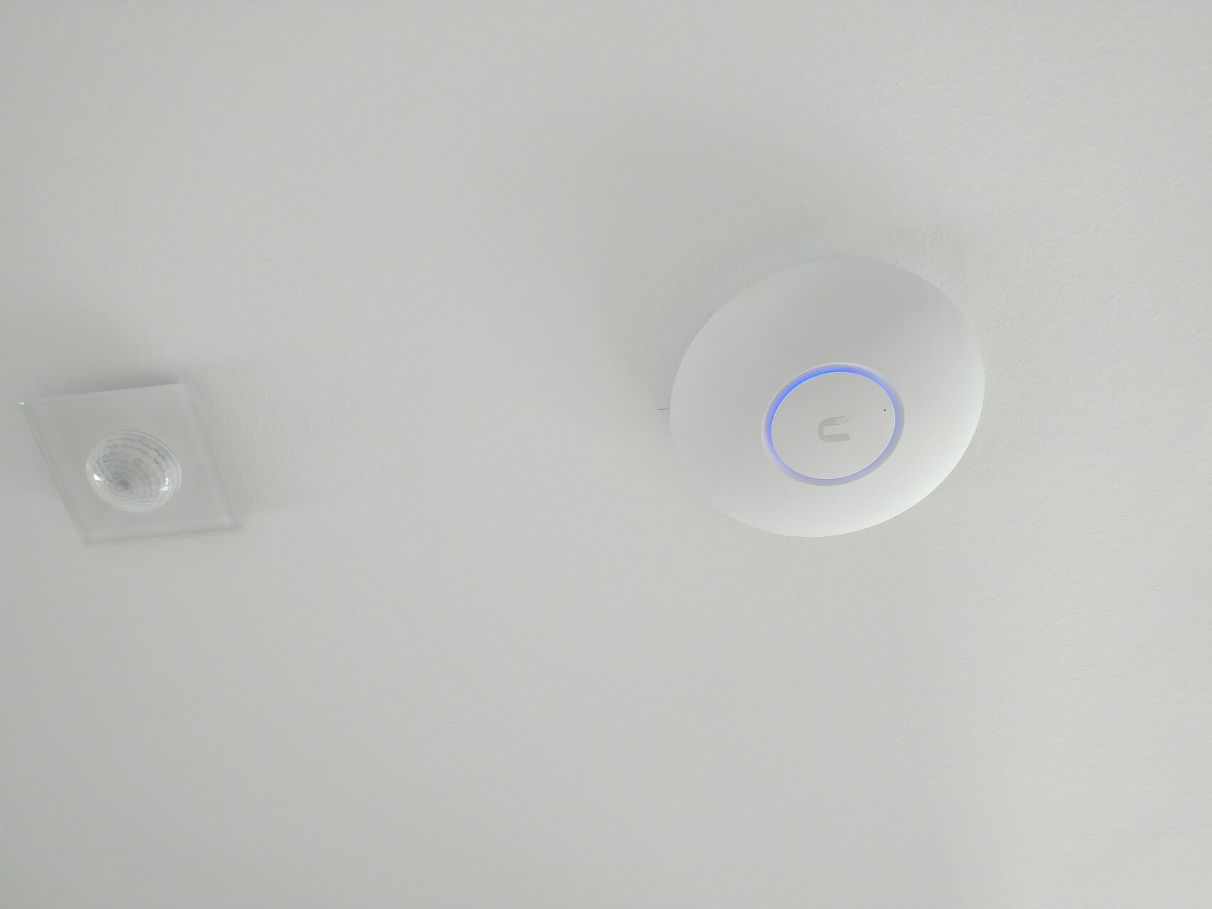

Skip installing junction boxes in the hallways for the access points. From the utility room, we installed 25mm (1 inch) empty conduit pipes into the ceiling of the basement, ground floor, and attic hallways, and pulled CAT7 cables through them.
Now, flush-mounted on the ceiling, there are Ubiquiti UniFi Access Point Lite units running on PoE (adapter included!). These support mesh networking and basically have everything you need and more...

@ivenh0 quick off-topic question: I have the same devices and plan to mount them on the ceiling in the new build. However, I have concerns about the light. I see you have it turned on—does that not bother you at night?
I know it can be switched off, but then I wouldn’t know if the device has failed or if there is a configuration error (once an access point disappeared from management after an update and couldn’t be found again until the management software was completely reinstalled).

Even if the light is on, it can be defective and no longer transmit. I wouldn’t rely solely on the LED. In my case, it is off.
rick201822 Aug 2019 16:17
You should receive a notification through the controller if an access point goes offline or malfunctions. You can safely turn off the LED. Today, I would recommend using the NonoHD.

Who would be bothered by the light at night in the hallway?
It can also be used as an orientation light.
For us, the LED doesn’t bother at all.

Well, my idea was: with the LED, at least I can see if power and network are present. Without the LED, where do you start looking for the fault? As I said, one of mine worked once, but it was no longer detected by the controller and couldn’t be found in the search. No error message either. But alright, then I’ll plan to install it on the ceiling and turn the LED off.
