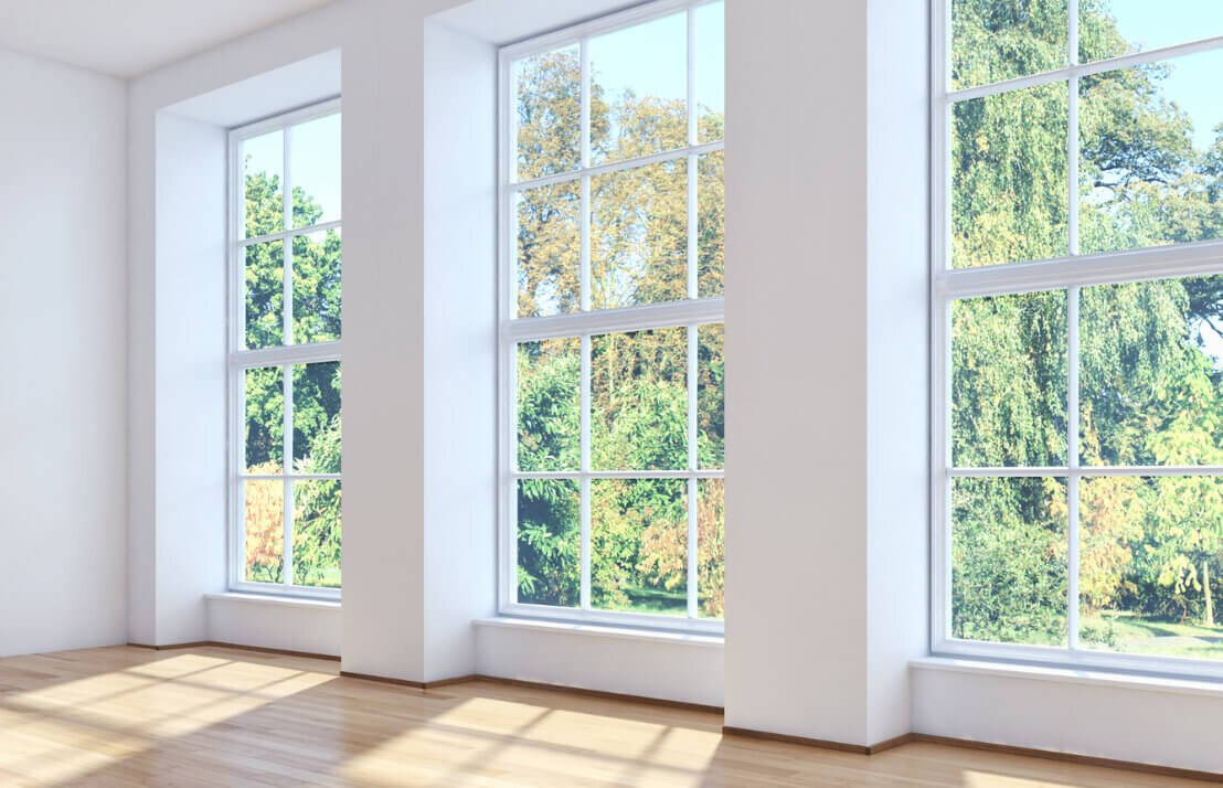

One more question about this: Your suggestion comes to 18 windows (our plan currently includes only 11, so these extra windows will mean additional costs for us because of this stupid regulation). Also, the regulations state:
I don’t actually dislike the tall vertical format. I could really imagine something like this:
However, I don’t want to drive up costs unnecessarily just because of a few extra windows if there might be another way...

Related to the floor plan in the opening post, I would implement it as follows: Utility room 76/126; two hobby rooms each 76/126 with a 24cm (10 inch) post in between; open living area (normal sill height) three windows each 76/126; kitchen and bedroom (toward the corner of the house) similar triples; bedroom (between the triples) a double; bathroom again a triple. Matching floor-to-ceiling elements in the living area 176/213, so the same width as the doubles. The building official will think Mr. Schinkel personally whispered this to you in a dream.
Each opening can be a single sash window, sized without unnecessary divisions, since the terrace doors are not facing the street. With triples, the middle views are clear without posts, all rules are met, and ugliness is avoided.
- Windows and doors must be in a vertical format. Windows in knee walls and basement levels may also be horizontal or square.
- Street-facing window openings larger than 1 sqm (10.8 sq ft) must be divided. When installing single-sash windows, posts and transoms must be designed as glass-dividing elements.
My proposal treats the single-leaf window of the utility room as the basic module and adjusts its size to 76/126 cm (30/50 inches) to remain just under the 1-square-meter limit. Therefore, the windows in my proposal do not require any further subdivision. I would not consider the 24 cm (9.5 inches) wide masonry sections between pairs or triplets of windows as a reason to count them as two or three separate windows. In my view, it remains eleven windows. I do not see the splitting making them significantly more expensive.
That would then require subdivision—but how? Specifically, this is only explicitly defined for single-leaf windows (which I find somewhat questionable, since the apparent intention of the regulation is probably to avoid horizontally oriented windows, but the height division by the transom makes any format appear somewhat more horizontal than it actually is).

Then I could also install a double-leaf window measuring 1.50 meters (59 inches) wide and 1.60 meters (63 inches) high, right?

My suggestion takes the single-leaf window of the utility room as a basic module and adjusts its size 76/126 accordingly to stay under the 1 sqm (10.8 sq ft) limit. Well, the question is whether this only applies to windows larger than 1 sqm (10.8 sq ft): “When installing single-leaf windows, mullions and transoms must be designed as glass-dividing elements.” To me, that seems generally valid for single-leaf windows regardless of size...
From my perspective, those remain eleven windows. I don’t see them becoming significantly more expensive just because of how they are divided. Then I’m curious if my general contractor sees it the same way. After all, this triple window ends up having three roller shutters, right?
That would have to be divided then – but how? – Isn’t the division already created by the two sashes in this case?
Reluctance schrieb:
Well, the question is whether this only applies to windows larger than 1 sqm (10.8 sq ft): “For the installation of single-leaf windows, mullions and transoms must be designed as glass-dividing elements.” They must be divided starting at 1 sqm (10.8 sq ft), so according to my suggestion, none at all. Single-leaf windows larger than 1 sqm (10.8 sq ft) would need to be "divided" by the described fake multi-part design. For multi-leaf windows, I would consider the division inherent due to the actual multiple leafs; this only affects the patio doors on the rear side, not the street-facing side. But it seems this regulation lacks both precision and clarity. The colleague from the legal office must have already been quite tired when they proofread it.
Reluctance schrieb:
Well then, I’m curious if my general contractor sees it the same way. In the end, this triple window setup still has three roller shutters, right? First, I don’t see any roller shutters there...
Reluctance schrieb:
Window shutters are only allowed to be made from wood. Their attachment on guide rails is also permitted. ...and secondly, I would accept a continuous shutter box, meaning two or three shutters (“blinds”) on a single continuous axle.
