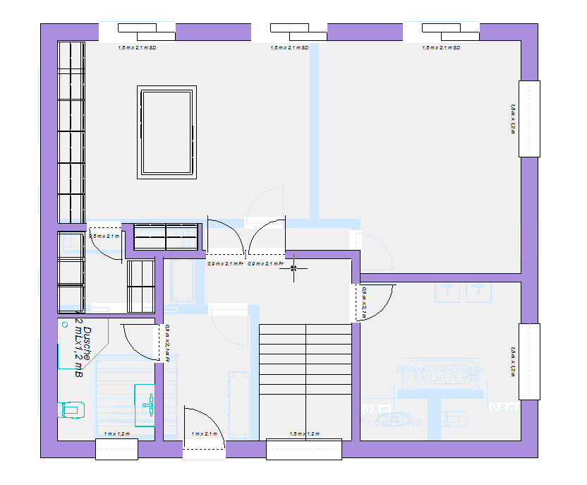

Would it be possible for the bedroom to be on the east side? Then something like this might work:
Once a house reaches a certain size (which you already have), people usually plan some kind of gallery or mezzanine on the upper floor. That element would be missing here. I also don't see the dressing room easily fitting on the west side.
What I don’t understand is the expected gain in space by rotating the house. Unless you plan a significantly smaller kitchen, the rooms just switch places. In my opinion, it doesn’t create more usable space.

TraumvHaus24 Jun 2019 22:40I really like the solution with the bedroom. The only "drawback" might be that the bathrooms are no longer stacked above each other.
We were told that this definitely makes sense and might even be somewhat "more cost-effective." Do you have any experience with this?
TraumvHaus schrieb:
We were told that it definitely makes sense and might even be somewhat "more cost-effective." Do you have any experience with this?Yes, ideally all the downpipes should be aligned vertically. But I really don’t believe anyone would give you even a penny discount for that. However, you can often run the pipes through the floor from one side of the house to the other. I still think it’s acceptable if the pipes run along the hallway and don’t go directly through the living room.
For me, the layout of the rooms is more important initially. Having the bathroom on the east side is definitely desirable.

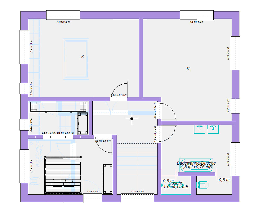

Once the house reaches a certain size (which we have already reached here), it’s common to plan some kind of gallery on the upper floor. A gallery is optional regardless of the house size.
What I don’t quite understand is: you have only 3-5 guests per year, yet you reserve a huge room for them. What happens to the room the rest of the time?
I would combine the office and guest room to gain enough space on the upper floor to create a practical walk-in closet (the enclosed closets are not functional), possibly add a small utility room there, and introduce natural light into the hallway in an architecturally pleasing way. The long corridor it has now is just wasted space and also looks unattractive. I’d prefer a skylight instead of that corridor.
With only one child, you might also consider adding a few extra square meters to the child’s room and creating a small suite with a separated sleeping area—this might keep a teenager a bit closer to home for longer. Or perhaps add a small, private bathroom.
After the teenager moves out, this area can be easily converted into a guest zone without having guests share the family bathroom, while the office remains downstairs.
