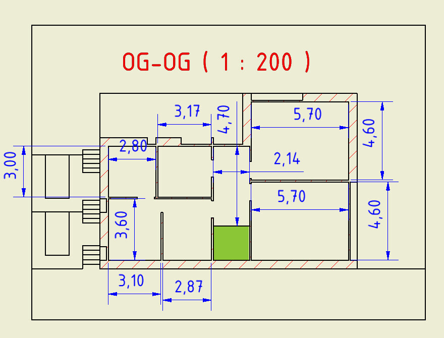

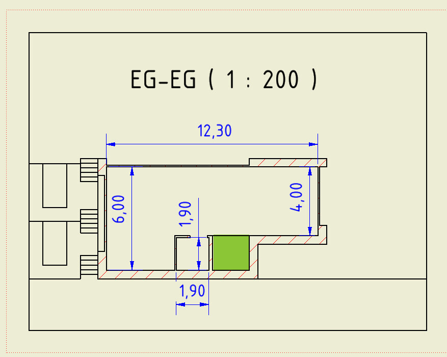

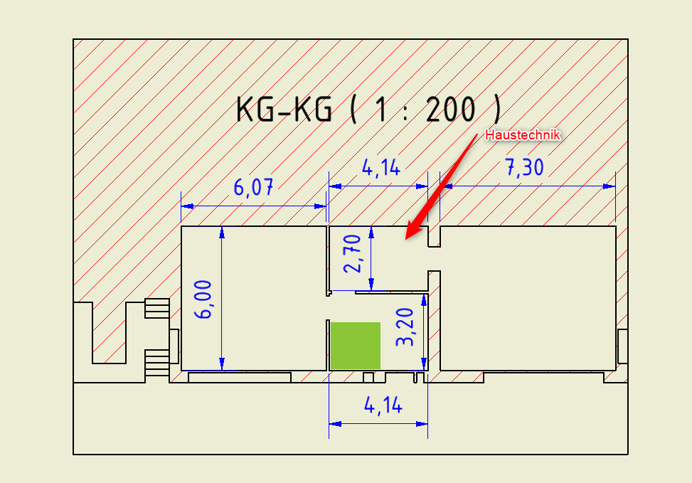

Attached are a few sketches with dimensions. Without a basement, this should be around 170m² (1,830 sq ft). The upper floor extends slightly forward. This is the maximum allowed by the building setbacks. The overhang will then be adjusted to what is technically feasible. From what I found online, one of the advantages of steel construction is that such designs are easier to implement. If necessary, a support column would also be possible.
The budget is currently at 320,000 euros, with up to 380,000 euros possible. However, the goal is to need less rather than more.
The wish is to have an affordable heating system for 20 years and to be able to heat rooms individually as needed.
