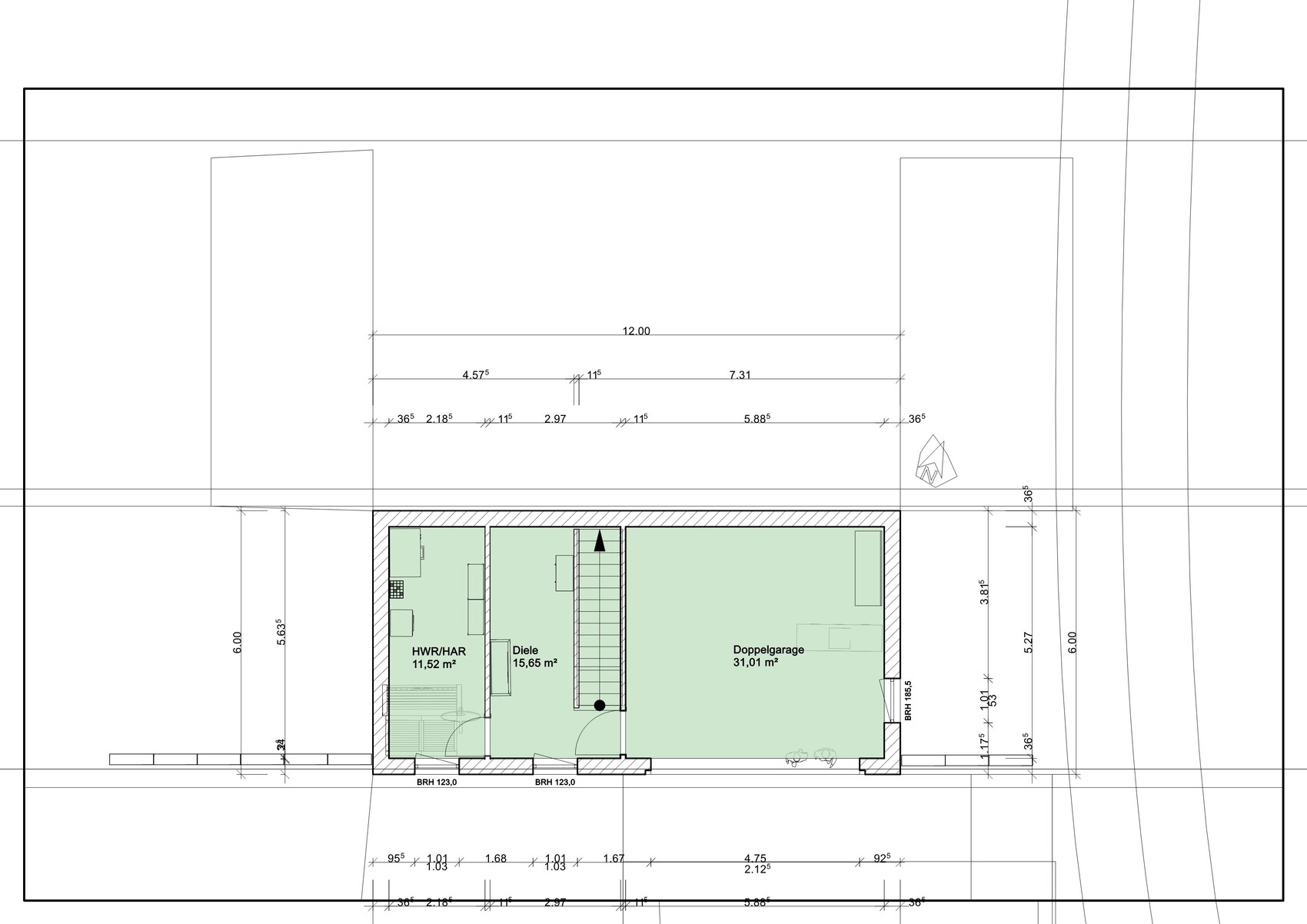

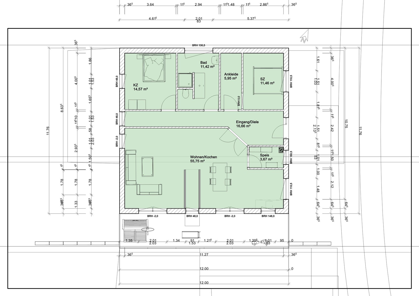

@ypg
Right now, I can’t really estimate the cellar costs either. However, it won’t be too large since we plan to build offset from the bungalow “with the slope” to minimize digging and soil removal.
The cellar size, together with the double garage, is just under 60sqm (645 sq ft).
The terrace or balcony faces the driveway side, as that is the view down into the valley (south side). Another terrace facing the garden is planned on the southwest side.
Attached are a few screenshots for better understanding.
Please take a look and feel free to provide feedback...
