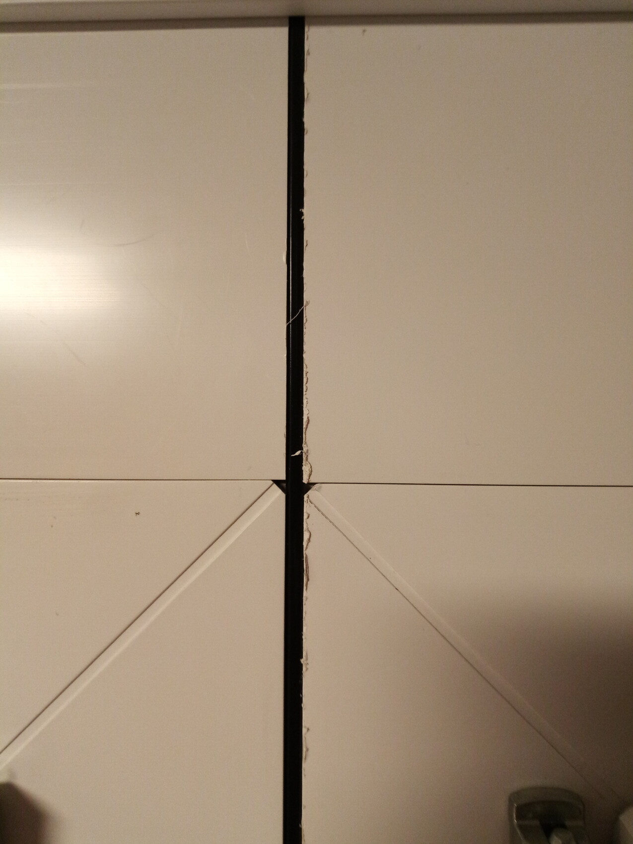

1) We have a double-leaf balcony door and right next to it a regular balcony door. There is a seal between the two elements. However, the seal does not extend all the way to the bottom (see photo); approximately 7-8mm (about 1/4 inch) are missing. On the outside, there is also no additional seal installed (see photo). Exactly where the seal is missing, there is a draft, and a relatively loud whistling sound can be heard constantly, even when the roller shutter is down. Should the seal be replaced, or is it sufficient if the window company repairs it with silicone? I want it to be done according to standard practice.

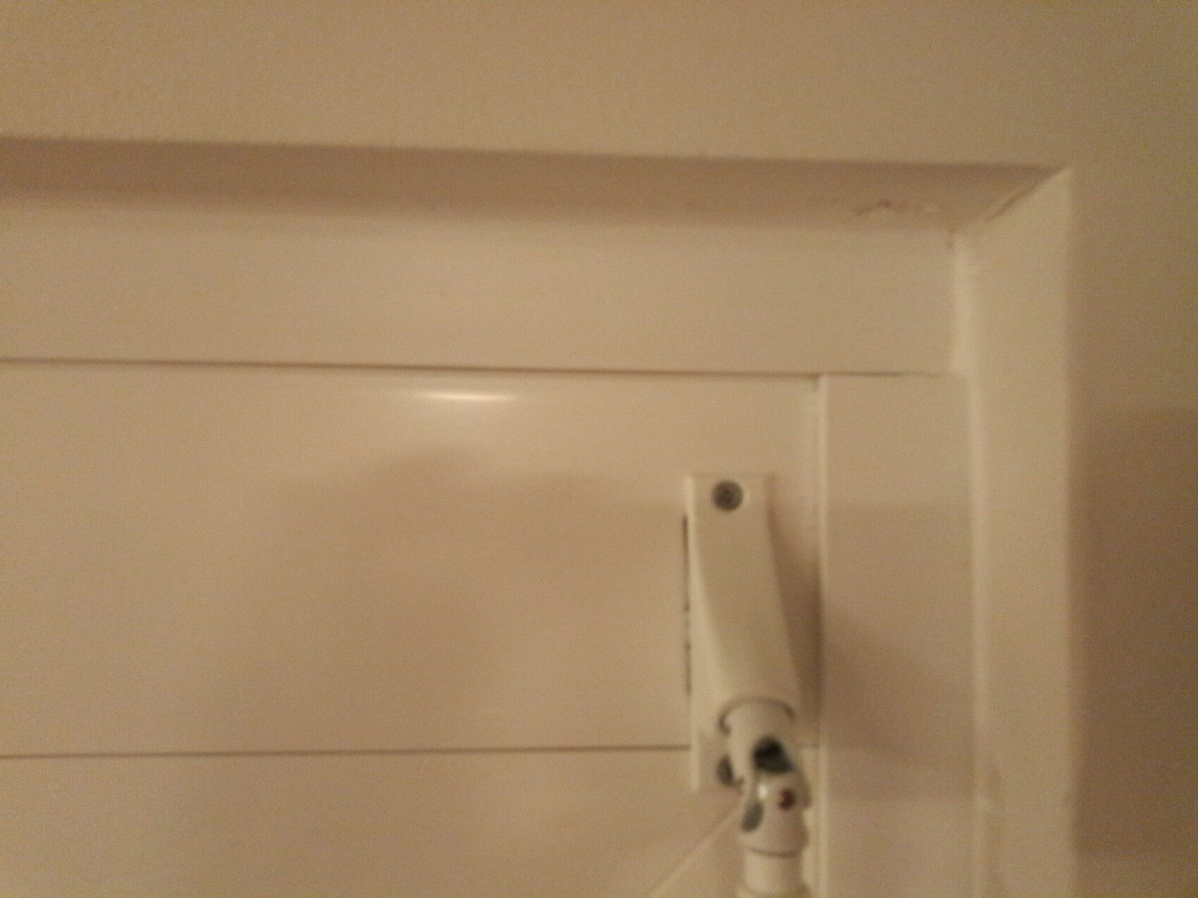

2) Between the two elements at the seal, the frame is slightly frayed (see photo). Is this normal or not? Also, how much silicone is acceptable when attaching the retaining strips? As shown in the photo, the work looks quite sloppy. In other places, the retaining strips are a bit too short (1-2mm) and were simply filled with silicone.

The (only!) right way here is: get rid of the junk! This is irreparably defective material, installed without the slightest trace of professional expertise. Not low quality in the sense of discount store goods – I cannot judge that accurately from the photos – but scrap in the sense of poorly processed and severely damaged.
If you’re going to mess things up like this, replacing a three-panel unit with a two-panel and a separate single-panel unit, it should at least be properly connected with a coupling profile.
First of all, such a coupling profile may not even exist in the profile system used here (so maybe it *is* discount junk?), and secondly, it takes up a few centimeters (inches) of width, which should have been accounted for in the other units. This already rules out any proper repair, since at least one of the units would have to be replaced because of this. NO seal can adequately replace such a profile.
Furthermore, I have the impression that blunt tools were used to cut here or that the miter saw was misaligned, since the only correct gap in the miter joint should be zero.
Basically, silicone or acrylic sealant is only intended for joints when the installer understands the fundamental difference between a joint and an excessive tolerance. That is clearly not the case here, not by a long shot (I’m missing the Mady who could convert that into Schillings *smile*).

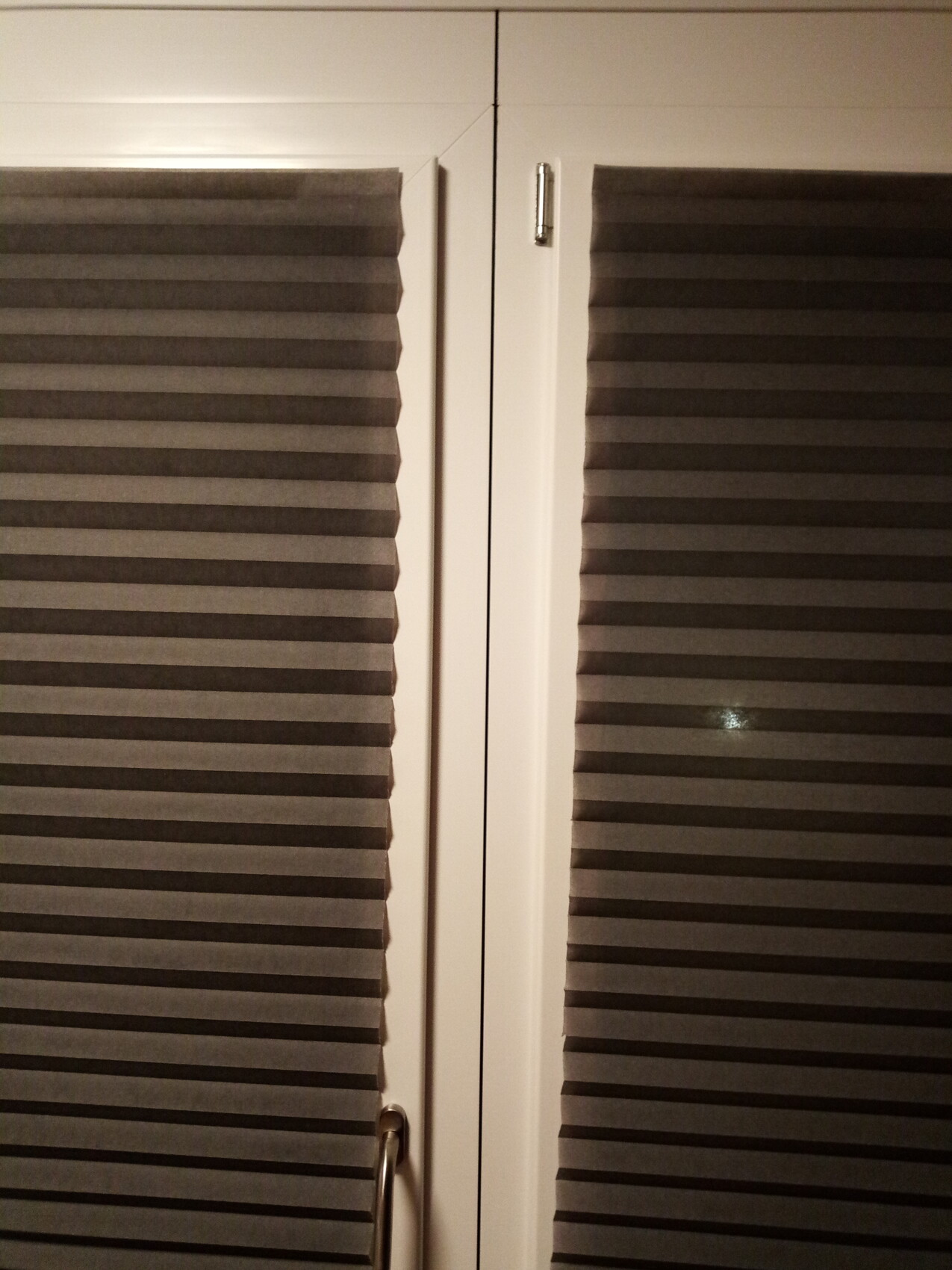

The windows and patio doors are from Internorm, so not discount quality. I’ve also taken a few photos. There is a draft coming through the seals at both the top and bottom.
@11ant In your opinion, are the patio doors made of two parts that, as installed, cannot possibly be airtight?

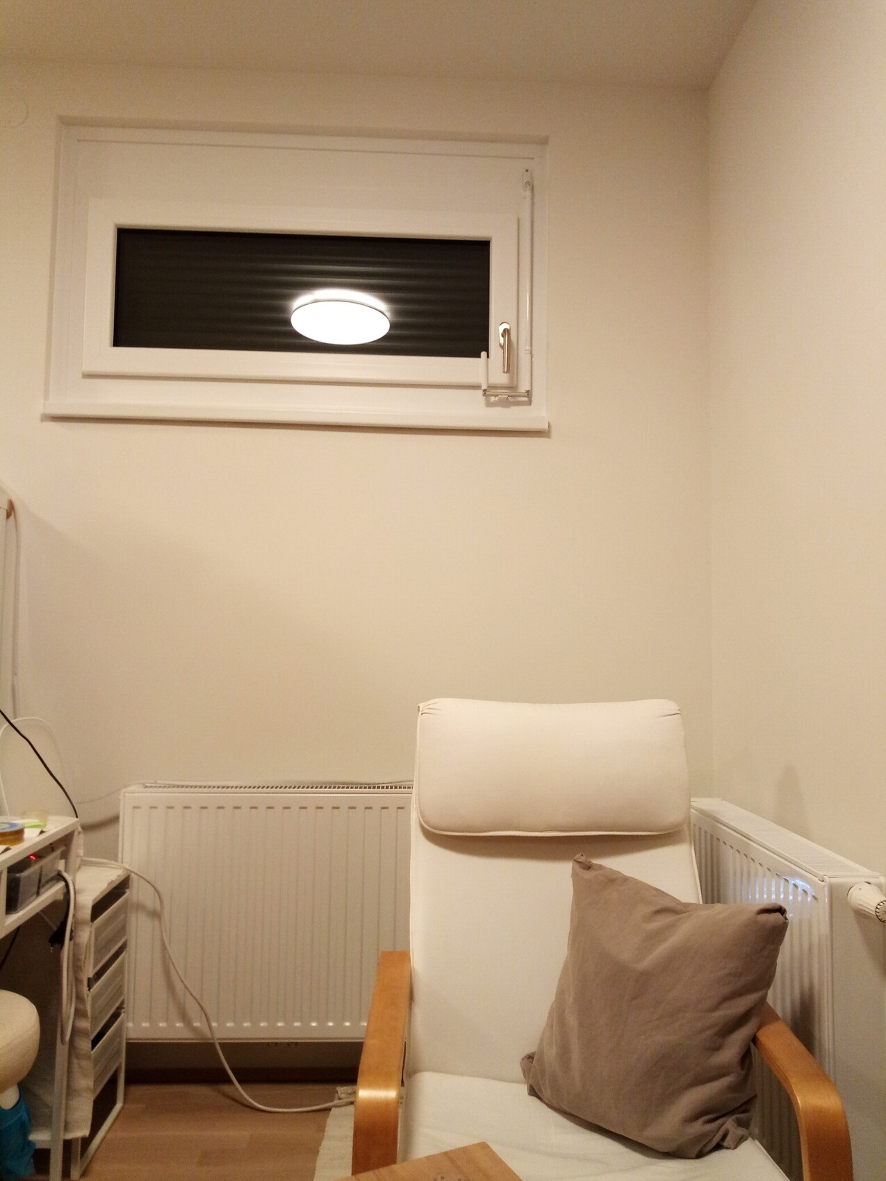

Two window sills are at a height of 170cm (67 inches), because the ground floor windows face the sidewalk. I don’t know why the inner window sill has a drip edge. Maybe the developer was preparing in case it soon starts to rain inside… which is not impossible with all the defects.
