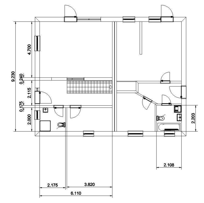

It’s about a two-story urban villa measuring 11 x 11.5 m (36 x 38 feet) with a granny flat and no basement.
It’s important to us to separate the living area from the dining/kitchen area.
I hope everything is clear, as I quickly created the plan using Photoshop.
We haven’t been to an architect yet. I would appreciate your opinions on the floor plan.

perlenmann31 Jan 2012 14:15Stairs in the middle of the living room walkway? Because of the slanted door, you might not be able to get the heating system into the utility room, or will you modify the walls around the heating unit? Basically, it’s a bit "angular."
I’m currently imagining a 4.4m² (47 sq ft) bathroom with both a shower and a bathtub.
This advice has been given before: consult someone who is experienced in this field!
Thank you, Perlenmann,
I think I will hear/read the advice about getting external help quite often. However, I still want to try it myself.

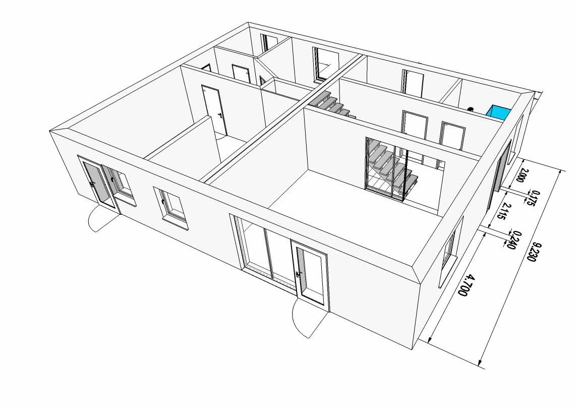

I followed your tip and removed the corners/angles. At first, I didn’t want the wardrobe under the stairs, but it actually looks good, and the WC and utility/storage room are slightly larger as well. The opening will have a glass sliding door to create an open feel while keeping odors and noise contained in the kitchen.
Regarding the bathroom in the granny flat: there is no shower, but a bathtub and a washing machine. Currently, we have a WC of the same size, and it works quite well.
perlenmann31 Jan 2012 15:59A bit better already
I would reconsider the openness effect of the glass door. You’re basically looking through a pane of glass at a staircase! Does that really feel open?
About the washing machine: I would end the hallway (in the granny flat) directly at the bathroom, making the bedroom bigger. You can’t really use the square meters in the hallway, but you can in the bedroom.

For a nice staircase, I think it’s better to look at the stairs rather than a wall, but I will render it and take a look.
I have already virtually furnished the bedroom, and it fit well. The larger hallway then provides space for jackets, shoes, and so on. A kind of “in-between” solution is probably best there.
