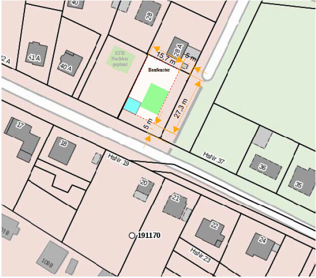

Here is the oriented site plan, followed by the elevations and floor plans...
Plot size: 671 sqm (7220 sq ft)
Slope: none
Site coverage ratio: 0.15 (max. house footprint 100.6 sqm (1083 sq ft))
Floor area ratio: 0.3
Building envelope, building line, and boundary: see site plan
Required parking spaces: 2 (hence double garage, minimum garage parking space width/length 2.4/5 m (8/16 ft))
Number of floors: 2
Roof type: no flat roof
Maximum buildable area including ancillary structures: 150.9 sqm (site coverage ratio 0.15 + 50%)

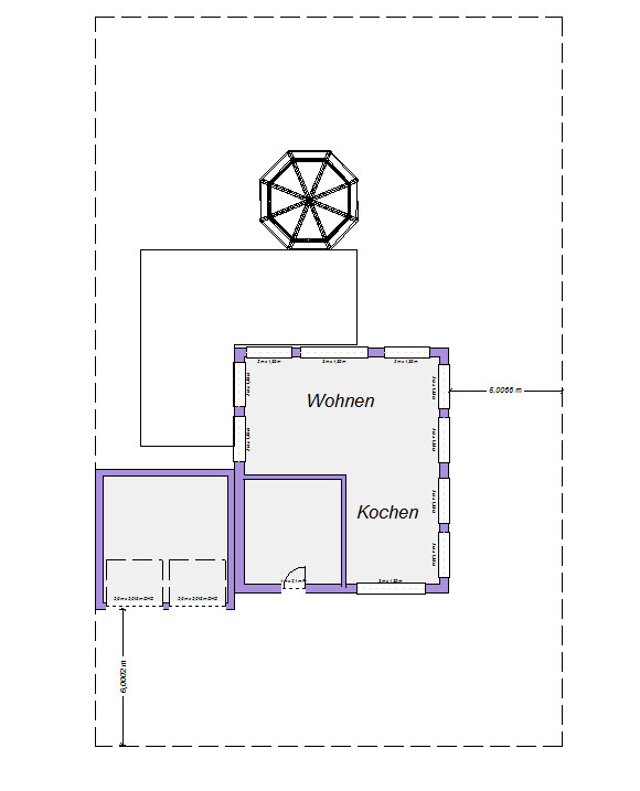

The orientation of the house according to the cardinal directions is, of course, the ideal choice. You have a plot facing northeast – probably one of the least favorable orientations. On top of that, you are only allowed to build on the west side. Even less sun.
I would give up the struggle to get southern sun onto the terrace and accept the situation as it is. A beautiful garden can also be created on the north side. In summer, the sun is present for a long time and shines from the west onto the north-facing terrace. In winter, people generally don’t sit outside; here, it is more important to bring the sun into the house, not onto the terrace. Additionally, the house also serves as a shield from the street. Hardly anyone wants to sit in the front yard.
Excessively long paths are just costly and take up unnecessary square meters from the garden.
Therefore, I would probably position the house like this:
If after the first summer you find that you don’t get enough sun, you could always consider placing a pavilion in the center of the garden.
Wastewater exits the house at its source and is directed together into a sewage shaft. Rainwater from the roof (if managed) also goes there and is then drained.
I am also surprised that the utilities are not collected from a single point on the property.
With the planned garage and the house, and a north-facing utility room, access would be to the east, but not to the south, at least not by a simple, direct route.
Yes, the garage will be quite a blunder.
That would also be an option, with the garage on the right to the south (then the edge development becomes a repaved parking area), at least to better manage the paving and the path to the house.
Maria16 schrieb:
What is the objection to positioning the house more consistently to the south, or at least placing the garage on the east side, so that the garden isn’t flanked by access paths on both sides?
kaho674 schrieb:
Orienting the house according to the cardinal directions is obviously the first choice. You have a plot facing northeast – probably one of the least attractive orientations there is. On top of that, you are only allowed to build on the western side. Even less sun.
I would give up on the struggle to get southern sunlight onto the terrace and accept the reality. A nice garden can also be created on the north side. In summer, the sun is out for a long time and shines from the west onto the north-facing terrace. In winter, you don’t spend time outside anyway; here it’s important to bring the sunlight into the house – not onto the terrace. Moreover, the house also serves as a shield against the street. Few people want to sit in the front garden.
Long paths are just expensive and unnecessarily reduce the garden area.
If after the first summer you find the sun insufficient, you could always consider adding a pavilion in the middle of the garden. Hi Katja,
I’ve incorporated your suggestion into our plan. Thanks.
This is exactly our original planning before we found out that our neighbor to the west intends to build their house all the way at the northern edge. We thought it made more sense for both houses to face north. That’s why we are also trying to find a practical solution for a south-facing garden.
The only downsides we see with this plan for a north garden are that the neighbor’s existing house to the north is elevated and doesn’t look particularly attractive.
kbt09 schrieb:
J
and then ... 10.6 m (35 feet) wide house and garage exterior dimension only 5.15 m (17 feet), while you are already counting the exterior wall of the house as the garage wall.
Where will the bicycles go? Lawn mower and other garden equipment? You write that the garage is more for working on cars than parking, but in winter you lose the chance to get into a scratch-free car.
And then there was the important question… Where do the utilities enter the property from? You placed the room for that in the north corner. Is that practical?
Do you already know where the neighbor wants to put their garage/carport? And what are the setback requirements? 3 m (10 feet) unbuilt next to your property or even 5 m (16 feet)?Hello kbt,
The garage width is only intended to meet parking space requirements, hence the internal dimension of 4.8 m (16 feet). The garage should never be used as a true double garage.
Since the possibility of a rooftop terrace on the garage roof most likely will be discarded, the garage will not be located on the north side, but rather at the street side in the south.
Putting the garage on the east side is not possible because outside the building zone neither garages nor parking spaces may be built.
Bicycles, garden tools, etc. will go into the garden shed and not into the garage.
I have roughly drawn in the neighbor’s garage, but that is only a preliminary plan. The neighbor must keep a 3 m (10 feet) setback or boundary construction, and along the street must keep 5 m (16 feet).
