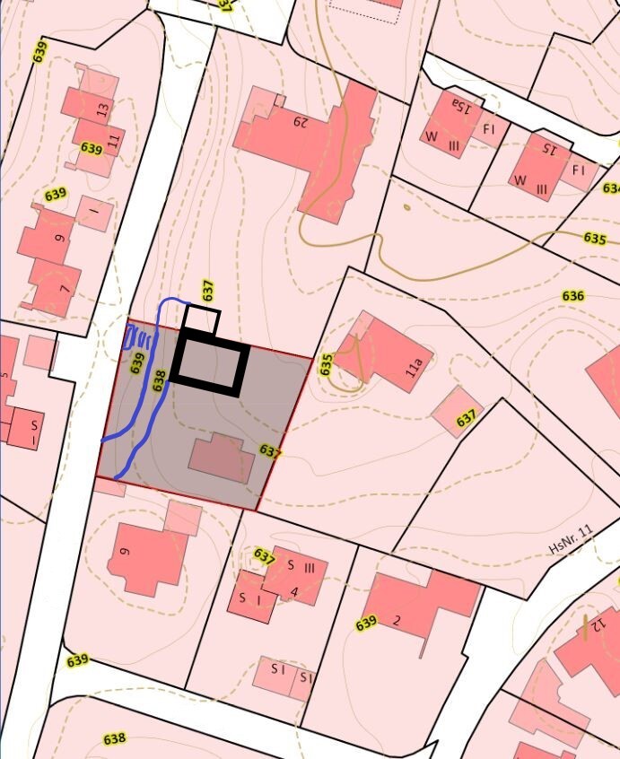

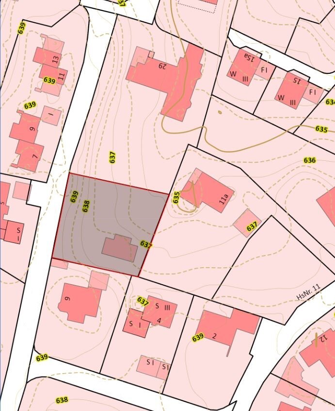

Regarding the site plan (which is oriented to the north):
The building in the lower right is a garage/shed that will be demolished.
We would of course place the house as close as possible to the northern boundary. Theoretically, even directly on the boundary, since the land to the north belongs to the parents, making boundary construction possible. The garage could also be placed on the parents’ property, as we are testamentarily entitled to a portion of the parents’ land (in total, half of both plots). However, only the lower plot is being given away for construction.
The challenging aspect of the plot is that it slopes steeply downward from the street for about 3–4 meters (10–13 feet), then continues with a gentler slope. Regarding the driveway, we have considered the following: our plan is to avoid this slope by placing the driveway in the lower left area (where the current driveway to the shed is located). The slope can then be supported or shortened with retaining walls made of L-shaped concrete blocks (if you know what I mean).
Opposite the main entrance door, there would simply be stairs leading up to the street, with a trash bin enclosure and an entrance located there.

Spontaneously, I would have placed the garage between the house and the street.
I don’t like the long driveway.
It’s also quite expensive.
