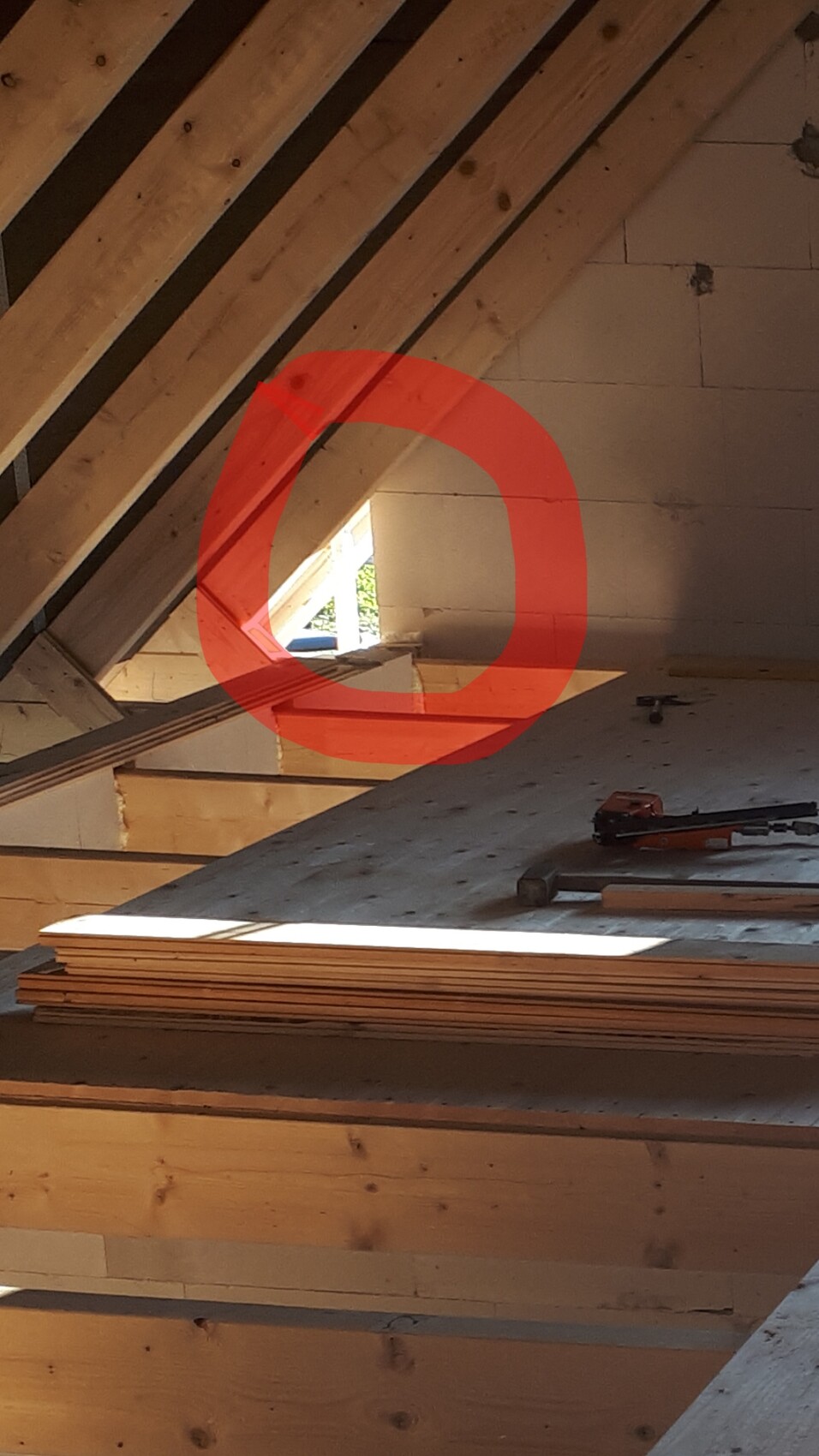

Do you already know the exact position of the 2m (6.6 ft) line? Considering this low knee wall, it should be about 2m (6.6 ft) from the outermost exterior wall, right?
The windows should be roughly here. The original poster measured about 2.17m (7.1 ft) from the interior wall on the south side and around 2m (6.6 ft) on the north side, correct?

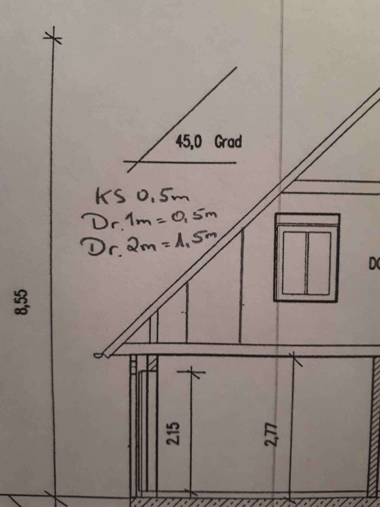

pffreestyler4 Dec 2018 08:10Regarding the knee wall, I had given incorrect information out of ignorance. I think it’s clear here that there is actually a small knee wall present.
I measured this on the 1:100 scale section drawing, with a 10cm (4 inches) floor buildup already included. The window position is incorrect on the section! You have to rely on the measurements I took.

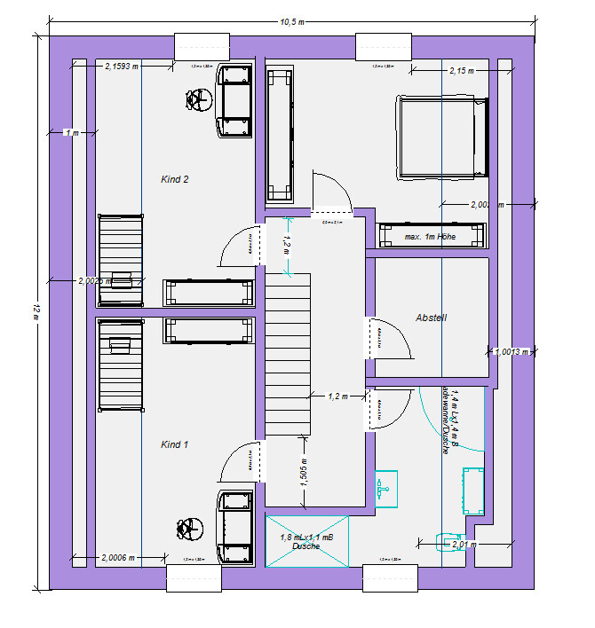

I think I can see that the 1m (3 ft) and 2m (6 ft) lines on your floor plans could be moved slightly further outwards?!
From the floor plans, I would like a mix of both proposals. Maybe swap the shower and toilet in ypg’s suggestion and then move the wall slightly to the north; remove the closet space from the left children’s bedroom and instead make a small storage room there? I would find this useful for things like a vacuum cleaner. To compensate, move the partition wall between the children’s bedrooms a little to the right, so that a wardrobe fits on the wall in the left children’s bedroom. The desk can be moved further to the left. The right children’s bedroom could receive the lower closet space from the master bedroom as compensation.
Tell me, what do you want to do with the rooms downstairs if you squeeze everything upstairs?
Try to treat both children’s rooms equally. It’s not acceptable if one gets an American-style closet and the other doesn’t.
The vacuum cleaner can also be stored in the bedroom.
What are the rooms on the ground floor still for?
pffreestyler4 Dec 2018 08:24Valid point that it is fair to make both children's rooms the same.
The vacuum cleaner could go in the bedroom. Maybe we should reconsider the storage room after all.
The idea is that my clothes stay downstairs in the bedroom and I also use the downstairs bathroom in the morning. Currently, we also keep our clothes in separate rooms because I have to get up earlier, so we don’t wake each other up when one of us can still sleep.

If I look at the cross-section image from the original poster, the roof overhangs the exterior wall. The 45° angle therefore starts just a few centimeters before the outer wall. Accordingly, the 2m (6 ft 7 in) limit should theoretically be around 2m (6 ft 7 in) because of the 45° roof pitch. It might even fall slightly below 2m (6 ft 7 in), but the insulation will make a difference, I think. We probably will never know the exact value.
