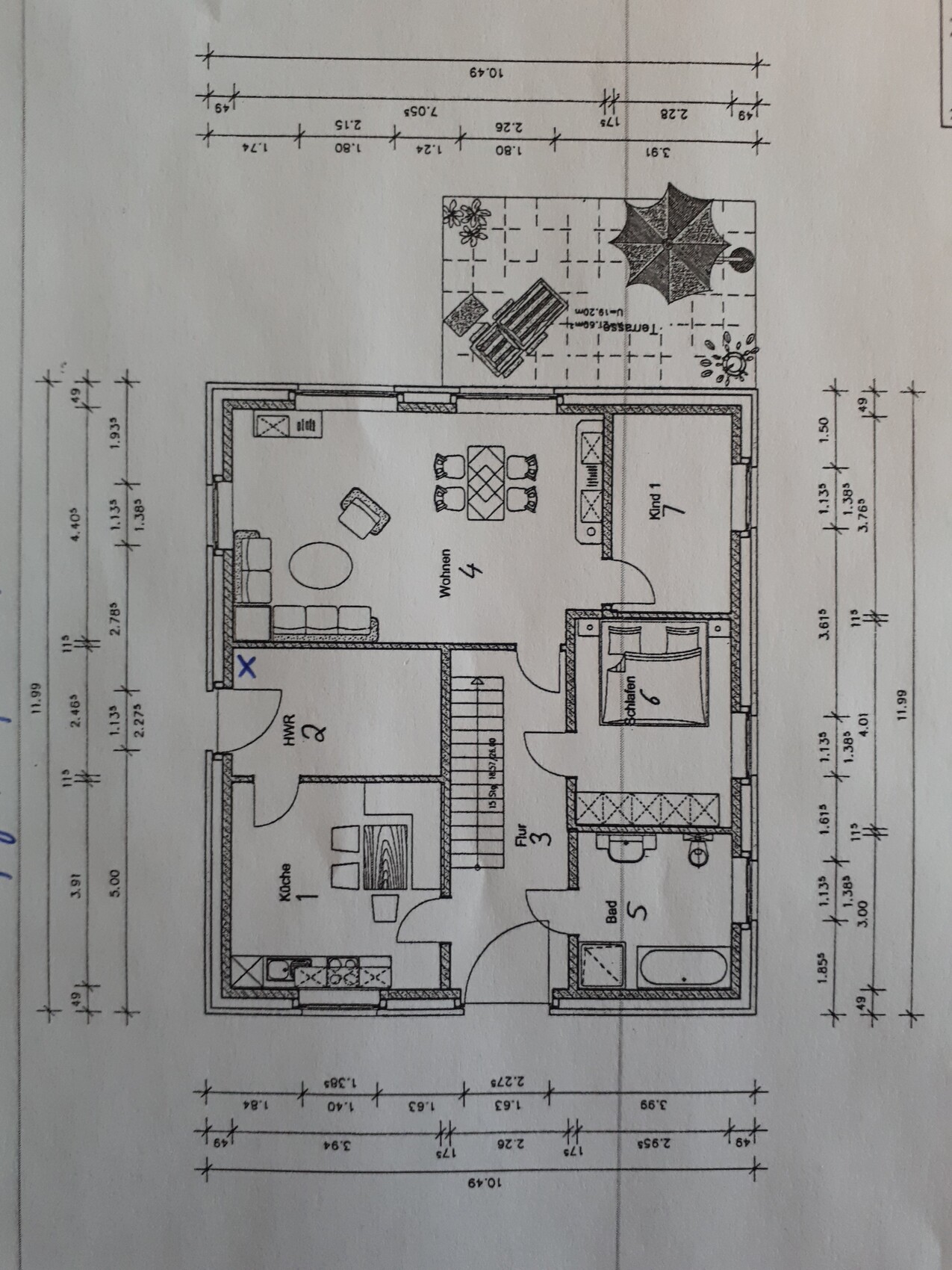

The floor plan is based on a very similar layout seen during a house viewing and is our favorite among all viewings and catalog research. We only adapted it slightly to our needs (removed guest WC and enlarged living room, rotated office).
The floor plan basically fits us, but I would appreciate your opinion to see if any improvements are possible. Note: as mentioned, we want to move the office window to the west so the wall doesn’t look so bare. Driveway on the east, not west. Therefore, the bare wall on the west is where the carport will go up to the utility room door. Alternatively, a window could be added to the living room there and the carport start behind the house. The plot allows this.
My main concern is that we’re not 100% happy with the roof’s east-west orientation; I would prefer a north-south alignment. Do you have ideas on rotating the floor plan 90 degrees while keeping the layout mostly unchanged? Only the kitchen and office could be swapped.
PS: The square meter figures for the hallway may be incorrect; the contractor will finalize after Easter. Correct figures will be approximately: living room 31.79 sqm (342 sq ft), kitchen 15.19 sqm (163 sq ft), utility room 9.87 sqm (106 sq ft), hallway about 19.5 sqm (210 sq ft), office/child room 1 about 8 sqm (86 sq ft), bedroom about 11.8 sqm (127 sq ft), bathroom about 8.5 sqm (91 sq ft)

Take a look here: https://www.hausbau-forum.de/threads/grundrissplanung-kurz-vor-bauantragsstellung.25647/page-80 – a very similar topic is currently being discussed there. A dimension is only as valuable as
a) the reference point is specified, meaning whether the wall opening is measured from the rough floor or the finished floor level;
b) it is accurate, meaning tolerances exist and, as mentioned in a), misunderstandings can occur during construction;
c) it is clear what it refers to, meaning whether it only applies to the door itself or also includes the roller shutter box.

a quick update: the measurements were actually incorrect. The patio doors were too small, and the difference between the front door and the utility room door was because one was based on rough opening dimensions and the other included some existing construction.
Due to the roller shutters, the actual clear passage height will be 2.15 m (7 ft 1 in).
Unfortunately, this is not a standard size, but since the roller shutters are custom-made, only the fly screens for the patio doors will be more expensive, as standard stock won’t fit. We’ll manage...

@pffreestyler .. I recommend checking every drawing to ensure that the revised values have been transferred correctly and consistently. This is especially important for the execution drawings for masons and similar trades.

Yes, it was noticed in the course of that. Since the Ytong blocks are being glued by the owner, it’s better that it was discovered in time anyway.

we are currently in the middle of the construction phase. Attached is the floor plan again as a reminder.
Ground plan of a house with kitchen, living room, bathroom, bedroom and children’s room, terrace

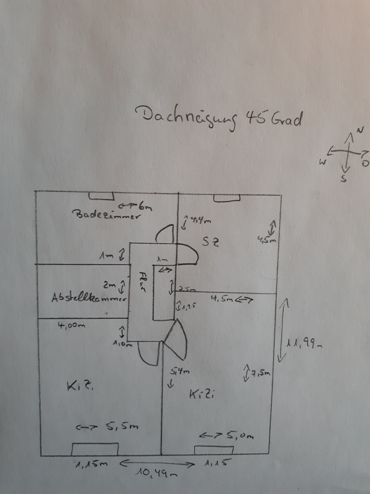

At the moment, I am more interested in a floor plan for the UF. I have made a sketch and would like to know your opinion.
Hand-drawn attic floor plan with bathroom, storage room, two children’s rooms, bedroom, hallway and stairs
The drawing does not yet take wall thickness into account (these will be drywall partitions, since there is a wooden ceiling) nor the space lost due to the sloping walls. For now, I’m just concerned about the layout itself.

Is it financially secured that a later expansion of the roof is feasible?
