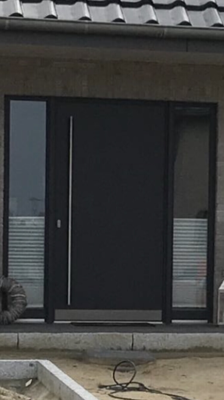

I have no idea how much mine costs :-(
I received an overall quote and didn’t ask for individual item prices.
Dimensions: 230 cm (7 feet 7 inches) wide (the door itself is 115 cm (3 feet 9 inches)) by 230 cm (7 feet 7 inches) high.
My gut feeling is around 3000 euros?
German manufacturer "Brandt"
In this style
This is not exactly ours
In this style
