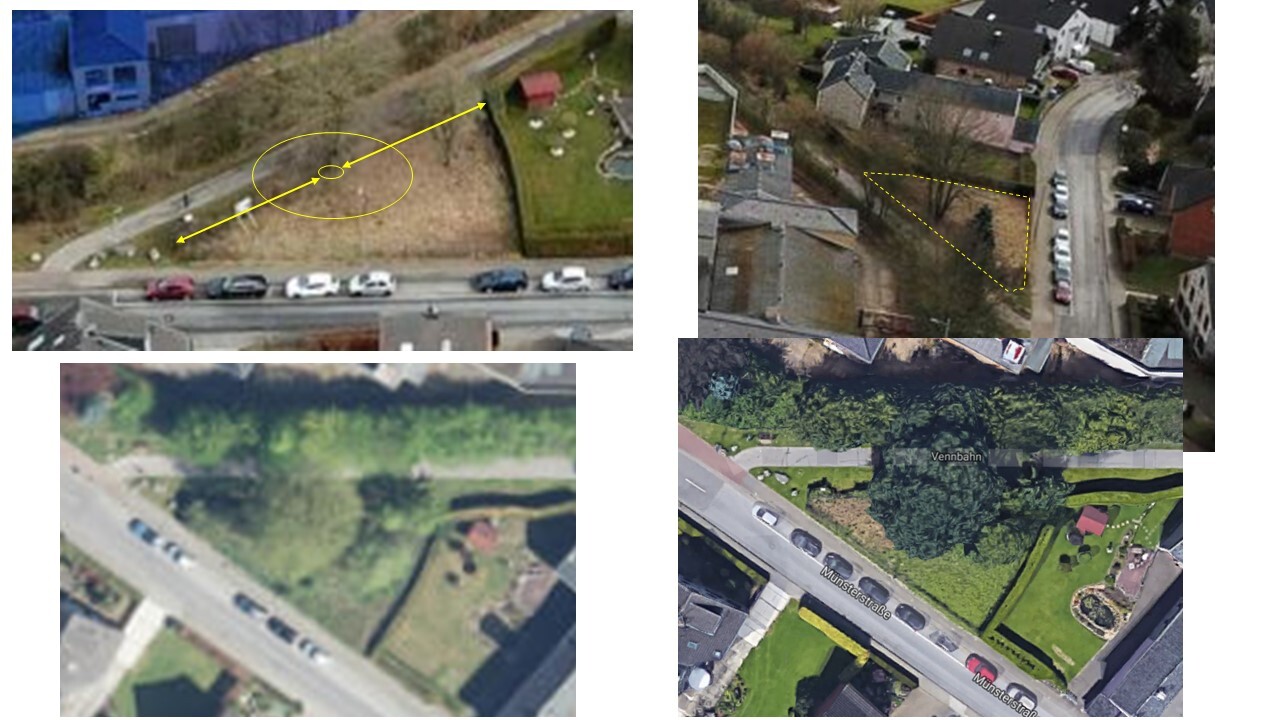

Hello everyone!
We have purchased a triangular plot of land. As if that weren’t complicated enough, there is also a large oak tree that must be considered during the planning. In our initial considerations, it quickly became clear that the floor plan will have an L-shape.
Does anyone here have experience with this type of plot and a correspondingly shaped floor plan? What additional information is needed to get meaningful advice?
Mottenhausen12 Nov 2018 13:33According to the photos, the oak tree is positioned almost exactly in the middle of the northern boundary. The first photo seems to have been taken under favorable winter conditions, but photo 2 clearly shows the three main trunks. Additionally, two aerial images from the Esri aerial data (bottom left) make it look quite severe; the oak must be enormous.

Under these conditions, the plot is not suitable for building Once again, I disagree. Your plan is too imprecise. The northern boundary is drawn too far north, and the scale is also too inaccurate. Let’s wait for a plan from the original poster.

Mottenhausen12 Nov 2018 14:27Escroda schrieb:
And again, I disagree. Your plan is too imprecise. The northern boundary runs too far north and the scale is also too inaccurate. Let's wait for a plan from the OP.Yes, even if the drawing is inaccurate (which it isn’t, but never mind), at best there might be half a meter (around 1.5 feet) more space somewhere and the house could then be 3.70 meters (12 feet) wide instead of 3.20 meters (10.5 feet).

is not Believe me, it is inaccurate.
Mottenhausen schrieb:
but never mind It does matter, because it’s not 50cm (20 inches) but 2m (6.5 feet).
Fine surveying of the batter boards ... is marked out to within 2mm (0.08 inches). So we are talking about a factor of 10³, which definitely matters when assessing buildability.
The plot is suboptimal for construction, no question about that. That’s exactly why the OP is asking for ideas here.
