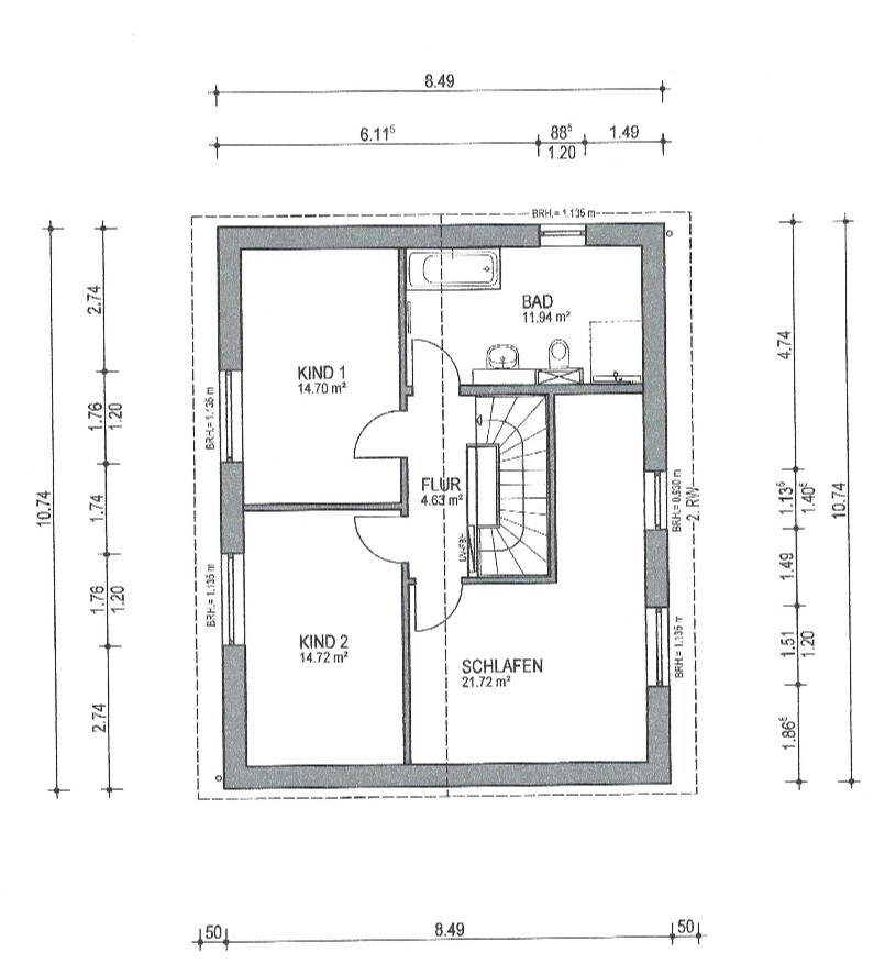

Hello everyone, we are looking for a floor plan for a semi-detached house!
Most semi-detached houses are long and narrow, but our building area does not allow that.

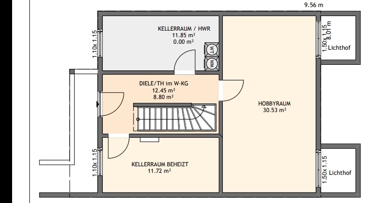

Basement: yes, floors 1.5 - 2

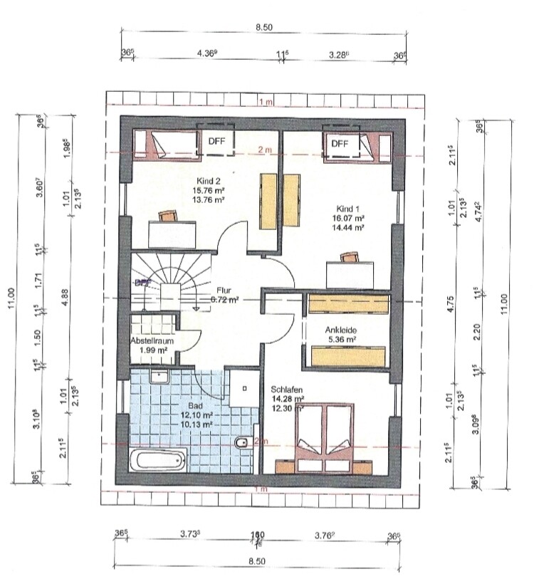

Upper floor: master bedroom, two children’s rooms, bathroom.

Requests / special features / daily routine, also reasons why this or that should or should not be included: we are open to everything, we want to build something that makes sense! It does not need to be large! We currently live in 102 sqm (1100 sq ft) plus basement and that is sufficient.
Who is responsible for the planning:
We do not have one yet! The plan below would be acceptable for us, but it needs to be made quite square. Has anyone worked on a similar project?
- Architect: We want an architect to help us but do not want to hire one unprepared.
- DIY: That’s why we want to gather as much input as possible.
What do you particularly like? To make full use of the building area, if possible. Why? So that there is not a 100-130 sqm (1075-1400 sq ft) house on an 815 sqm (8770 sq ft) plot, and we would like to have neighbors!
What do you not like? The 8.5 m (28 ft) width of the building area. Why? 10 m (33 ft) would be optimal for a nice semi-detached house.

The master builder house would be the most logical choice.
However, I would still change a few things. They offered us the house without a basement even though we mentioned it, and without providing a price. Nothing yet—I’m hoping something will come... but everything feels strange.

Fingerhaus: €337,000 for 170sqm (1,829sqft) with a finished basement and waterproof concrete shell. Timber frame construction with 773cm3 (approx. 2,000sqft) usable space.
Baumeister-Haus: €367,000 for 182sqm (1,959sqft) with a finished basement and waterproof concrete shell. 36cm (14 inch) lightweight concrete block construction with 867cm3 (approx. 2,000sqft) usable space = about €2,000 per sqm (sqft).
Massivhaus Mittelrhein: €318,000 for 140sqm (1,507sqft) with a finished basement and waterproof concrete shell. 36cm (14 inch) Ytong block construction with 662cm3 (usable space). Approximately €2,250 per sqm (sqft). I deducted the garage and facing bricks from the price to allow better comparison. For me, this is the best offer as it also includes the highest level of finishing.
