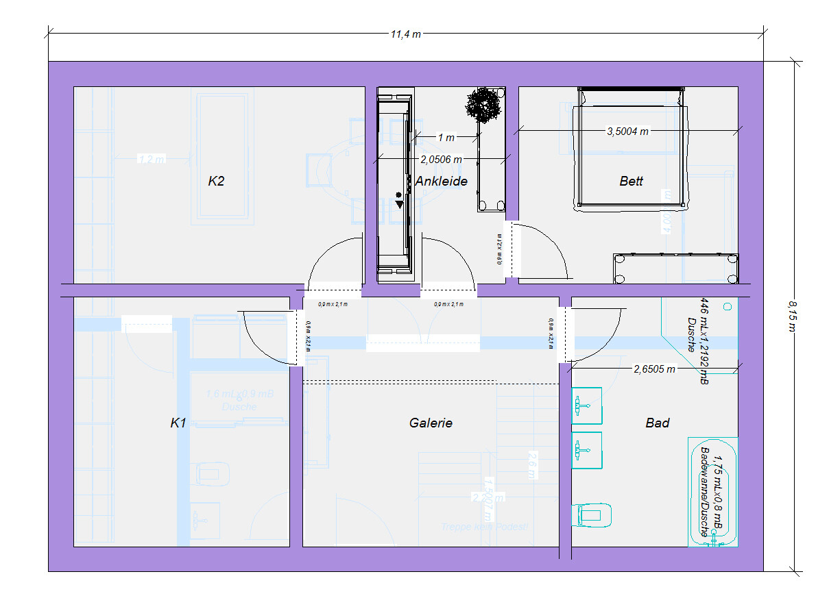

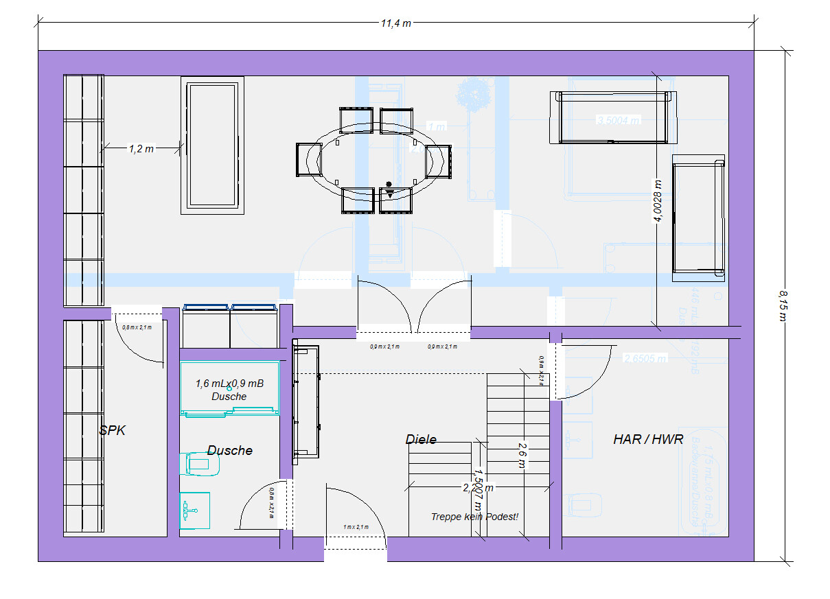

Here is a sketch for approximately the same floor area (93.8m² (1009 ft²)).
Since we don’t know anything about the plot, it might still be possible to mirror the layout so the children get sunlight.
The walk-in closet contains only a wardrobe; the other piece of furniture is a narrow sideboard to keep enough space for movement. The staircase does not have a landing!

@kaho674 ... definitely better ... but @Bizzy, what’s so difficult about adding a site plan with a north arrow?
Also, look at the front of your house and imagine being the child who would live there with those two floor-to-ceiling windows ... or lying in the bathtub behind those two floor-to-ceiling windows. What will be the consequence of these windows? There will likely be a need for solid privacy screening in the lower area, so it would make sense to design the windows with the appropriate sill height. Also, consider cleaning those large gallery windows.
What kind of room is this supposed to be on the ground floor? Between the bathroom and the living room?
