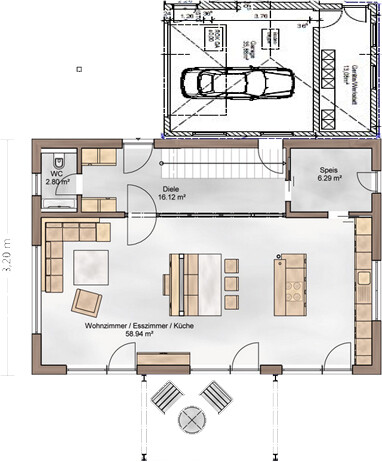

The floor plan is basically fixed, but for noise (street) and privacy reasons, we want to mirror the whole house so the garage, front door, bay window, house, and terrace are positioned from west to east.
Unfortunately, this has sparked many discussions because the plot was gifted to us by family whose house behind is slightly elevated (about 3m (10 ft), on the north side). They fear their house will no longer be visible from the south if we move the garage to within 2–3m (6.5–10 ft) of the western boundary. However, if we move it back 6–7m (20–23 ft) to where the current house corner is, there is about 80m² (860 sq ft) of "wasted space" between the boundary, street, driveway, and garage. Do you have any ideas on how to make use of this space or avoid it altogether without compromising the rest of the design?
The images still show the old version, as we will only redesign once we find a solution...

And honestly, I don’t understand the entire discussion about the access. It’s 6 to 7 meters (20 to 23 feet)... dear people, and you can even route it through the garage and come out right next to the front door.
This also gives you the option to create a nice spot in the southwest.

And I don’t understand the whole discussion about the driveway. It’s 6 to 7 m (20 to 23 ft)… dear people, and you can even route it through the garage to come out right next to the front door.I need to discuss everything thoroughly again with my partner. However, with the version rotated 90 degrees, you also have to consider that maneuvering is mainly required when backing out of the garage. Or you reverse onto the street.
Grantlhaua schrieb:
If I just mirror the layout, yes, but if I also rotate the garage [...] then the front door is obviously much further away from the garage door/driveway. I think we were talking past each other here. Maybe because after rotation you could approach the front door from the new driveway side on the west, or you could still go straight to the front door from the south, and only get to the garage side through the garage? – then just imagine a hallway running along the outside of the garage (in addition to or instead of the southern approach to the front door).

Grantlhaua24 Aug 2018 07:50kaho674 schrieb:
As I said, I would consider placing the garage as a boundary structure behind the house. It would be narrower (6m (20 feet)), but longer to accommodate garden equipment. House entrance facing north. Driveway marked in pink. The rest is garden.
Roughly sketched here:
We also considered this at the very beginning, but we don’t like it because we definitely want the front door between the house and the garage, and we also didn’t want a “narrow corridor”-style open plan.
Just adding a walkway along the outside of the garage (in addition to or instead of a south-facing entrance to the front door).What would the south access to the front door look like then? I understand having a walkway along the garage, but I can’t quite picture how it would work from the south side?

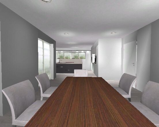

So, now my kitchen layout, direct storage, broom closet, vacuum cleaner, and so on.
Structural adjustments after mirroring the floor plan:
Tall cabinet wall in the kitchen from left to right:
Then a 270 cm (106 inches) long cooktop block at the window… the entire window row slightly boxed in at the height of the tall cabinets’ soffit. Here, a ceiling-mounted extractor hood can be integrated along with lights that have different switch settings, including options for ambient lighting:
On the left could be all the dinnerware with cutlery, the middle for cooking pots, etc., and the right side for remaining pots, cooking utensils, spices, and so on.
In front of that, a 270 x 110 cm (106 x 43 inch) sink/preparation/baking island, from the kitchen side, from the right:
The table is set here at 250 x 110 cm (98 x 43 inches), chairs with 55 x 55 cm (22 x 22 inches).
- 60 cm (24 inch) dishwasher
- 80 cm (31 inch) (or 90 cm (35 inch)) sink base cabinet with 1, 1.5, or 2 basins, no drainer. You can hide dishes in the sink if needed.
- 40 cm (16 inch) base cabinet with waste sorting system, top for organic/rest waste… by the way, what is the system you use for “yellow sack” waste? Bottom could be for oil/vinegar bottles
- 90 cm (35 inch) (or 80 cm (31 inch)) pull-out base cabinet for knives, kitchen tools, prep utensils, taller items in the lower drawer, etc.
- Back side of the island with three 90 cm (35 inch) wide base cabinets, depth reduced to 50 cm (20 inches), space for serving dishes, additional dinnerware, table decorations, etc.
