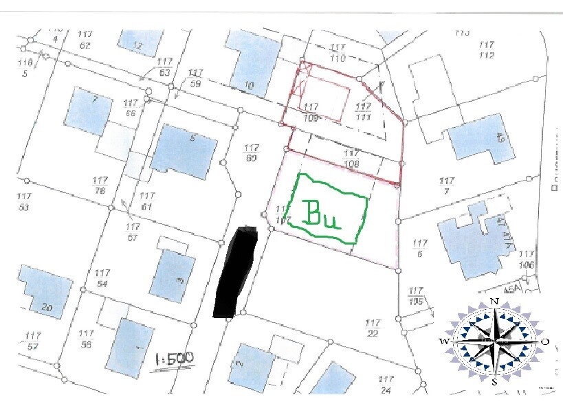

we have been offered a plot of land by a developer and would like to build our future home there. The plot is located at the end of a cul-de-sac in a traffic-calmed residential area (infilling development).
I should mention upfront that we have not yet received much information from the developer. We shared our rough requirements with him, and he has created a first draft, so far only for the ground floor.
It would be great if you could help us evaluate this early on before we progress too far in the planning and have to make major changes later.
The positioning of the house on the plot is due to the fact that all other options we considered would cast too much shadow on the rest of the plot.
The plot shown as undeveloped on the site plan has meanwhile been built on with a bungalow (marked). A carport will be constructed between the bungalow and our plot.

So when I look at the current weather situation... I really don’t understand why everyone always wants a south-facing terrace. We have one too, but more out of necessity. At least half of our decision was based on minimizing the amount of sun hitting the sides of the house.
Stege90 schrieb:
With this option, the space under the stairs, which is currently planned as a storage area/niche, would be added to the utility room. What would be the advantage of that? Or how could I use this room better there? As it is, I would have a sloped ceiling including a niche, which means I lose the chance for a full closet wall, or am I misunderstanding? Here is an example floor plan. Unfortunately, my software can’t represent this perfectly. The space under the stairs serves as storage and is accessible from the utility room without having to squeeze into a dark corridor beneath the stairs. Of course, if you prefer a full closet wall inside the utility room, this wouldn’t be possible.
Besides that, as currently drawn, the general contractor has senselessly placed the door on a constructed 45° corner wall, so no large closet could fit along the utility room wall anyway. But the plan isn’t meant to be taken seriously at this stage.
Müllerin schrieb:
So when I look at the current weather... I don’t understand why everyone always wants a south-facing terrace. We have one too, but rather by necessity. At least half of our choice was based on minimizing direct sunlight on the house sides...Because otherwise, we wouldn’t have such sunny weather like this year.
I wouldn’t focus too much on the ground floor itself, but rather try moving rectangles around on the site plan: sketch out where the rooms should or could be located. With a smart stair placement, the upper floor will naturally follow. I also think the builder intended it that way – just a suggestion for how it could be.
Personally, I would start by straightening the legs of the staircase so the dining room can be made wider. But that’s just theoretical, because the current design isn’t cozy at all. Planning level 6! Just extending the dining room into the kitchen.
I also don’t like when the front door can only be accessed through the carport. It feels hidden, uninviting, and if a crowd of kids comes over, I would worry about my car.
I can imagine it being more attractive to place the garage along the southern boundary of the plot, possibly further forward, with the sunny south garden behind it (south-facing windows and a narrower plot), and a larger garden area on the west and north side, each with their own terrace.
So: I would just start moving things around myself.

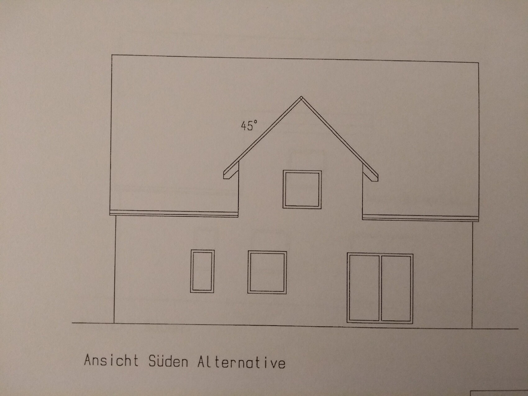

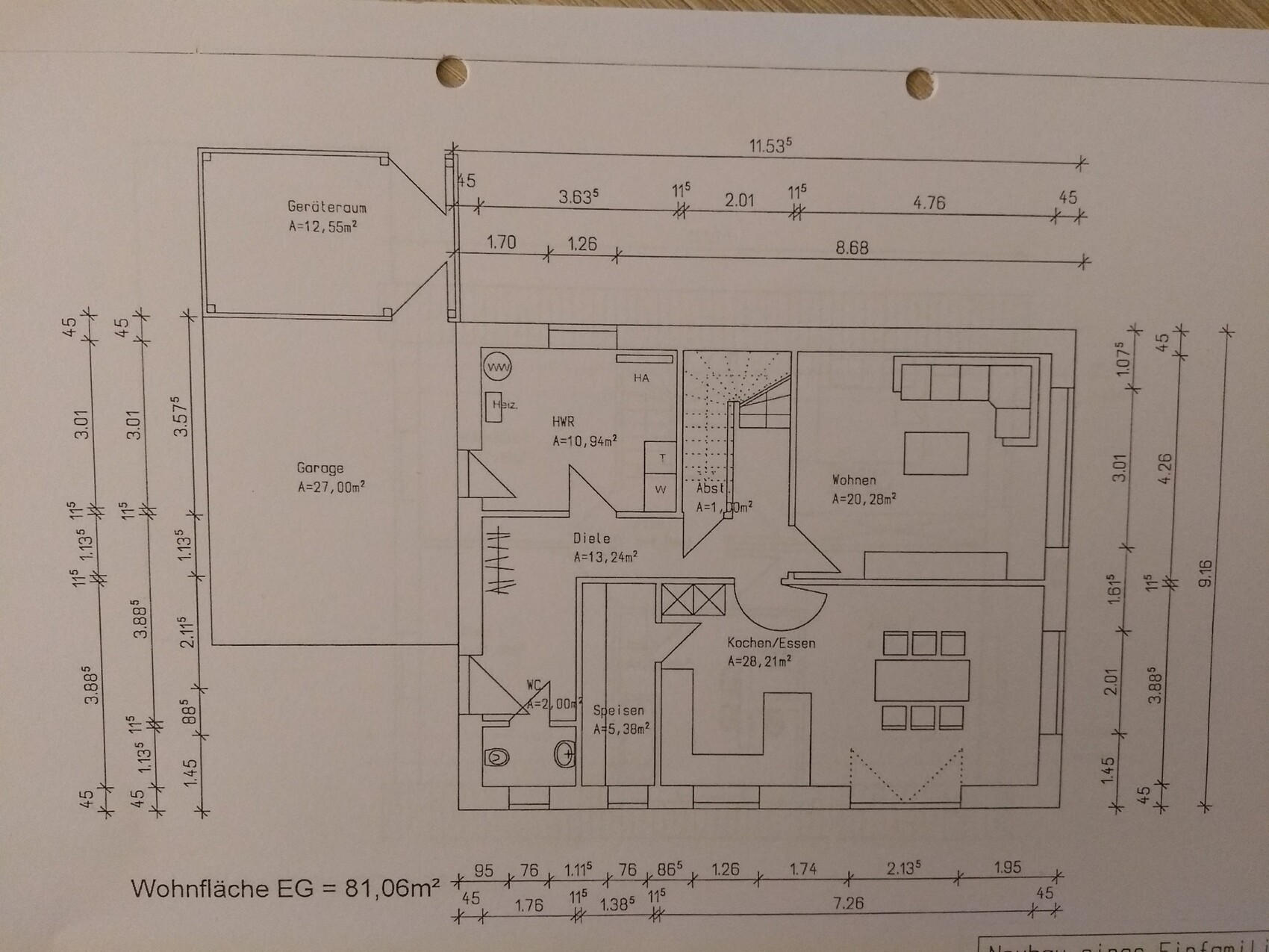

We have now received a revised floor plan for the ground floor and an initial one for the upper floor from the builder.
We currently prefer this floor plan over the alternative proposal. We are uncertain about the small guest toilet.
Alternative proposal:
We would probably assign the storage room under the stairs to the utility room.
The exit of the garden shed (currently facing north) will have to be redirected towards the east (right), since we have already reached the property boundary to the north.
Upper floor plan:
We are considering swapping the bathroom and the office/guest room. What do you think about that?
And here again is the (old) site plan. The house location on the plot remains the same; it will just be shifted further to the right (larger garage/carport + bigger house):
I hope this time there will be more approval since the complete floor plan is now available. Nevertheless, please feel free to critically review everything.

Stege90 schrieb:
We currently prefer this floor plan over the alternative proposal. We are uncertain about the small guest bathroom. The bathroom fits, but the bent (Z-shaped) path through the hallway wouldn’t be my choice. The upper floor serves its purpose, but the elevation looks oddly outdated.
An open-plan kitchen and living room combined with a separate sitting room totaling 48 square meters (516 square feet) is surprisingly spacious for such a small cottage-style house, but it still warrants reconsideration for a better layout.
I don’t believe in the 11.5 cm (4.5 inch) interior wall thickness. Where exactly do the 45 cm (18 inch) exterior wall thicknesses come from?
Overall, the design appears much more coherent — but have you taken my “high” opinion of the builder seriously?
Stege90 schrieb:
The location of the house on the lot remains the same; it will only be shifted further to the right (larger garage/carport + larger house): Try drawing the house there. If the storage shed is directly on the boundary, the setback on the upper right side (at the corner of the sitting room) seems questionable.
