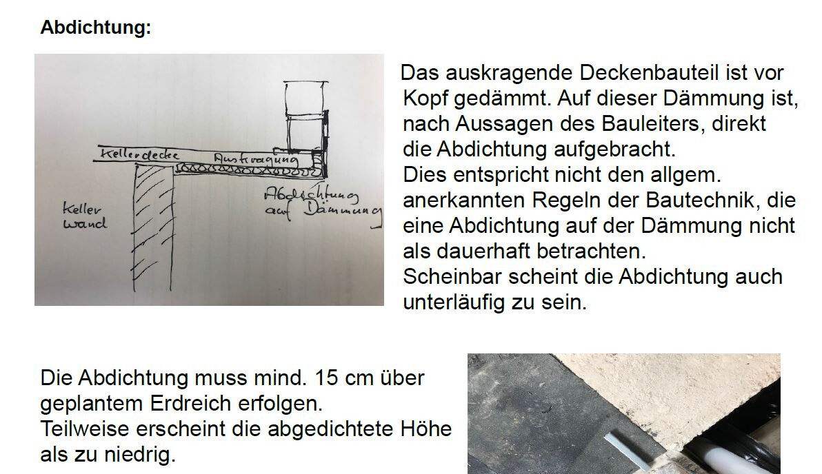

R.Hotzenplotz23 Jul 2018 19:37The general contractor (GC) said they would correct the base waterproofing upon request and carry it out according to the relevant DIN standards. However, they also said they could not guarantee it would be watertight and that I would have to sign a document acknowledging this. I don’t understand why I should sign something if the work is done according to DIN standards.
Currently, it has been executed as is.
The expert says they cannot officially approve leaving the work in its current state. I specifically asked how they would handle it if it were their own house and they were in my position. They replied that, in the interest of the construction process, keeping the non-DIN-compliant execution could be considered if I receive a 15-year warranty, which would be possible.
Now I’m completely unsure what to do.
Regarding the windows, as expected, the expert did not want to comment much. They said the current threshold height from the raw floor level to the patio doors, which is about 36–38cm (14–15 inches), will in fact be reduced to 15cm (6 inches) after installing the screed and flooring system. This is due to tolerances in the structural shell, the screed, and a so-called “meter crack” (?) that the tradespeople use as a reference.
I had always assumed 16cm (6.3 inches) of screed plus maybe 1–1.5cm (0.4–0.6 inches) of parquet flooring, and that would be it.
The expert believes these are just defensive statements and can’t imagine the threshold really being as low as 15cm (6 inches).

I don’t think it complies better with the DIN standard to excavate it again. I won’t explain the threshold again; it will be more than 15 cm (6 inches) from the inside, especially regarding the effective floor lifting height.
