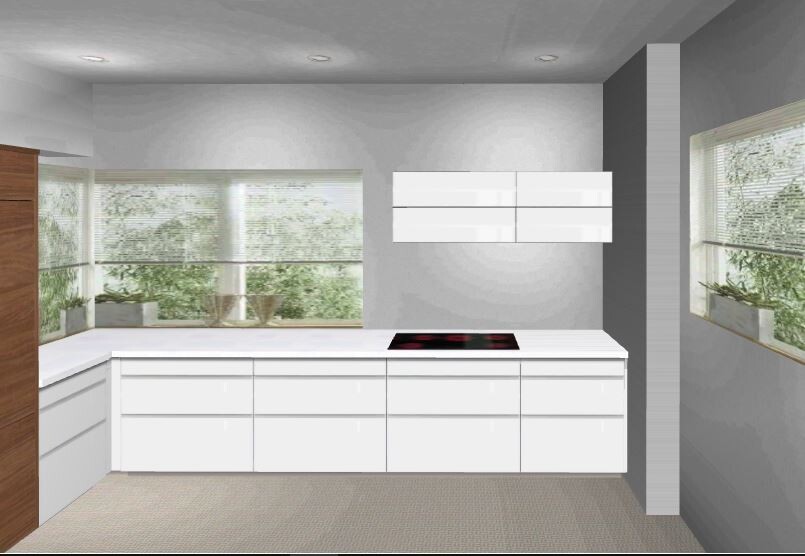

This really reminds me of your comment that you expect to sell the house again in two years. For me, there are gradually too many serious issues for me to imagine living like this in the long term. I already hate this house! It’s been ruined beyond repair. Clearly, several people involved completely failed in their jobs. How can anyone plan a wall like that in the kitchen?
I have no idea what exactly I should now tell the electrician based on that.

A question regarding improving the look of the kitchen: are the upper cabinets absolutely necessary? Is there otherwise not enough storage space? If not, I would consider leaving them out entirely. As shown in the picture above, they no longer appear symmetrical and look like an awkward attempt rather than a deliberate design. It would be better to leave them out.
Do you have a downdraft extractor, or was an extractor planned inside one of the upper cabinets?
If a standard extractor wasn’t planned, then I would opt for a good lighting solution and omit the upper cabinet. That way, the boxed ceiling section won’t be as noticeable.
Personally, I would also prefer it without the boxed ceiling section.

Phew, feeling hatred towards the new house and having to spend a lot of money on it. A really unfortunate combination.Yes, with some luck, the shortage of land might put us in a situation where we can sell later and come out with only minor losses. For example, we had friends visiting who didn’t understand why little things like the small patio doors bothered me so much. Apparently, some people simply don’t pay much attention to details, no idea why.
Climbee schrieb:
Do you have a downdraft extractor, or was an extractor planned inside one of the upper cabinets?Extractor in the upper cabinet.
Climbee schrieb:
Question about visually improving the kitchen: are the upper cabinets absolutely necessary?I need to look at it calmly; everything was planned in detail. And now none of it is feasible. Right now, I’m just fed up and don’t feel like dealing with it anymore.
What I find hard to believe is that both experts said this is normal?
Does that mean you have to accept it? That pipes are either visible everywhere or need to be boxed in?
Yes, built-in wall sections are common in bathrooms, but surely not in the kitchen?
