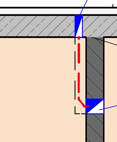

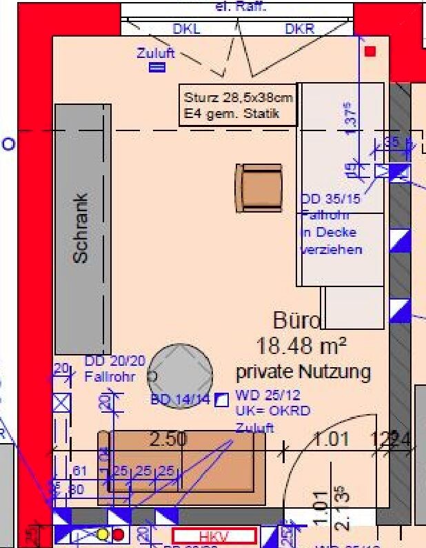

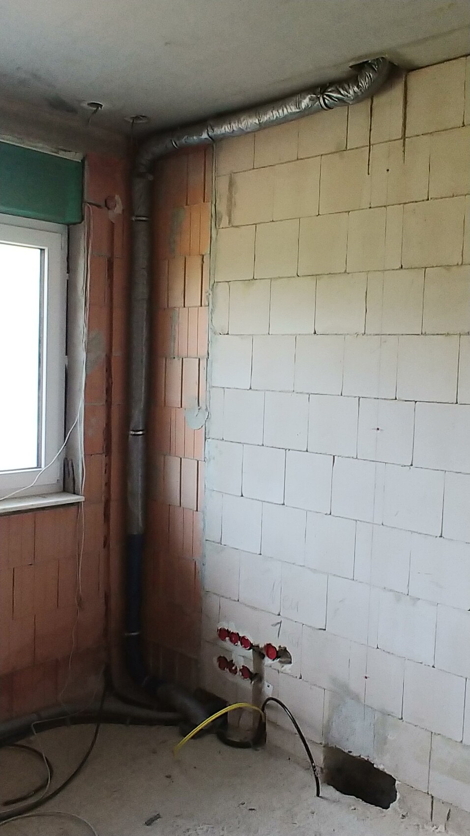

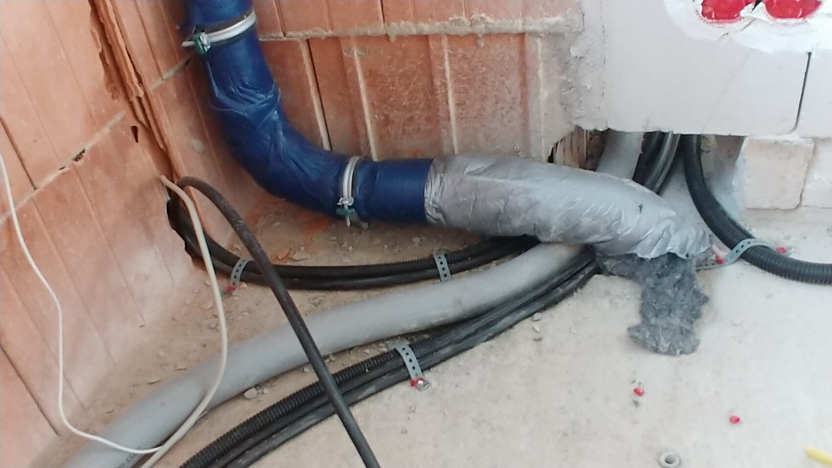

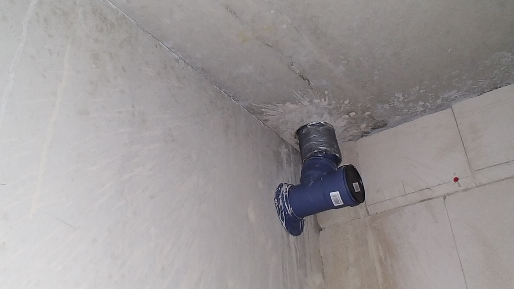

R.Hotzenplotz28 Jun 2018 19:19I’m relieved that on Monday I will finally get—hopefully competent—professional support!
The pipe in the office has meanwhile been so badly altered. It now fits perfectly with the ceiling lights, and it just looks awful! I will immediately lodge a formal objection again in writing.
Here it is shown again how it should look. Office and the guest room below it.
It’s really hard to tell whether to laugh, cry, or just remain stunned by what liberties have been taken here. Apparently, they have missed the mark by miles in their profession.
