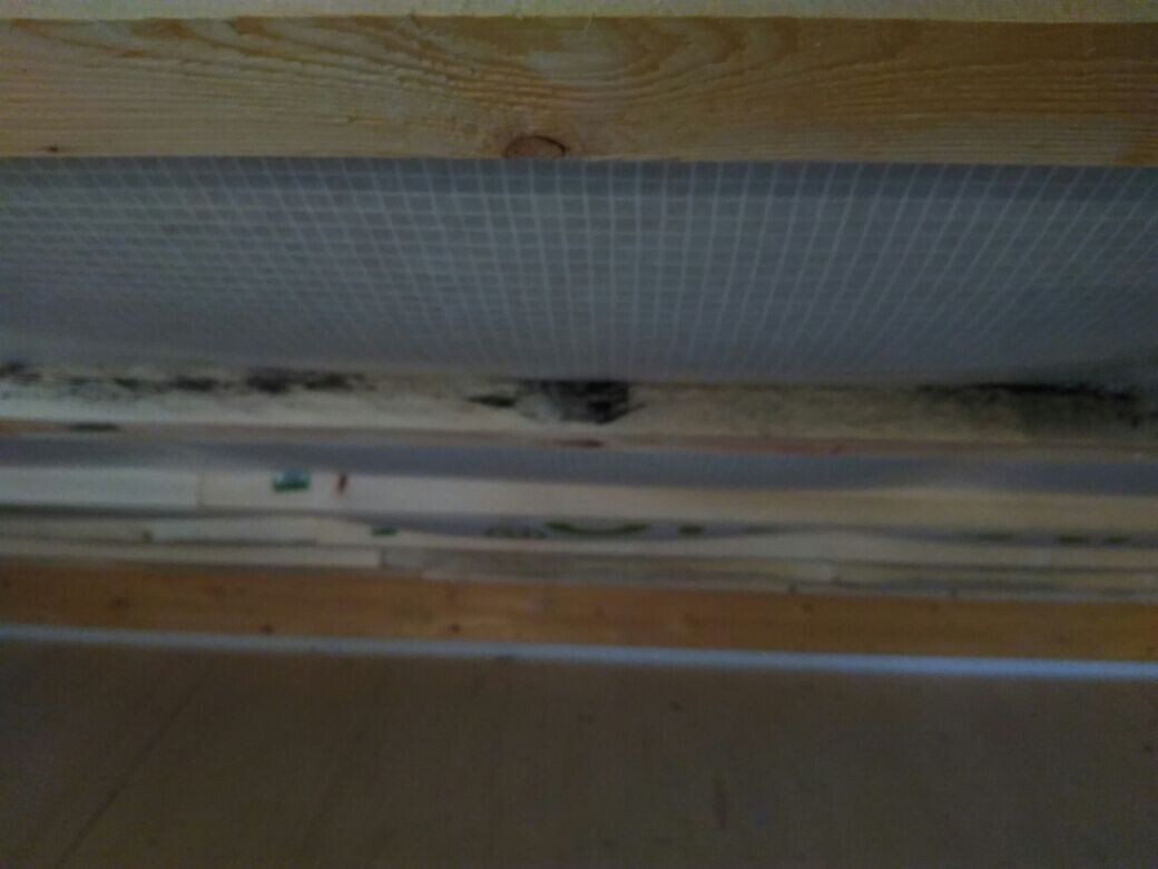

This morning we wanted to put the trampoline in the attic and discovered there are many small mushrooms living there.
Reinforcing steel without rust must come directly from the factory and be sandblasted again on-site. A little surface discoloration is not a problem; it’s only superficial.

haydee schrieb:
That little bit of discoloration doesn’t matter, it’s only on the surface. We wanted to put the trampoline up in the attic this morning and found lots of small mushrooms living there Those aren’t cultivated mushrooms and need to be removed :-(
That means excising the material they’re growing on.
