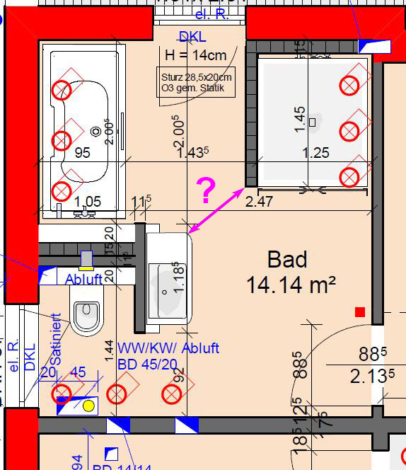

Hi!
What do you think about this master bathroom layout?
We didn’t really want the shower to be so hidden since we plan to outfit it in a high-quality and stylish way. It would be nice if it could be more visible, not just for showering. But during the plumbing planning, we were advised to keep it like this (because of the water pipes).
What’s your opinion? Or does anyone have an idea on how to create more visibility into the shower?
The two washbasins are marked incorrectly. We will only use one washbasin (1m wide (39 inches)). Our idea is to move the bathtub to where the washbasins are currently shown and place the washbasin on the right wall instead. We want the bathtub to have a prominent spot in the room instead of being “in the corner” when we bathe.

Just a quick note:
Is the toilet side facing the street? And how high is the window there...
We have the same setup, it doesn't bother me, but some visitors are quite shocked when they can see out from the toilet...
However, we haven't moved in yet, and the lower part of the window will be frosted with a film.

R.Hotzenplotz14 Mar 2018 09:41The window opens sideways. Of course, the panes are frosted! I would never consider installing a window next to the toilet without frosting – no matter which way the window opens.
Now you have the tight space between the shower and the sink every time you want to get to the bathtub:
I still believe a shower width of 1 meter (39 inches) is more than enough.
By the way, I’m really glad we chose a glass wall for the shower. Everything else feels really claustrophobic. I’d rather replace the glass when it’s worn out.
R
R.Hotzenplotz14 Mar 2018 11:21I am no longer exchanging anything. Shortening the shower would still be possible during the shell construction phase.
I would make the shower narrower. 1m or a maximum of 1.1m (3.3 ft or 3.6 ft), so the walkway becomes wider, and in my opinion, a wider shower does not provide any additional comfort. If it remains a walk-in shower, I would rather try to make it 20cm (8 inches) longer. Alternatively, you can easily add a glass door later if you notice that the bathroom floods every time.
