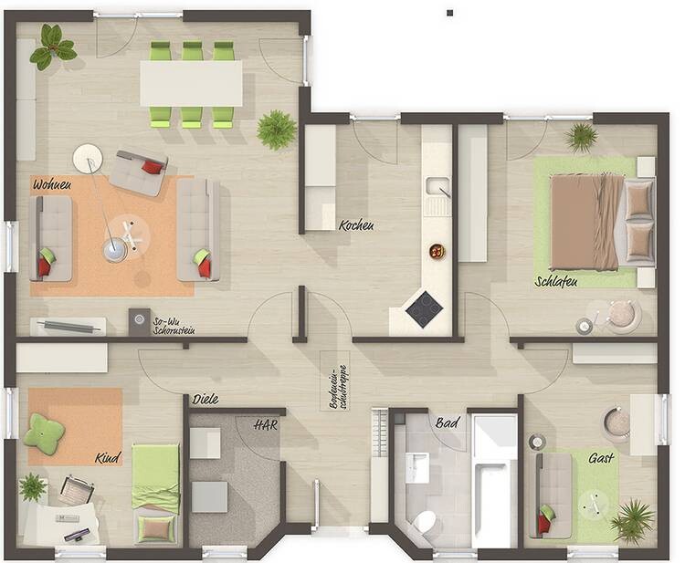

we are planning to build the Winkelbungalow 108 from Town & Country.
I see three main issues:
1.) Bathroom
The bathroom is too small. There is no space for a cabinet, and I would prefer a large shower. Town & Country suggests relocating the bathroom to the guest room. That works perfectly since we don’t need a guest room.
2.) Kitchen window
The kitchen window is too small. Town & Country can install a larger window here. The cost is reasonable – perfect.
3.) Passage between kitchen and living room
We don’t want an open-plan kitchen but would like to have a passage to the dining area. However, the way Town & Country arranged it (a passage without a door) is not very practical since activities in the kitchen disturb people in the living room. Installing a door there doesn’t really make sense either, as it would create three doors close together that would interfere with each other.
Do you have any ideas for designing the passage or the kitchen? Or has anyone built this bungalow and can share tips?
Best regards, Afralea.

Uh, links are not allowed, and your link includes not just one floor plan but several variations. So it is difficult to understand what you mean. ...
I find it hard to understand how people in the living room could be “disturbed” while someone is working in the kitchen. Please explain that.
Does Town & Country not offer any custom modifications?

I have now uploaded the image as an attachment. Image source: Town & Country Haus Lizenzgeber GmbH, downloaded on March 11, 2018.
The kitchen is separated from the living room only by an open passage. It is only about the acoustics! Odor should not be an issue since we will install a very good exhaust ventilation system. When the blender or kitchen hood is running, people in the living room are disturbed.
I find the house beautiful and very well planned, but this aspect bothers me.

chand198611 Mar 2018 08:26Hey, a few questions:
1) Is there a floor plan available with dimensions?
2) How will the house be oriented on the plot (north-south-east-west)?
3) If you replace the guest room with a bathroom, what happens to the former bathroom? How is the resulting space distributed within the house?
Regarding the kitchen: At first glance, I would suggest a proper door from the kitchen to the living room and no door to the hallway. Instead, have an opening from the hallway to the living room. Problem solved...
I see it more like this:
The former bathroom would become my new laundry room and pantry.
chand1986 schrieb:It would be inconvenient to have to carry groceries through the living room first.
About the kitchen: At first glance, I would opt for a proper door to the living room and no door to the hallway. Instead, have an opening from the hallway to the living room. Problem solved...
