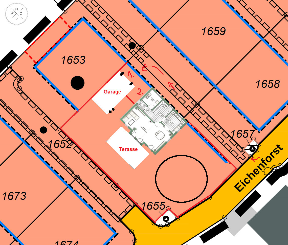

I’m not doing anything with Paint [emoji2] The drawing is attached.
With your plan, you can only orient yourself by the path and the road. So you are rotating your drawing... (for you, the path is in the south instead of the north!?) and (not just) for me your garage is in the west [emoji848]
pp1203
9 Feb 2018 17:54
I created a sketch to show our idea. With this layout, we would have the terrace on the west side and partially on the south side, and the entire garden area (lawn) on the south side. Parking space No. 1 would be in front of the garage, and parking space No. 2 next to it. The proportions are not accurate, but I just want to illustrate our idea.
In the version proposed by kaho674 and the general idea of placing the house exactly on the other side, we would have the large garden area and terrace on the west side. Wouldn't this block the entire south side with the house? The house would also cast a shadow over the garden area. I don’t understand the purpose of this variant.

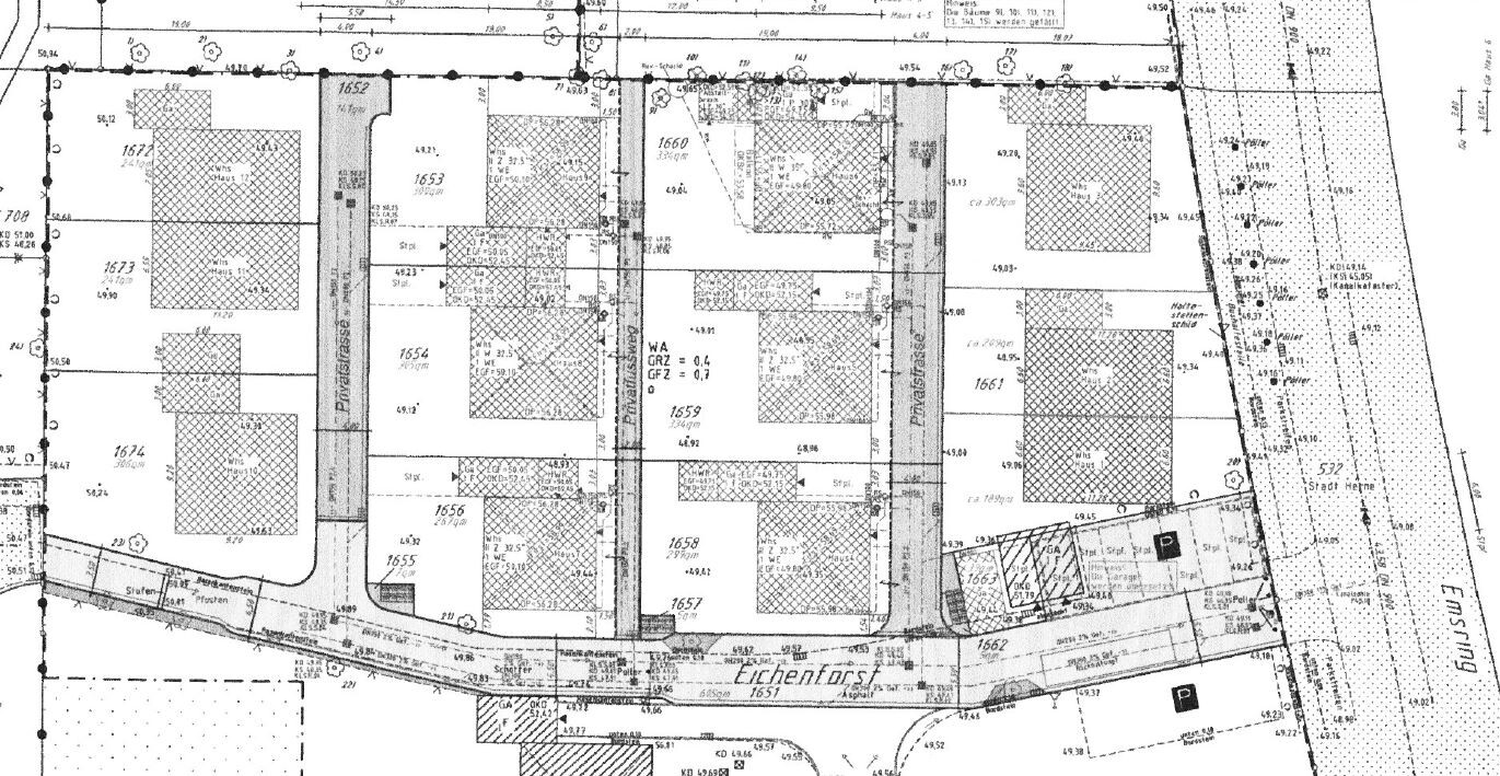

PS: Attached is a larger plan from the land seller, who will also be responsible for the development work. In his drawing, the houses are also placed in the corner as we propose, with the main entrance on the side of the pathway. Originally, though, two houses were planned on our plots.

kaho6749 Feb 2018 18:36
The main idea is to shield the garden from the main street using the house. No one could have guessed that it’s a dead-end street. And probably no one expects it to stay that way.
Secondly, I assumed that access would be via the other two adjacent streets. I can just imagine your neighbors’ reactions, all of whom stick to the pedestrian zone, while you are the only one widening it and driving in and out. They won’t be happy that the safe path for the children will now also be used by cars.
True shade is only on the north side. The sun moves throughout the day. A south-facing terrace naturally gets the most sun—though not always ideal—but if the street is that quiet, I would probably arrange it that way as well. Still, I wouldn’t expand the footpath. That would be really uncomfortable for me.

However, the dead-end will remain in place in the future as well. When the city created the development plan, the residents living at the end of the street called Eichenforst raised objections to extending the street further. They had no issues with a residential area being built there, but opposed the road itself. If the street were open, many people would use it as a shortcut instead of driving around. As a result, the residents managed to have the dead-end established as a condition with the city for allowing the construction in Eichenforst.
Therefore, Eichenforst remains a public street ending in a dead-end, while the side streets are private roads belonging to the houses. These private roads only extend to the end of the properties and are also dead-ends. The private roads serve solely as access routes to individual homes. Overall, this means there will be very little traffic in the area. The Emsring is also not a main road. The main road is one street further away... and from there you hardly notice the new development at all.

I’m afraid I have to disappoint you: the way you have it drawn won’t work.
Site plan of a building plot with garage, terrace, and building layout.
Here you have a tiny house on a 19-meter (62 feet) wide lot.
You have a 5-meter (16 feet) setback on the south side and 1.5 to 2 meters (5 to 6.5 feet) on the north side (who comes up with this „up to“?).
With that layout, a terrace as you’ve drawn it won’t be possible.
First, think about the driveway and grab a pencil and graph paper if you’re struggling with the proportions. [emoji2]
