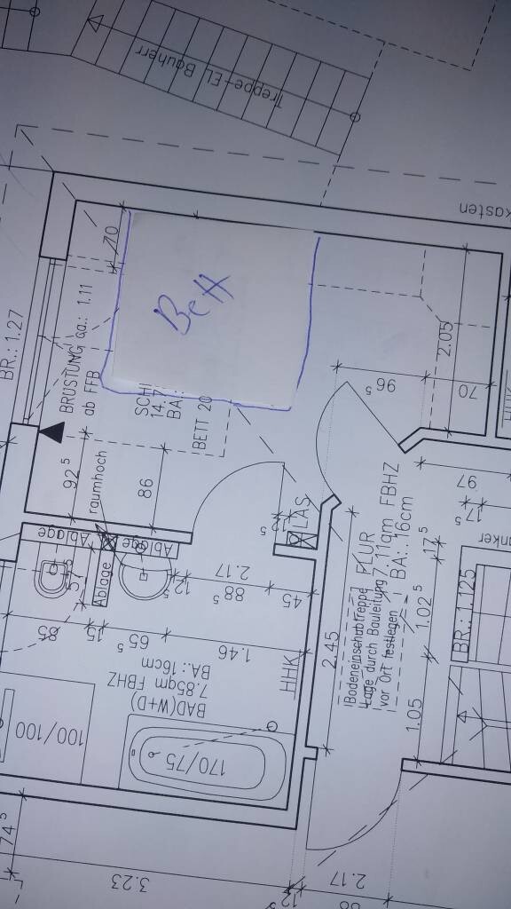

Arifas schrieb:
How would you solve the issue with the washbasin/partition wall/cramped toilet? The sanitary fixtures can’t be moved any further...
I would plan the bathroom door as a sliding door, which would slide into the wall on the bedroom side. This door would then be placed as low as possible according to the floor plan. That way, you could still gain the last few centimeters for the washbasin, etc.
At the moment, we have sizes ranging from 80 to 152 all mixed together. So, I’m not sorting anything out, just putting it away in the next wardrobe [emoji6]. But yes, eventually, they won’t grow at the same pace anymore, so my husband will have to run back and forth more often. But that can’t be changed now...
For now, I’m still storing the summer clothes in boxes on top of the wardrobe.
[A partition wall is for privacy! There are two of you... Your words: a retreat for the two of us. Any questions?] We actually just don’t want to see the toilet while brushing our teeth [emoji23]. So the current layout is rather unfortunate.
A sliding door is worth considering. Unfortunately, I don’t know what kind of pipe that is. However, a sliding door would also take up wall space in the bedroom, which would be a pity.
Here is a photo showing how far along the room planning is at the moment
