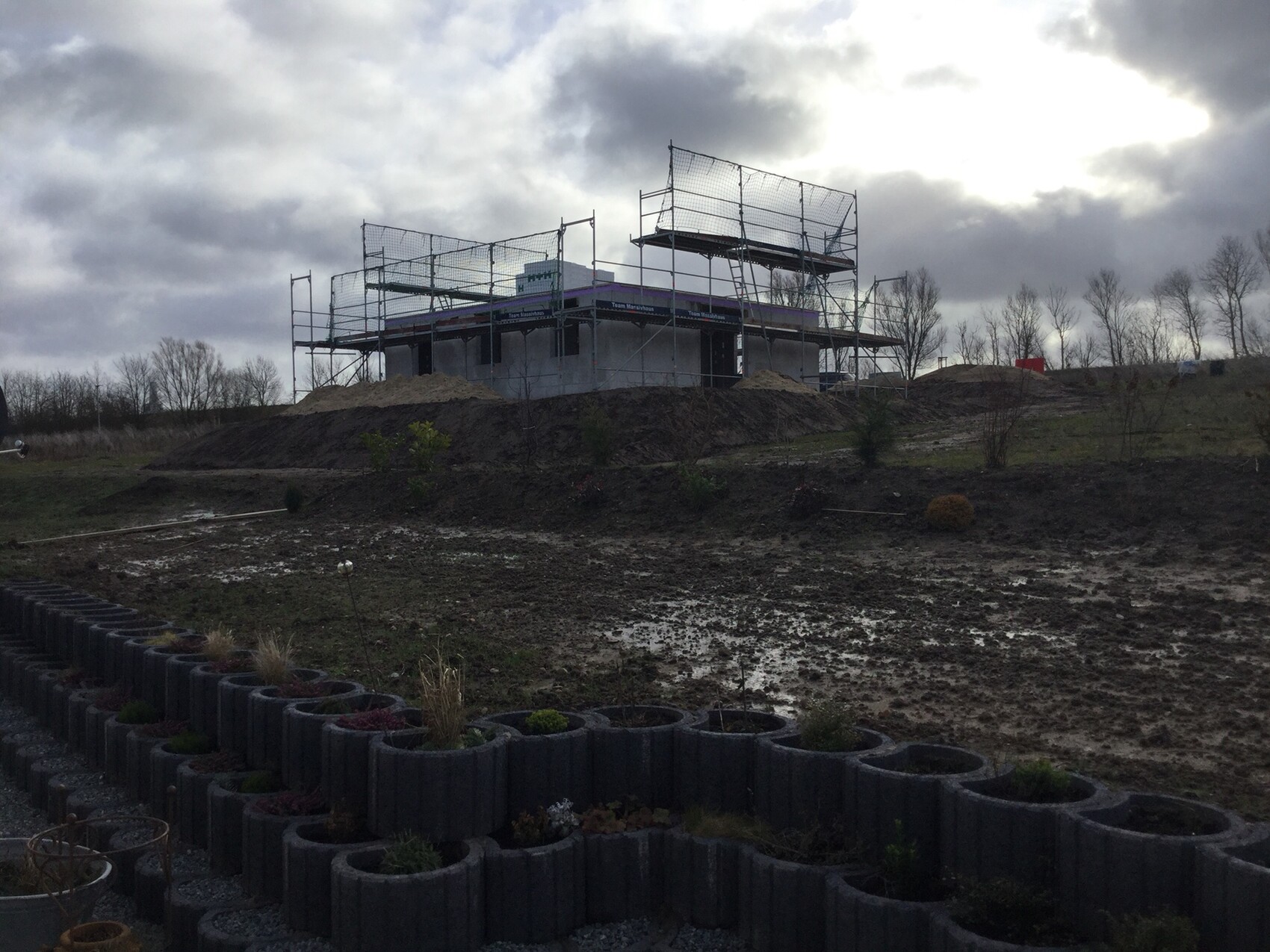

Nordlys schrieb:
Both of these houses were only started in December. Karsten
Amazing... that really overwhelms me. [emoji52]
