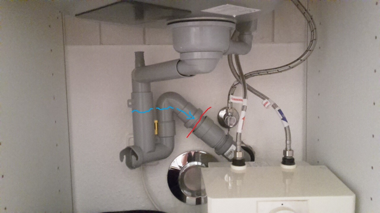

I’m not building a house, but since I couldn’t find a better forum, I hope you can still help me.
Here’s the situation in the kitchen:
- I replaced the sink and the trap
- Since then, the water drains very slowly (a full basin takes 2-3 hours to empty)
- If water is poured directly into the wall drain, it drains normally
- If the trap is not connected to the wall but drains into a bucket, the water also drains normally
- Before the renovation, everything worked perfectly
What am I overlooking?
Thank you very much for your help!

Thank you for your reply. At which point would the water need to flow upward?
It’s possible that I’m misunderstanding the function of a trap. I’ve marked the water level in blue. The level inside the trap is equal, then water is supplied from the basin, causing the level to rise until it reaches the overflow on the right, and the water flows downwards into the wall drain.
If the water were supposed to flow upward anywhere, no water would come out when I disconnect the system at the red-marked line. But it does. The water also drains normally when I pour it directly into the wall drain. So clogging can be ruled out.
This is not a DIY construction but prefabricated parts sold by a well-known furniture store, assembled according to instructions. If it didn’t work due to the cross-sections, there would definitely be more complaints online, and the siphon would no longer be available.
