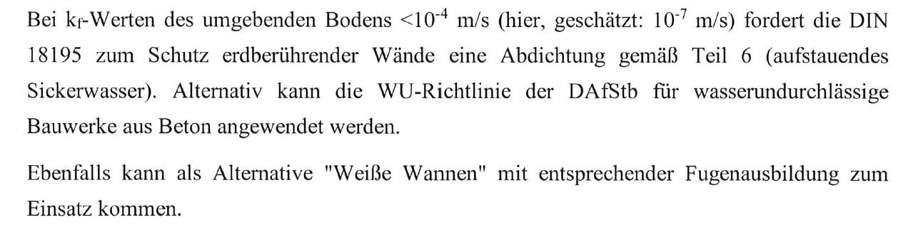

R.Hotzenplotz17 Jan 2018 09:22Yes, we also need a light well for the basement window, which must be constructed to be waterproof against hydrostatic pressure.
The report does not explicitly refer to a waterproof concrete tank (white tank system), but it is worded this way (see attachment).
However, it was always assumed that we would build a waterproof concrete tank. I need to clarify where this possible misunderstanding comes from.
