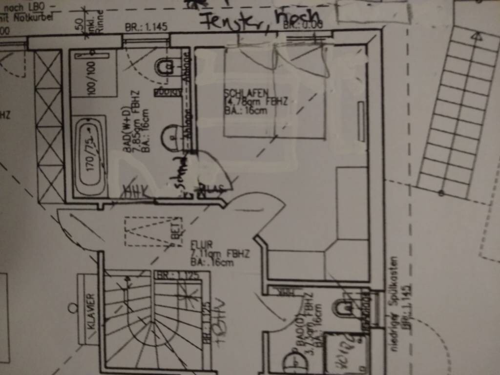

I am still very unhappy with the master bathroom because you have to pass through it to get from the hallway to the bedroom, which is the main traffic route. Unfortunately, the architect didn’t have a solution for this.
Now that the building permit / planning permission has been approved and the detailed construction drawings are scheduled for next week, I’ve just come up with a solution. Annoying, really.
Do you think it’s technically feasible to implement the following?
We understand that it will incur additional costs. We are planning to use the small remaining allowance in our selection buffer for this.
Arifas schrieb:
Now that we have the building permit / planning permission and the preparation of the working drawings is scheduled for next week, I've just come up with a solution. Annoying that it took this long.
Do you think it's technically feasible to implement the following? In my view, this is a typical structural element. Congratulations on the idea coming in time—I would go ahead with it.
