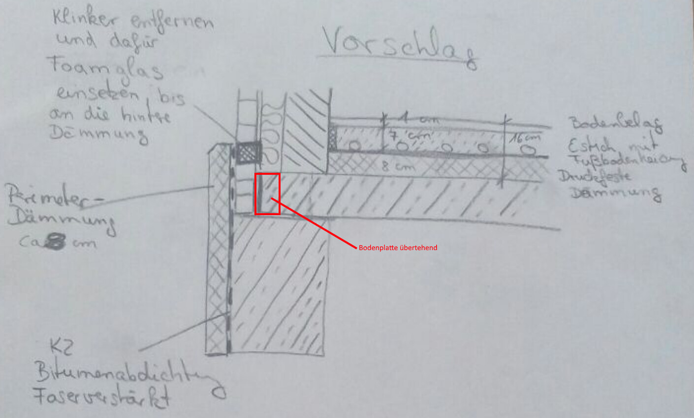

2) Most of the construction defects are not severe enough to require complete demolition. Only the base detail, specifically the oversized concrete slab, is problematic:
- The report states that the brick facing needs to be removed, and the concrete slab must be professionally cut back and receive a better coating before reinstalling the insulation and façade. (This is to prevent rising damp and thus mold formation)
The expert himself already mentioned that other measures might compensate (the report only concerns restoring the originally agreed condition), but he is currently on vacation, and an engaged architect supports the report’s argument and refuses to give us the "stamp" the bank requires before releasing the funds again. (which I can basically understand) – this unsettles us, because the costs for the defect repairs (about 15,000 euros (approx. 16,500 USD) plus new purchase and installation of bricks) pose an almost insurmountable challenge.
Interestingly, I have spoken in recent days with several architects (without the mysterious "stamp"): none of them see the problem as so serious that the concrete slab absolutely must be cut back. The energy consultant also said that the installed membrane under the screed layer should actually prevent moisture from rising.
Attached is a proposal from an architect suggesting removing only one layer of bricks and replacing it with foam glass blocks, which we could basically do ourselves and would be significantly cheaper for us. (about 3,500 euros (approx. 3,850 USD) plus own labor)
What do you think (those familiar with this topic)?
Are there possibly other measures we could take to avoid having to remove the entire brick facing?

Based on your drawing, I do not expect any damage resulting from the foundation slab not ending before the insulation.
