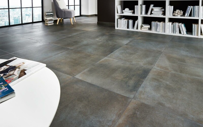

Attached are two examples that do not appeal to us:
Modern bathroom with a freestanding white bathtub, gray tiles, and black sink.
Modern living room with large square floor tiles, cozy armchair, and bookshelf.

KlaRa13 Sep 2017 08:35
Hello questioner.
Screeds are primarily designed to act as a load distribution layer. This applies to all types of installation except for bonded screeds. Also, the screed surface must always be protected. In residential construction, this is done with a floor covering; in industrial construction, with a surface protection such as sealing or coating. This is why so-called “exposed screeds” are expensive. These screeds meet several requirements that other screeds either do not have to meet or cannot meet.
If the new floor covering you have in mind should not show grout lines, then none of the covering tiles visible in the attached photos can fulfill this requirement. Anyone who does not see the joints must have their eyes closed.
These large tile formats will certainly be fixed onto a carrier material. This means a very high flatness of the substrate is mandatory (this must be paid as an additional service).
