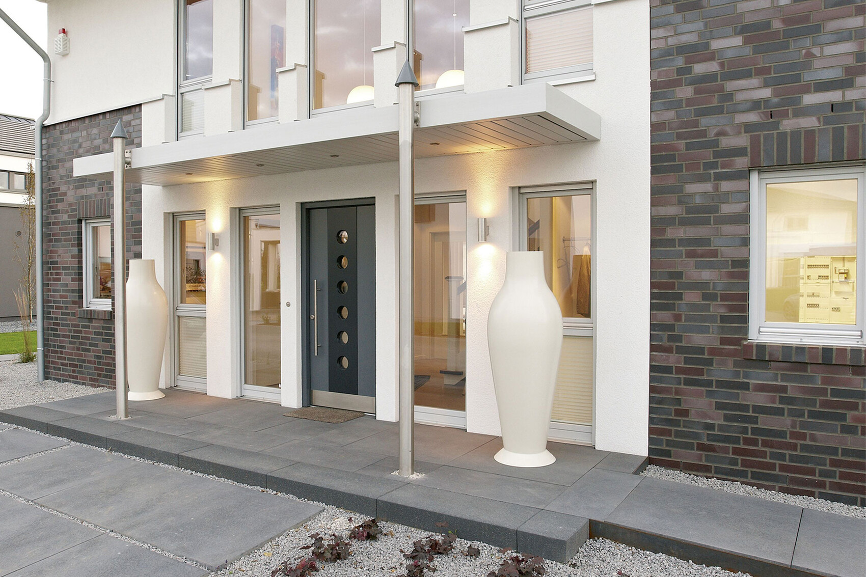

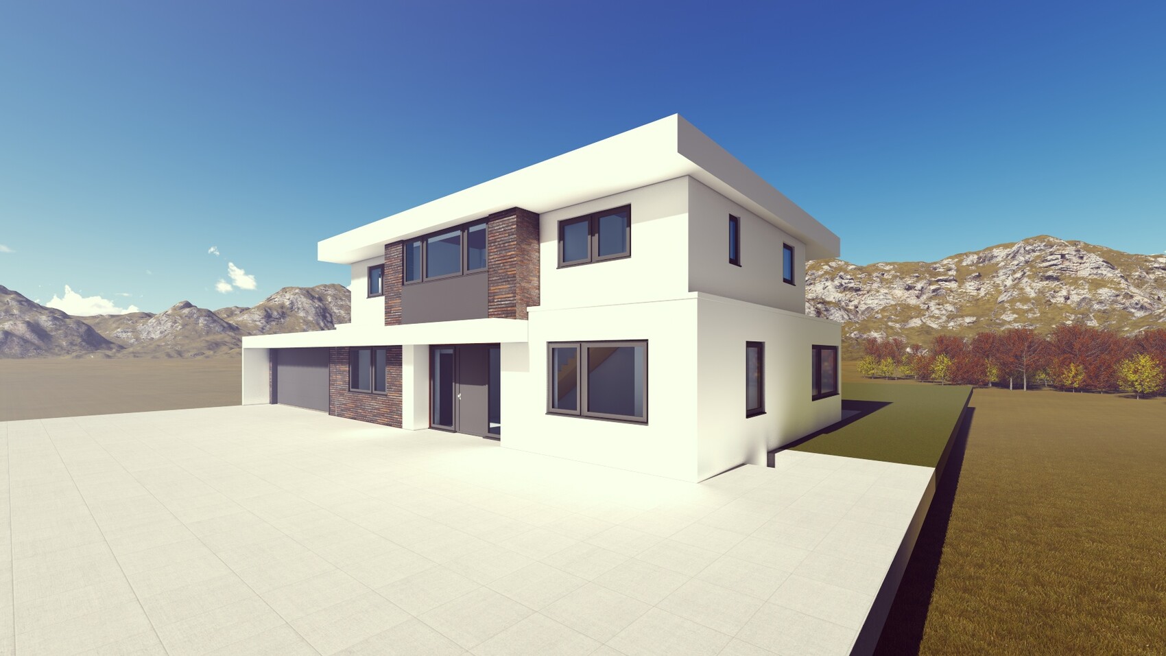

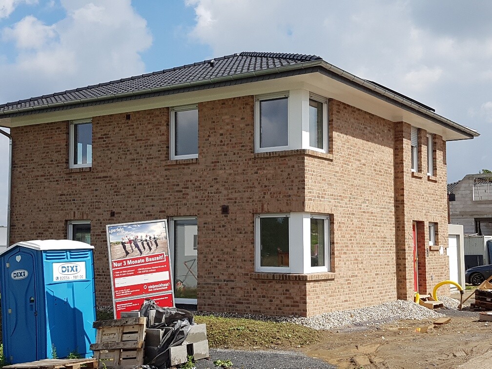

R.Hotzenplotz16 Aug 2017 13:05We have now also found a stylish brick during our visit to the show home park on Sunday. However, we are still looking for alternatives.
The question is how timeless this will ultimately be... but plain white or colored plaster isn’t really our style.
My wife also liked the brick in the second picture, but I find it a bit old-fashioned.
Otherwise, the project is currently on hold. We will meet again on August 24th when the supplier returns from vacation.
winnetou7816 Aug 2017 13:18Attacking you as well, the first picture shows a shopping center from the 1990s, this is what the brickwork looks like.
R
R.Hotzenplotz16 Aug 2017 13:20winnetou78 schrieb:
So, attacking you, the first picture, we have a shopping center from the 90s here that looks like this in terms of the brickwork.Is it possible to find that online? We quite like the shade leaning towards purple. Our living room will be painted in lavender.
