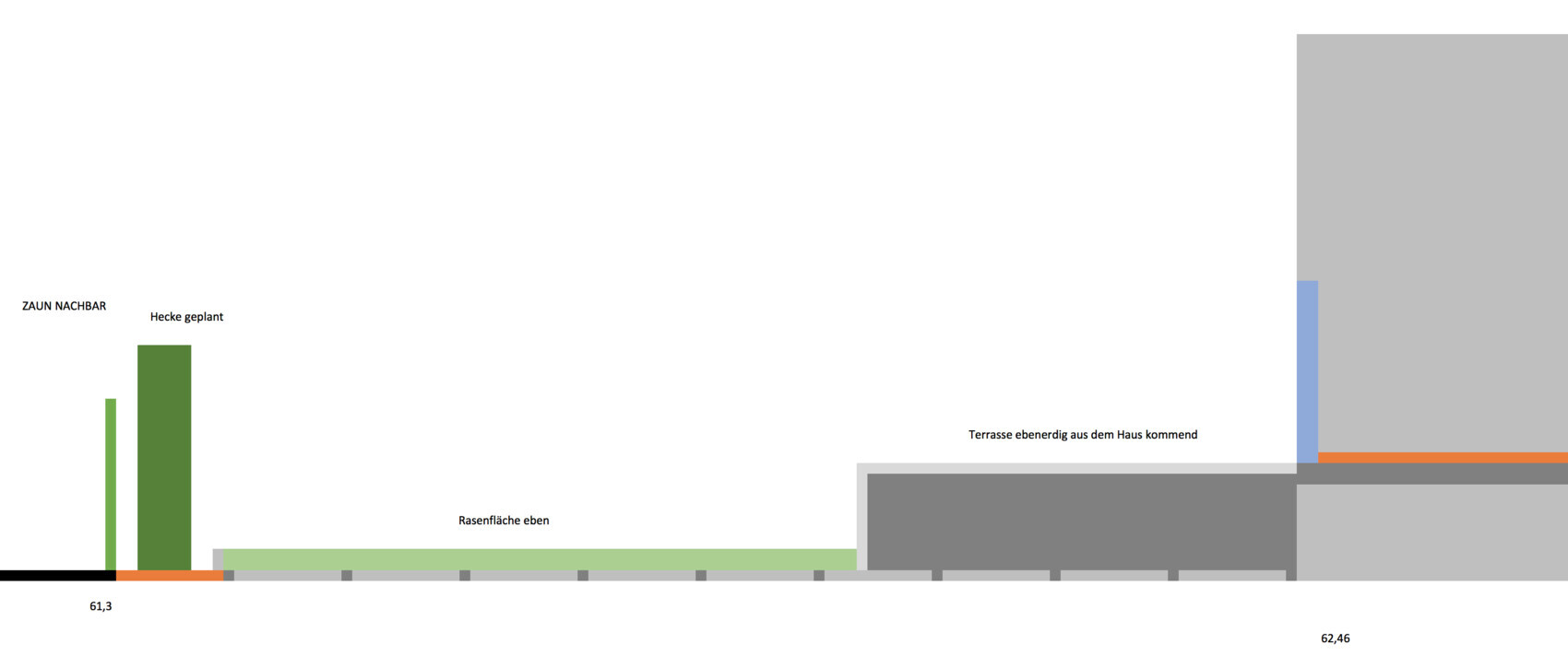

Henrik081712328 Jul 2017 15:18Attached is a rough sketch of the side section. Maybe this makes things a little clearer. As drawn, there are two things we don’t like, even though this solution probably wouldn’t bother the neighbor much:
1. About 80cm (31 inches) between the terrace and the lawn
2. This small ditch between the edge of the lawn and the fence, which somehow needs to be contained, with a hedge or something similar placed in the ditch.
As you have drawn it, that would be a good option. However, I would not use L-shaped blocks there, but rather set edge stones in mortar/dry mortar (basically what a landscaping contractor would use). This way, the neighbor won’t see a shabby wall, and the distance to the property line would also be ensured.
