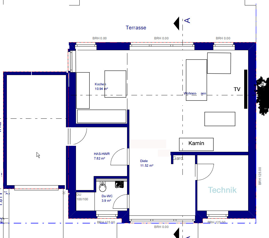

We have also been thinking about the current plan. I quickly made some changes using paint.net. Please don’t laugh—if it makes sense as we imagine, it would of course be discussed and implemented with the architect.
The office in the lower right would be replaced by the utility room for building services (gas boiler, buffer tank for solar thermal system, mechanical ventilation with heat recovery, about 8 m² (86 sq ft)). We feel that we already have enough rooms and don’t need an extra office. This way, there is still enough space in the laundry/utility room for groceries and our current small kitchen, where additional items can be stored. I made the hallway a bit smaller so that the building services room can be reduced in size and the living room slightly enlarged. I also spontaneously got a bit brave and reduced the size of the garage, adding a corner window so that the house should get sunlight already around midday… hopefully. The chimney would roughly run through the second child’s bedroom, which wouldn’t bother me (maybe the child, but you can’t have everything ). Of course, this was all done by me, an amateur. Whether the kitchen layout isn’t too small now is another question. I will need precise measurements from the architect to calculate that properly. Don’t be surprised that the staircase is missing—that will be handled by a professional.
Otherwise, I will happily discuss your drafts and opinions with my partner and get back to you later. Thanks again!

kaho67411 Jul 2017 11:15
Unfortunately, from a solar perspective, this is a disaster. The sun enters the living room from the left side of the plan. There, you have a tiny corner window. Otherwise, your garage blocks the sunlight from reaching the house. The other windows are on the north side—although quite large, there is no light coming through. The utility room no longer has any window at all. The chimney situation is also still unclear. Well, everything depends on the staircase.
You still have quite a bit to figure out.
