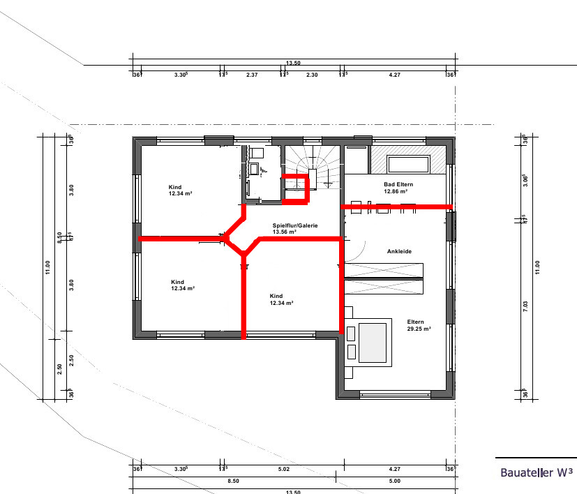

Well, this seems pretty stuck. I wonder if the kid’s shower could fit over the staircase. Then it might be worth considering something like that. The master bedroom would of course need to be rearranged – the bathroom would become a bit smaller. Just a sketch, I don’t have anything to draw with here.

kaho6746 Jul 2017 10:04
Accordingly, the staircase could be adjusted and this corner at the entrance could be removed.

arnonyme
6 Jul 2017 10:20
Hello kaho,
thank you very much for the suggestions. I didn’t expect anyone to come up with specific proposals again.
They are really great. As it is now, my wife wouldn’t agree because the bathroom would be too small (she wants to put a washing machine and dryer in there, for some reason…).
However, if I swap the bedroom and bathroom, it could work.
I have already applied for the door from the kitchen to the hallway.
