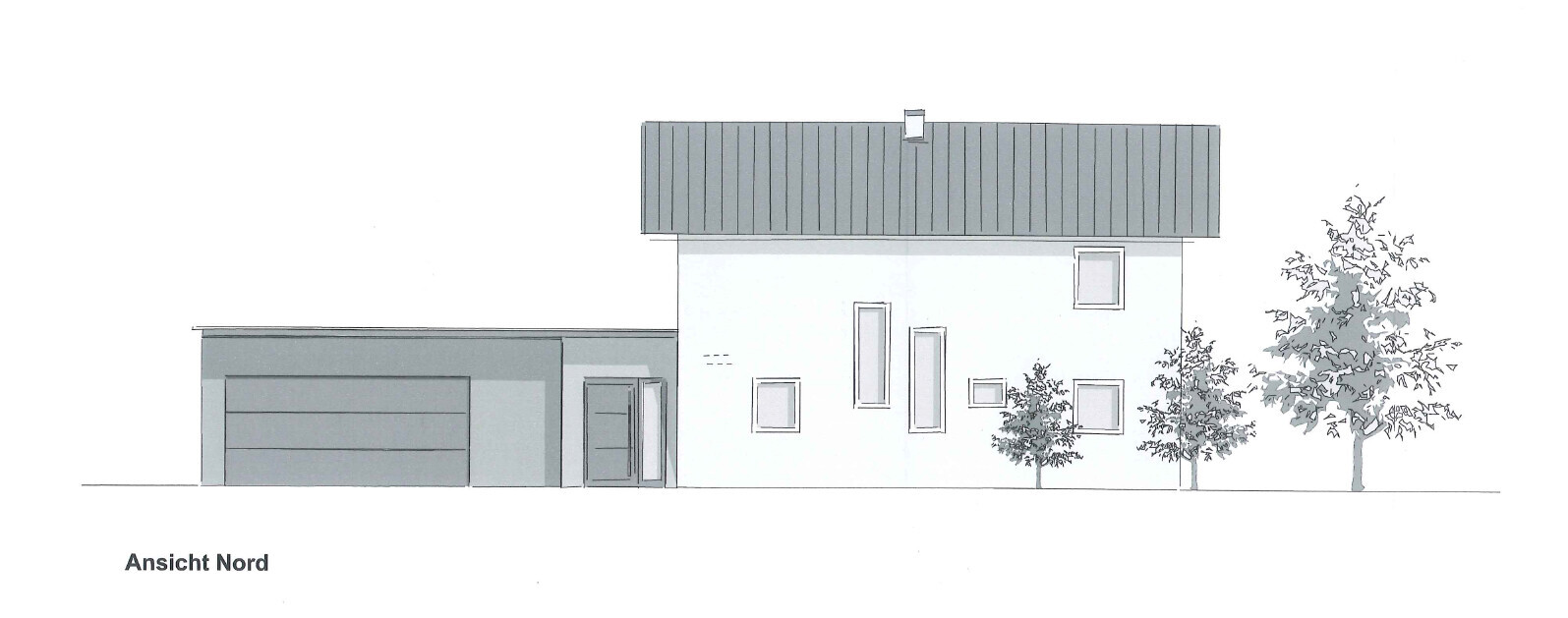

Here is the long-promised revised floor plan. The following changes have been made compared to the previous design:
Feel free to share your thoughts again.
- We are now allowed to build closer to the eastern boundary, which gives more space on the west side for the terrace away from the built-up shed on our property.
- Office is now located in the north, which fits better with the light well.
- Technical room is in the east, as the utility connections come in there, and the bathrooms are above.
- Door added from the entrance area to the garage.
- On the ground floor, the windows in the living/dining area were adjusted because we want the sofa along the interior wall.
- On the upper floor, the parents’ and child’s rooms were swapped.
- New bathroom layout.
- Garage no longer has a flat roof but a mono-pitched roof.
- A few other small changes.
I don’t like the north facade; the window arrangement feels too busy to me. The same goes for the south facade: I would change the patio door below the dressing room window—first, align it flush with the side, and second, make it the same height as the window above.
On the upper floor, the prefabricated chimney and the wall below the ridge beam stand next to each other. You interrupt the wall underneath for the chimney, which I find impractical, and this also means the wall above is not positioned “straight” over the one below.
Does a neighbor have a right of way, or where do the 4 meters (13 feet) next to the garage come from? By the way, I found the “old” boundary-parallel wall more appealing.
I’m not happy with the north facade; the window arrangement feels too chaotic to me. The same goes for the south facade: I would change the patio door below the dressing room window—first, align it flush on the side, and second, adjust it to be level with the upper window. Aligning it flush will still be done.
On the upper floor, the prefabricated chimney and the wall beneath the ridge beam are placed next to each other. Below, you interrupt the wall for the chimney—which I find inconvenient—and this means the lower wall is not positioned perfectly straight under the upper one. That’s true. As long as it is not a structural issue, I don’t mind much. Do you see any significant disadvantages with that?
Does a neighbor have a right of way, or where do the 4 meters next to the garage come from? By the way, I found the “old” wall parallel to the property boundary more charming. The development plan requires 6 meters. We received approval for 4 meters through a preliminary building inquiry, so we can, for example, add a parking space there. Yes, it will be possible, but the small change saved us about 3,000, which is why we decided on it.
