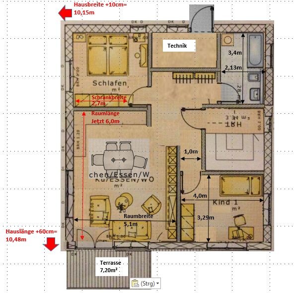

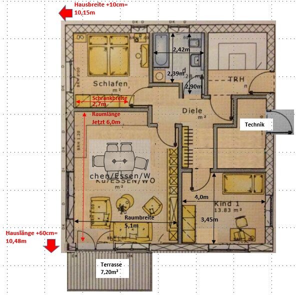

smartsurfer11 Aug 2016 22:37In the meantime, I have given some more thought to the bathroom. An apartment without a bathtub is definitely harder to rent out, as some people at least want the option to take a bath (winter, colds, etc.).
Therefore, I moved the walls again and created two versions.
In the first version, everything fits just barely into the bathroom.
Then I moved the walls further, which makes the bathroom a bit larger (assuming the technical installations still fit in the remaining space). However, this leaves no room for a door to the kitchen/dining/living area. (The children's room also becomes slightly smaller)
My question: What would you prefer? The door from the kitchen/living room (to keep odors from the rest of the apartment) in version 1, or the larger bathroom in version 2?

Let me raise this again: why three rooms? For three people, the space is really tight. Why not target singles or couples instead and focus on comfortable, well-furnished rooms? Keep in mind, even if Yvonne has shown you a possible furnishing layout, that doesn’t mean your potential tenants will have exactly the same furniture—and then it becomes problematic.
A 2.7m (9 feet) wardrobe is still not very generous (for me, it would be too small; you also need room for bedding, possibly summer blankets, towels, ski gear, winter coats, etc.).
Personally, I wouldn’t rent these apartments, not even as a single person.
It’s the same with larger rooms, a slightly more comfortable bathroom (because then it can be big enough to move around in), and enough space for additional storage—the situation would look different.

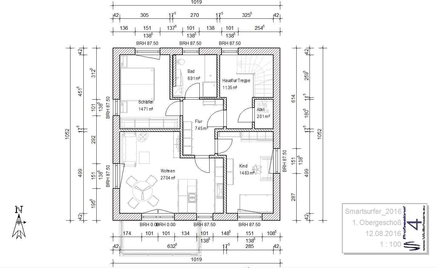

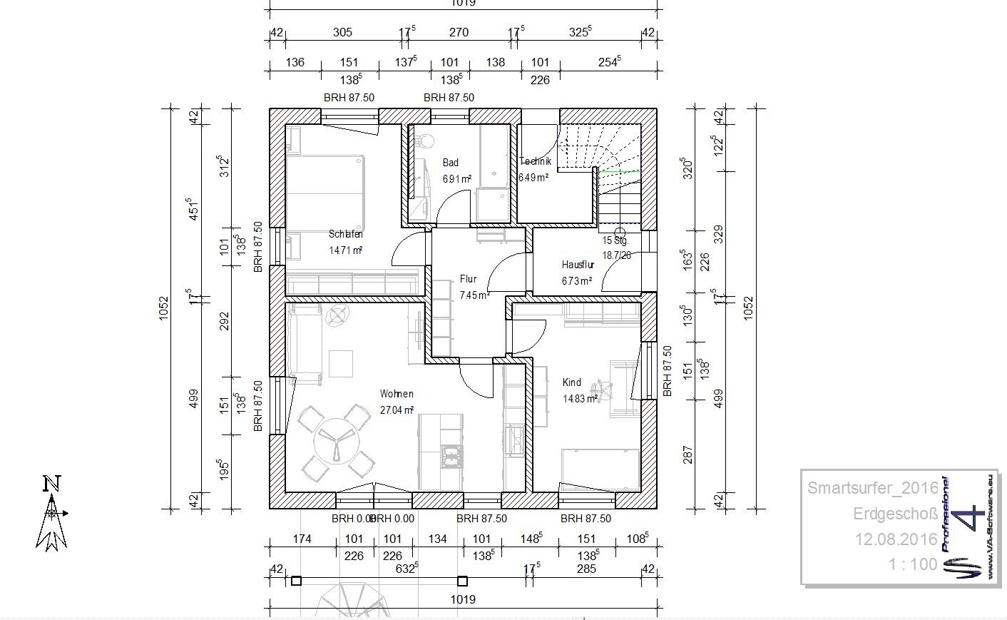

I finally took the plunge 😉 ... just under 71 sqm (765 sq ft). On the upper floor, there is an additional storage closet in the hallway.
The living/dining/kitchen area is now just over 27 sqm (290 sq ft), but in my opinion, it is easier to furnish.
In any case, the master bedroom can now accommodate a 350 cm (11 ft 6 in) wardrobe. In the hallway, there is space for a 200 cm (6 ft 7 in) wardrobe (vacuum cleaner/ironing board/mop and other items) and an open coat rack at the entrance.
The bathroom has both a bathtub and a shower, with the washing machine placed right at the bathroom entrance under a continuous countertop.
Unfortunately, @smartsurfer, you don’t mention what your main target group is.
