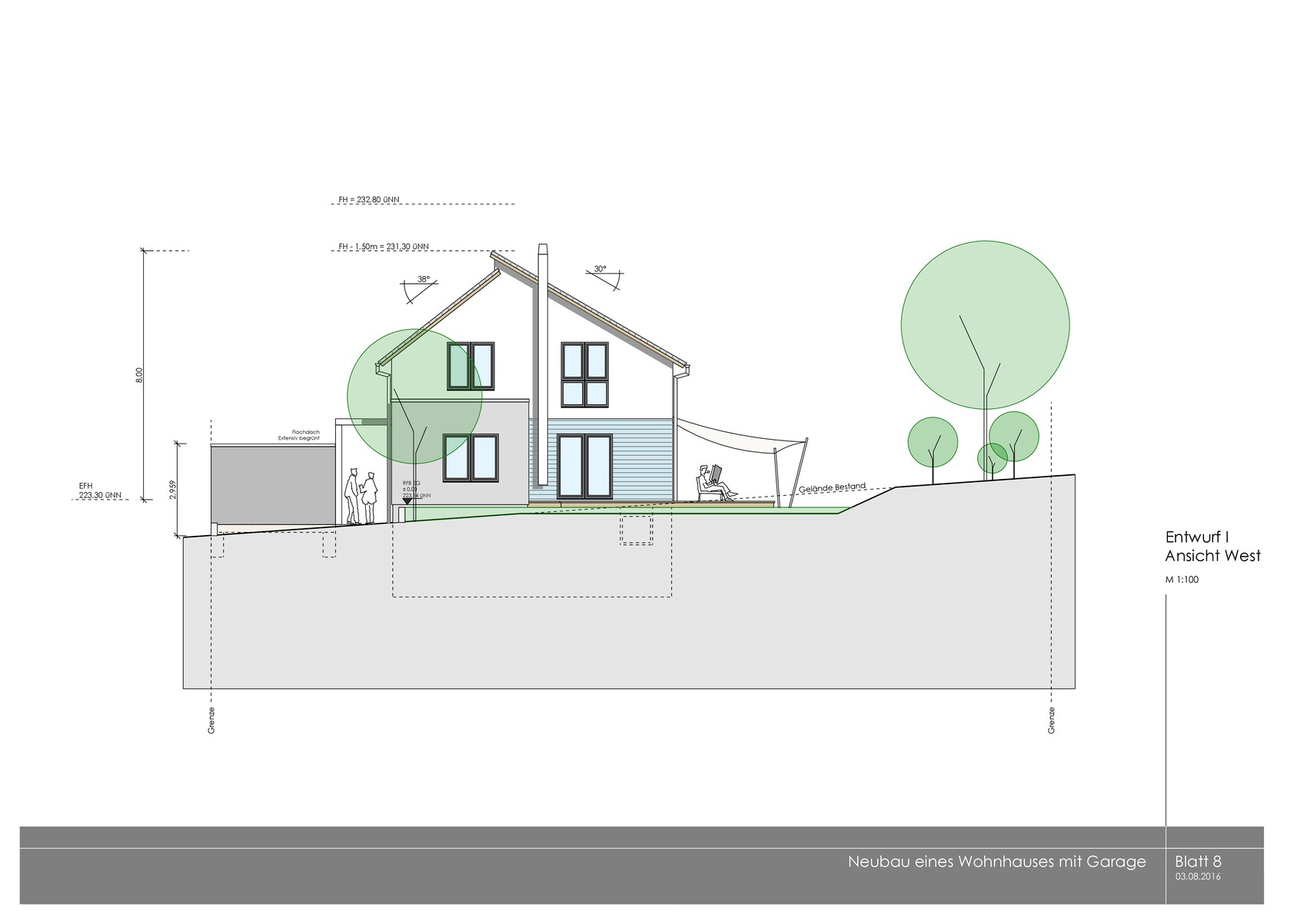

skybiker20008 Aug 2016 15:15Hello everyone,
thank you for your feedback!
We now have solid plans that we are currently refining with our architect. We have incorporated your suggestions and comments.
I would appreciate it if you could also take a look at the latest plans. That would definitely help us a lot. We have a goal in mind now but are still open to inspiration from your feedback!

Spacious layout .. and regarding the shower, I see that less as an issue, but I would rotate the toilet in the upstairs bathroom by 90°. Also, choose a lower window sill for the east-facing window towards the street in the study.
If the kitchen is not intended to be like the one shown, I would start planning it now and possibly add a patio door on the south-facing side.
Also, check whether the fireplace should really be placed as planned. I could also imagine it in the lower right corner of the living room. This would allow a view from the sofa and keep the heat source a reasonable distance from the dining table.
skybiker200011 Aug 2016 15:03Thank you all for your feedback!
I’ll keep the shower topic in mind. Our architect has planned a “privacy wall” in front of the toilet. We actually quite like the idea, but it still needs some refinement. We will adjust the window in the office—that’s really a good suggestion.
In our first draft, there was an exit to the terrace through the kitchen. At the moment, my wife prefers a U-shaped kitchen, but that is not finalized yet. I’ll pass on your comment about the chimney to our architect.
I still have a few questions.
Currently, we have planned roof pitches of 30° and 38°, but there is still the option to change them. According to the development plan, any pitch between 20° and 45° is allowed. From your perspective, would it make sense to change the roof pitches, for example to 25° and 33°, in order to raise the knee wall? Technically, this is no problem. Would this negatively affect the overall appearance of the building? When I walk through new housing areas, I often see relatively shallow roofs.
The clear ceiling height on the ground and upper floors is 2.51 m (8 ft 3 in). In the basement, it is 2.39 m (7 ft 10 in). Is this sufficient? We have planned a home office and a hobby room in the basement.
Do you have any opinions on roof windows? I am not entirely sure if the rooms upstairs will be bright enough. On the other hand, the windows are already 1.53 m (5 ft) wide.
Thank you very much for your answers!
