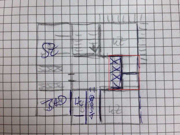

Here I did a rough sketch with a really blunt pencil...
About the “everything a bit more expensive” point... I can’t say much yet. The gap between wishes and reality is certainly quite wide for a layperson, and you quickly come back down to earth in the first discussions. As Oliver already mentioned above, the size definitely needs to be reduced.
I’m really impressed by your “handmade quick sketches” — thanks a lot for that.
I had to think about it a bit, but I find the layout really well thought out. On the ground floor, the kitchen as well as the dining and living area are the heart of the whole thing. The stairwell with a possibly bright, daylight-flooded area for the view to the east. On the upper floor, the master bedroom also faces east with everything you need. The children’s rooms are positioned toward the southeast and southwest. I really like that, too.
Is there an open void or gallery space between the children’s rooms, or is it fully enclosed with the rooms simply wrapping around the corner?
Sketch layout of a house with bathroom, WC, rooms and stairs
Best regards, Andi
Jochen10410 Aug 2016 20:15
As far as I know Yvonne, the rooms there are around the corner, and there are still cabinets in the hallway.
10 Aug 2016 20:28
Jochen104 schrieb:
Knowing Yvonne, the rooms probably wrap around the corner there, and there are still closets in the hallway.
I had the photo with the open space from you, @Häuslebau3r, on my phone. It would have fit well there! However, sound traveling upwards would likely disturb both privacy and sleep, whether from below or above. That way, you can integrate the workspaces with a window front and have built-in closets in the hallway.
However, when I see a budget of 300,000, it might be necessary to reduce about one square meter (10.8 square feet) around the exterior walls and compress the design. Mine is naturally somewhat oversized for a sketch. Then it will probably be dropped.

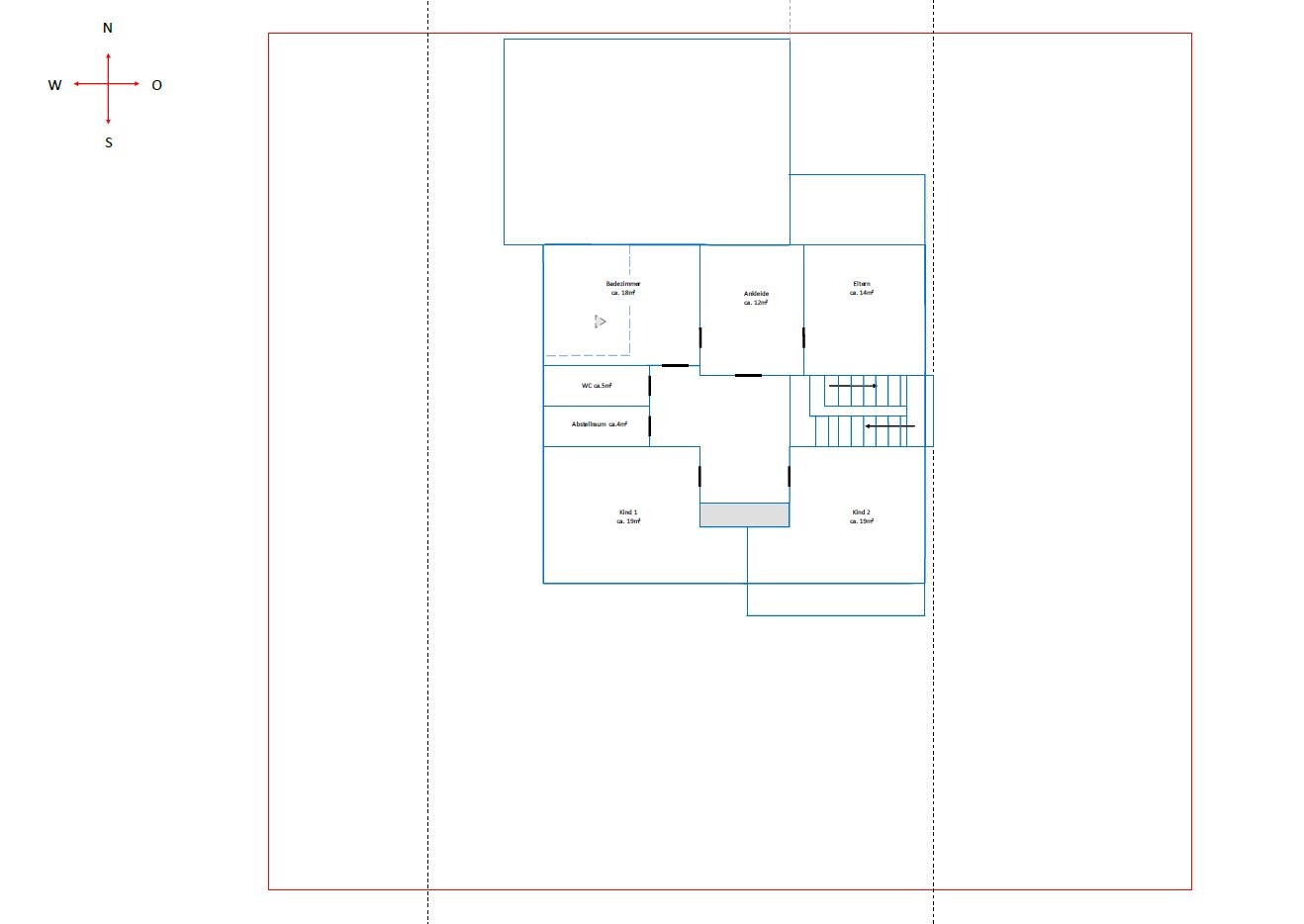

I showed the draft to my wife yesterday, and we both actually liked it right away. Today, I tried to put it down on paper a bit more clearly with ground floor and upper floor plans. Of course, as you can probably see, the square meter (m²) figures are not really accurate yet; the main focus is on the layout and a possible arrangement. The house should ultimately be about 170m² (about 1,830 sq ft), excluding the basement.
I have now created two more versions for myself: one with a pantry, which I wasn’t quite sure where to place, and another with an additional toilet on the upper floor.
Floor plan of a house: kitchen, dining area, living room, utility rooms, and outdoor area with brown decking.
Floor plan of a house with master and children’s bedrooms, bathroom, dressing room, storage room, and staircase.
Floor plan of a house with double garage, living area, kitchen, office, utility room, and terrace.
Floor plan of a house with bathroom, toilet, storage room, dressing room, master and children’s bedrooms.
I really like your design’s layout, as the kitchen, living, and dining areas are nicely centered and oriented towards the west and south. The living area also extends somewhat towards the east, and the staircase could replace the gallery with a nice view from above.
The gallery’s issues regarding odors and noise have already been discussed frequently in the forum. Ultimately, I think it’s probably a matter of budget—whether you can afford this feature in a house that is naturally designed for it. In our case, to the south, you would look towards the neighboring garage’s side wall and the garden. So, the view is less important but possibly the spatial effect, like in this example.

Jochen10411 Aug 2016 12:01
Who is Oliver? I was already wondering that in the last post.
The floor plan is coming together gradually. A few more notes:
  • The ground floor is the same, right?
  • I would suggest accessing the bedroom either through the walk-in closet or the hallway, not both.
  • The bathroom on the upper floor can only be reached through the walk-in closet. Where do your children shower or bathe?
  • The storage room, upstairs toilet, and pantry are quite narrow.
RobsonMKK11 Aug 2016 12:07
So, you won’t be able to do anything with the pantry at all. If I’m reading this correctly, it’s somewhere between 80 and 100 cm (31 and 39 inches). If you put a shelf inside, no one will be able to get through anymore. And the “bend” isn’t very helpful either.
